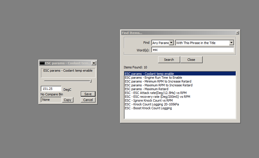

It's getting continual knock. I'd check for something like a loose alternator bracket or something like that that is giving a false signal. I'll still spend some more time looking.
Re: Can someone check my VN V6 supercharged tune
The continuous false knock is pretty typical for these, especially when the engine has high Ks or extractors. I just disable it by maxing the enable temp for it.

vlad01 wrote:The continuous false knock is pretty typical for these, especially when the engine has high Ks or extractors. I just disable it by maxing the enable temp for it.
It does have extractors and is in a tight Gemini engine bay.
The alternator has new brushes and is secured well.
Engine only has around 100k on it.
The S14 supercharger is very loud on it.
I'm pretty sure the knock is disabled in the Delco but not completely sure.
It is throwing a knock sensor code.
Thanks
This is the setting to disable it. Sounds like the sensor is faulty or the wiring is broken somewhere, but just disable it as the knock retard system on the delco is pretty much useless anyway.
Excellent, thank you.
Il make that change.
