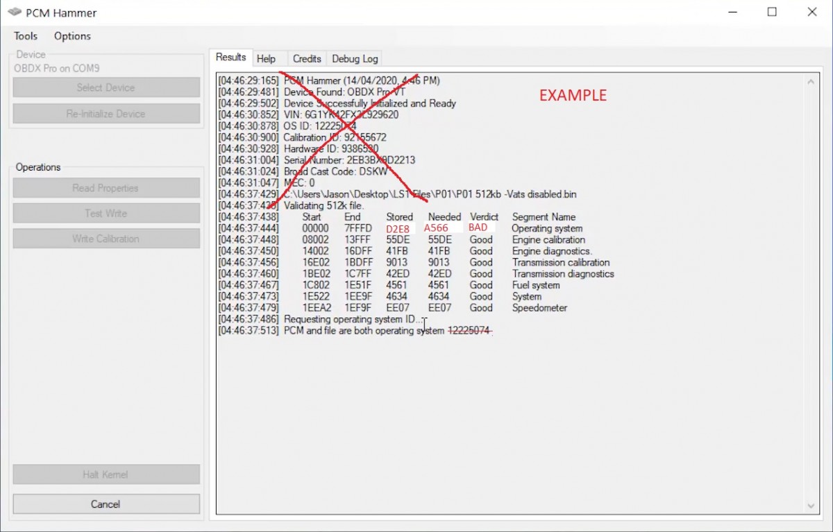

After modifying saving and trying to write PCMHammer says that there is bad OS segment (The very first line after choosing modded bin)
The picture is an example. It's not my screenshot.
12587603+AC.xdf allows to change OS checksum value manually, but I think this is not the right way.
How to solve the problem?

2 ways
1) If you are not editing adding a code patch, remove the os checksum calculator completely, as that segment wont change for normal tuning.
2) Set up the XDF like this, and select the working plugin.
p59 os checksum config.png (79.01 KiB) Viewed 4839 times

Antus, thank you VERY MUCH!
I just tried second way. It works!!!
Today I wasted 7 hours sitting in a car and trying to make a correct file and flash the pcm. And it was just kicking my butt :)
