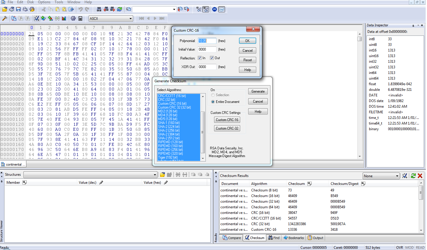

So I thought without any responses maybe it's too hard to do checksums without knowing more about it, but thought I'd keep looking anyway.
So in Hex Workshop it doesn't show anything like what is supposed to be the checksum, in attached screenshot the CKS should be B24D which is at $00D4 & $00D5 again but do you include that or exclude(I've tried both ways & still doesn't add up) so I thought it must be a custom CRC16 & just tried different values in each of the box but really don't know what I'm testing... is there a general of each of the boxes thats common for most sums?

Well, those bytes do look to be an 8-bit checksum, as they're a one's complement of each other.
Joe.
