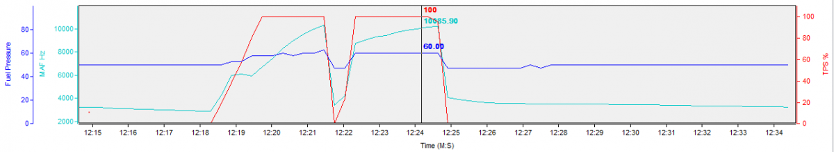

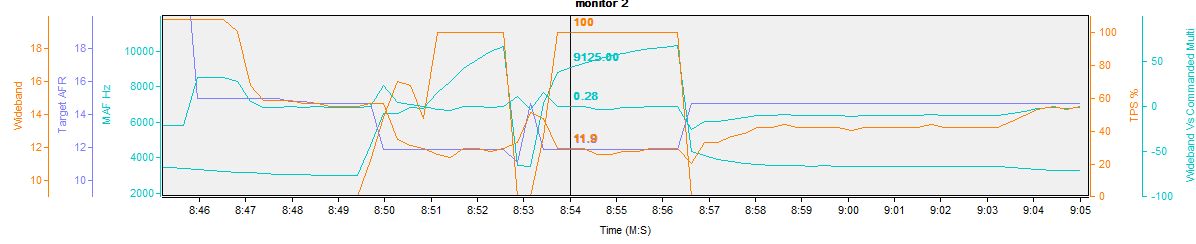

The below picture is using the injector mon line to log the wideband. Below picture is logging fuel pressure, not sure if it was on the injector mon line or EGR. I think it was the injector mon Below picture is logging boost. I'm sure this is the EGR and you can see the graph is not as smooth as the above two. I cant seem to find the picture of logging water temp, played around with it years back but only recently got it installed and running.
To get it all working you will need to edit Tuner Pro and enter the calculation, working these out can be tricky but if you post all the info you have some people on here will like be able to help out.
