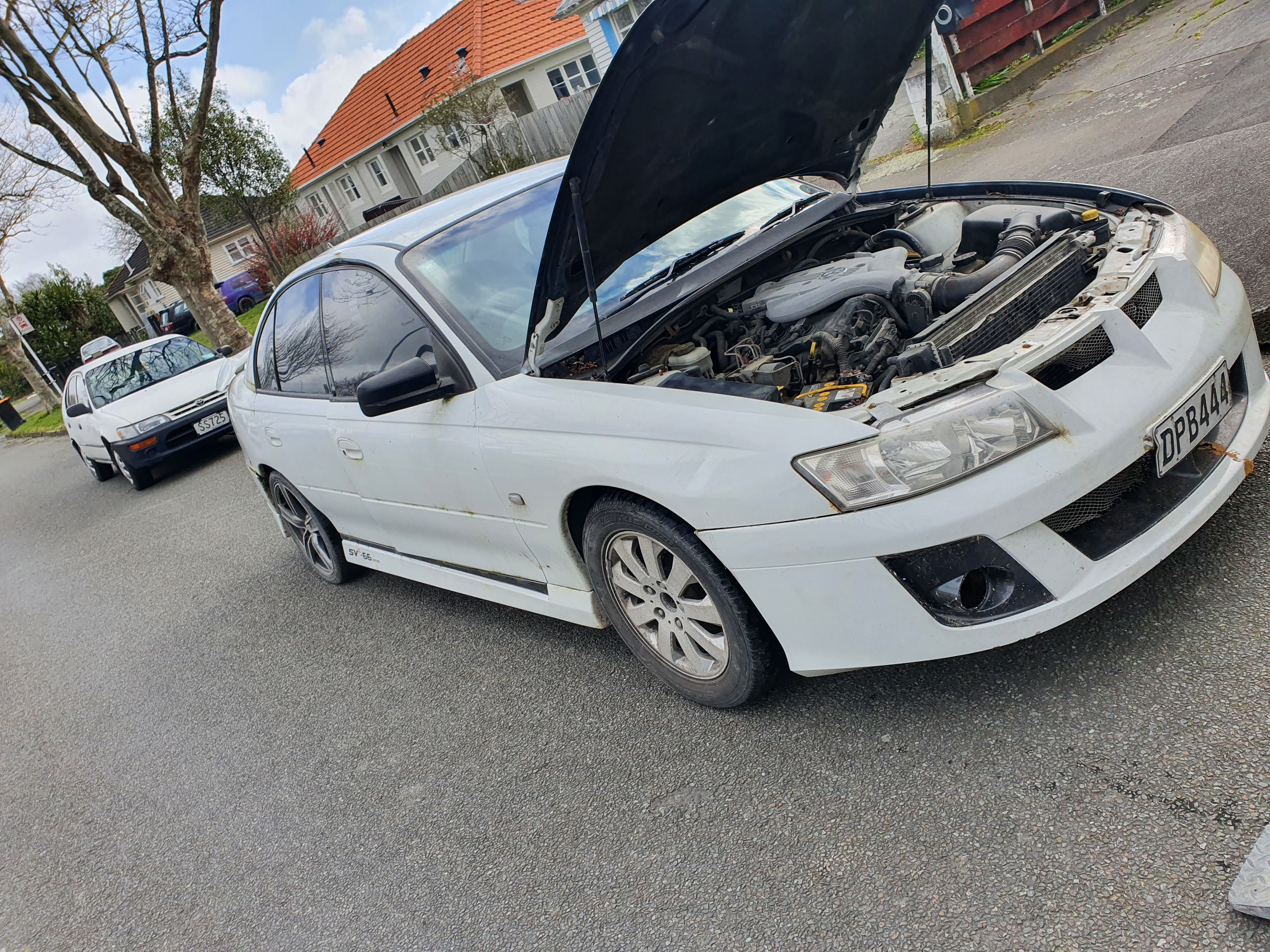

Purchased a dirty old VZ V6 with a LS1 conversion from a guy in Auckland who never got it running afterwards ( wouldn't accelerate and intermittent start. It was a mess, broken windscreen, mismatched wheels, homejob paint... and that was just on face value. Once i got her back home to Palmerston north, I realized there was more wrong than anticipated! However a few pics
After she got back it was time to go over it. Found threaded wheel studs, a cracked front subframe, a binding handbrake shoe.... So took it in my stride and decided to strip out all the interior ( which was probably the nicest thing about it)

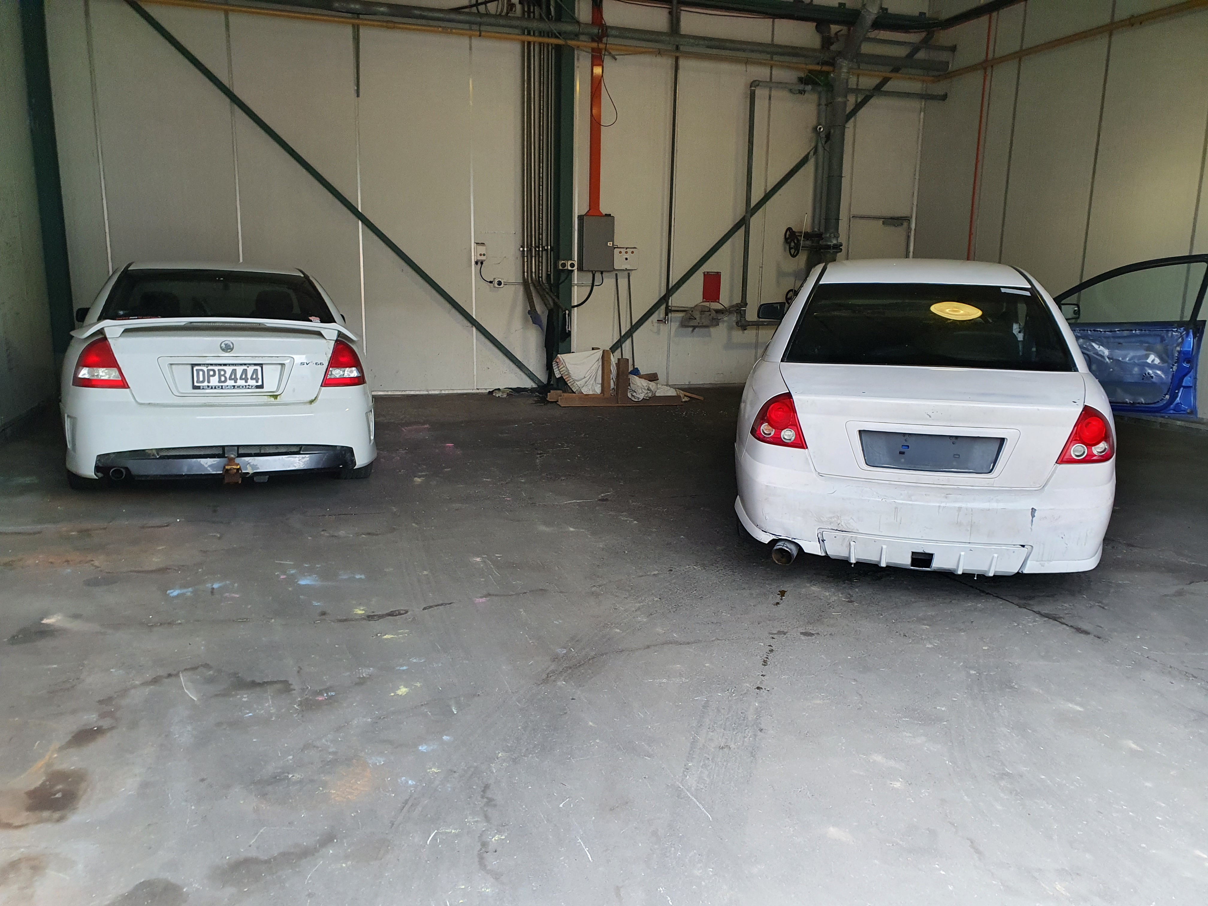

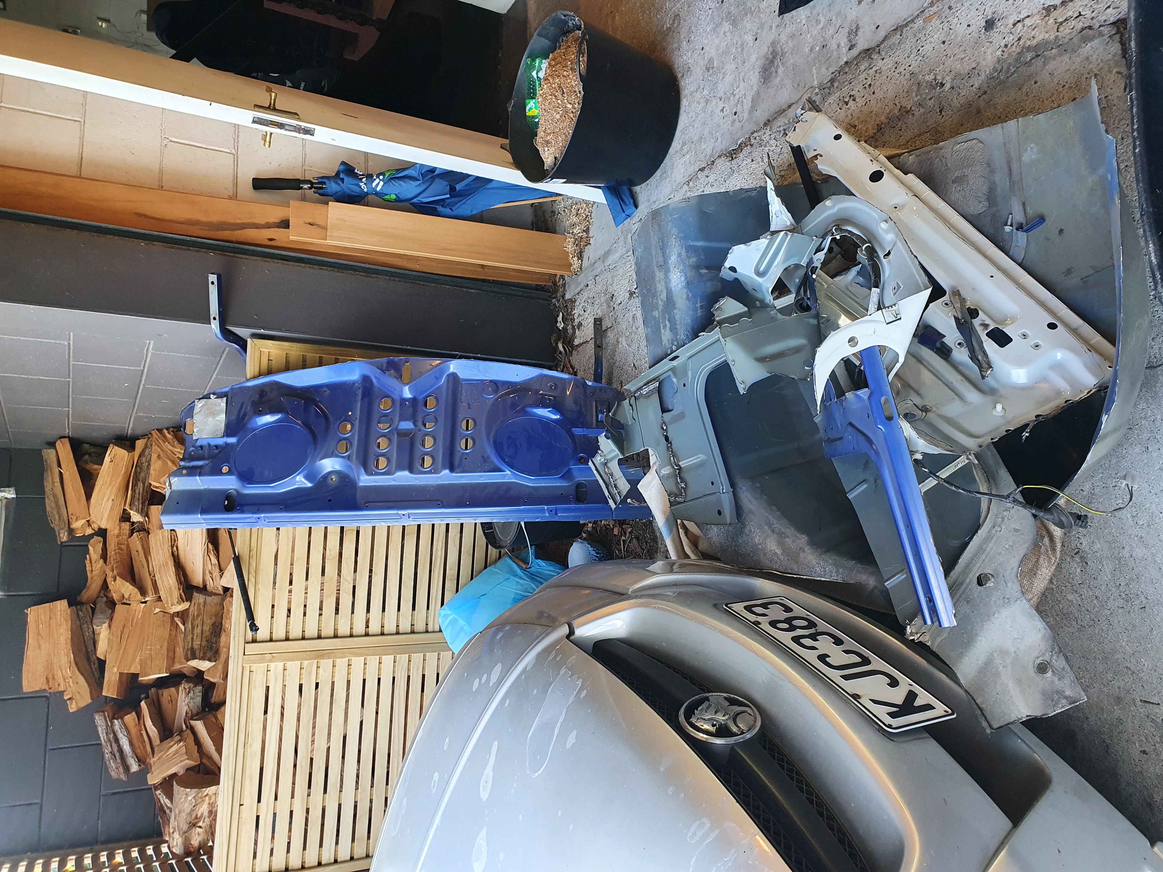

Because the panels were a bit rough, and bumper was torn, i found a guy selling a dereg VZ V6 for $450 that had been rusting away in a paddock for god knows how long, however it did have clubsport rep bumpers in fibreglass ( Ex SV66 kit which is just some fancy kit one of the on sellers here started putting on standard commodores and flicking them off for a few more k) so i could use those. The bonus was, the engine still ran....
So took it back to my newly leased "workshop" so the wife didnt know what things i had brought...

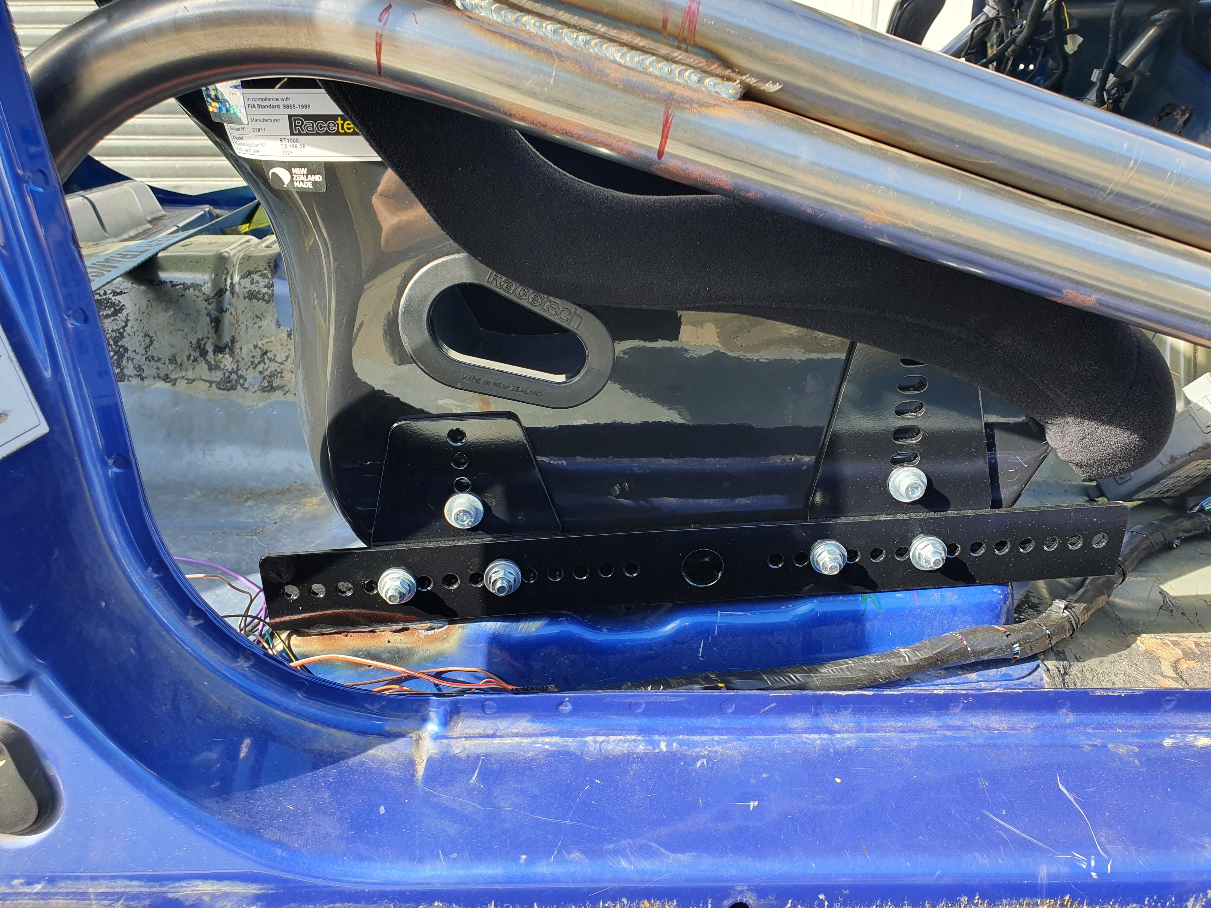

My original seats i was going to run were Jamex, however, were to high for the car with cage in, so i went and brought a brand-new Racetech RT1000 and got Nick to make up some custom brackets. Was starting to come along nicely. Once all done, it was picked up and brought back to the workshop

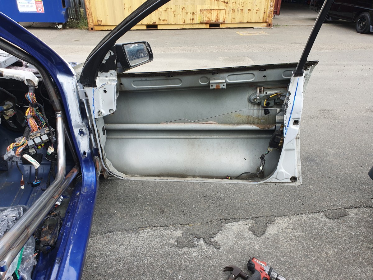

Whilst at the workshop, i started ripping out as much weight as possible, drilled all the spot welds out of the rear seat butt cushion thing and pulled that out, managed to cut out a heap of steel from doors, remove glass ( to be netted for front and polycarbonate for rears and back windscreen ) door started at 26kg, everything removed it was 16kg. Still have aluminum door cards to add, but that weights next to nothing. So rear doors weight about 22kg and get down to 12kg. So an easy 40kg reduction there

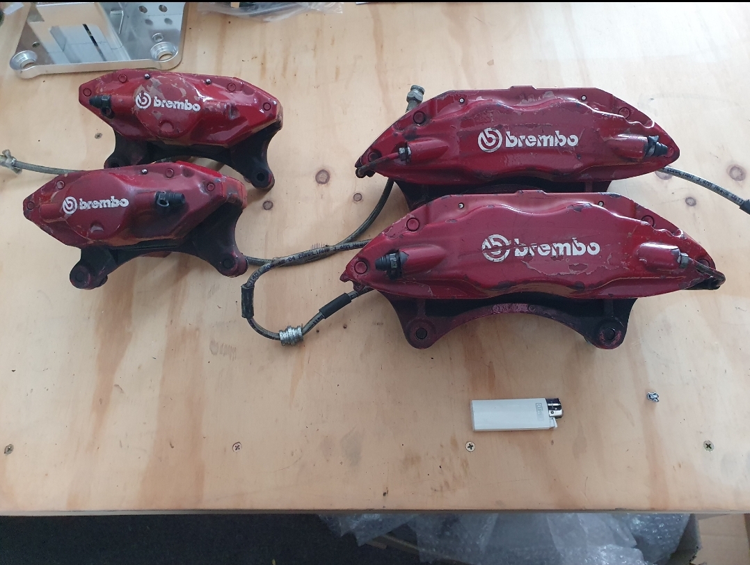

I Put a post up on RCIS FB page that i was after a set of Evo 7-9 Brembo brakes, two weeks later, after a failed auction on yahoo.jp somebody got a hold of me and had some. So purchased a Fronts and Rears from a Evo 9 for around $800, I later got some brackets made up to bolt them up to car (Copy of my racing buddy who runs the same on his VX)

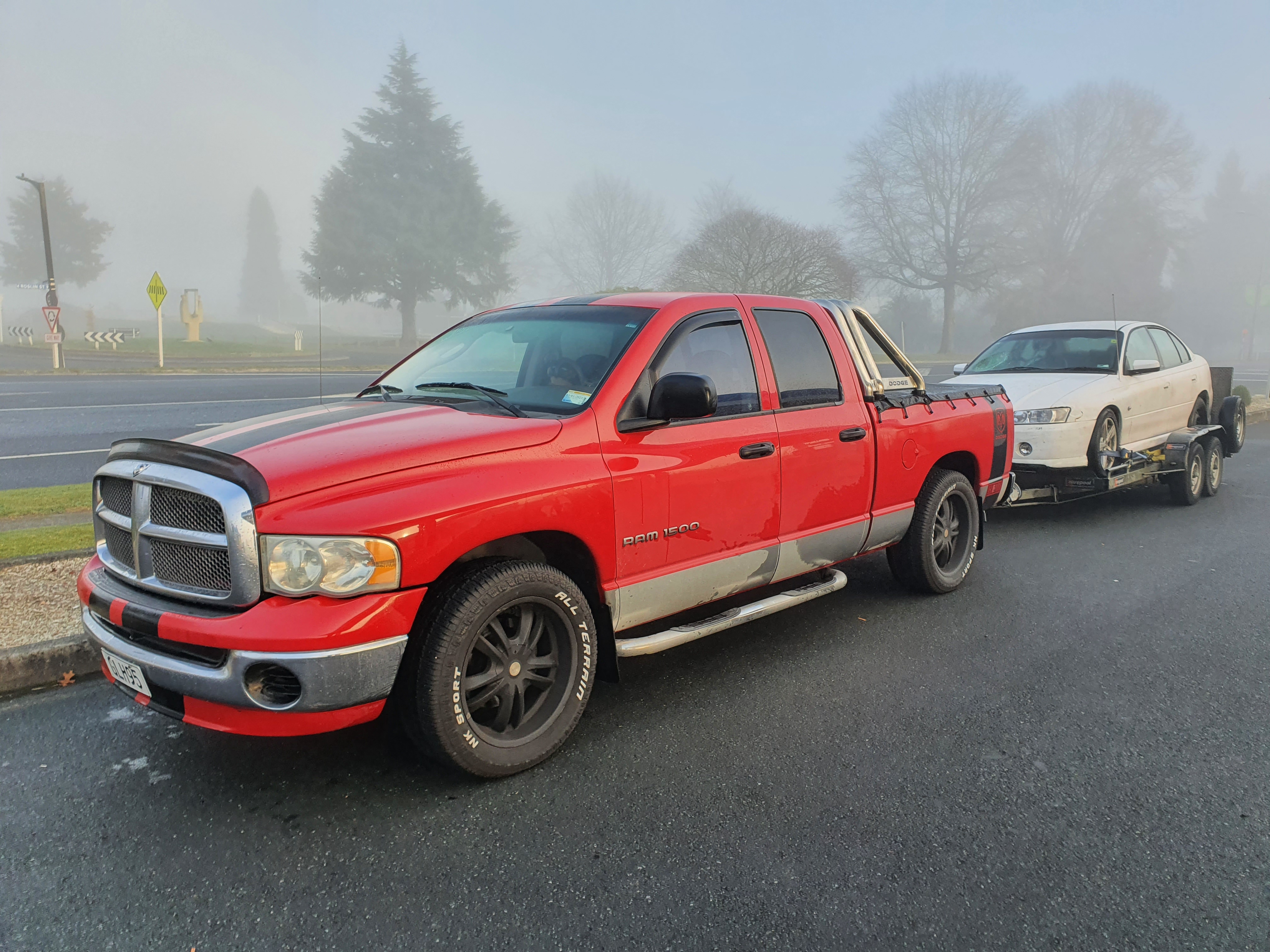

In the meantime, I stripped the white VZ parts car i brought, and pulled the motor which was a good runner. I then came across a silver VZ wagon, that had been in for a service and 100km later, jumped a tooth and dropped a chain. I thought "Hey i have a spare motor here, ill just re-motor it".
And just like that, again without my wifes permission i went and purchased this Wagon to transplant the engine into and sell to pay for more racecar parts..... So i thought...

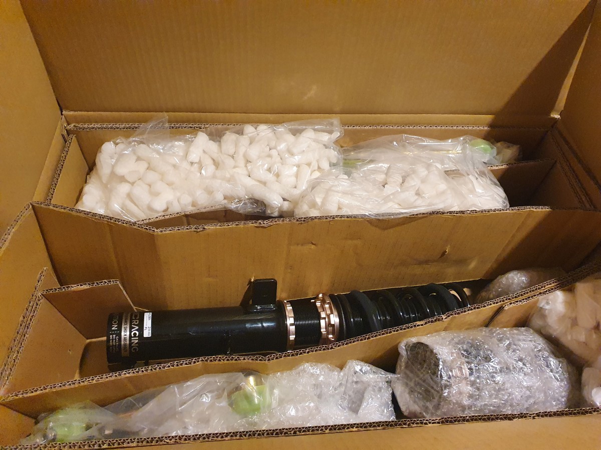

Anyhow, We got up there and had planned to have our friends from Auckland come stay for a few days, I had also seen some new adjustable suspension on facebook that was also in Auckland. So i sneakly asked our friends if they wouldnt mind bringing me down and important package that i had been aiming to pick up for weeks, and of course, they agreed, So i Brought the suspension and got the guy to drop it to them Haha. I knew my wife was going to kill me, but the way i see it, Its easier to ask for forgiveness then it is for perimission... Or so my other racing friends told me....

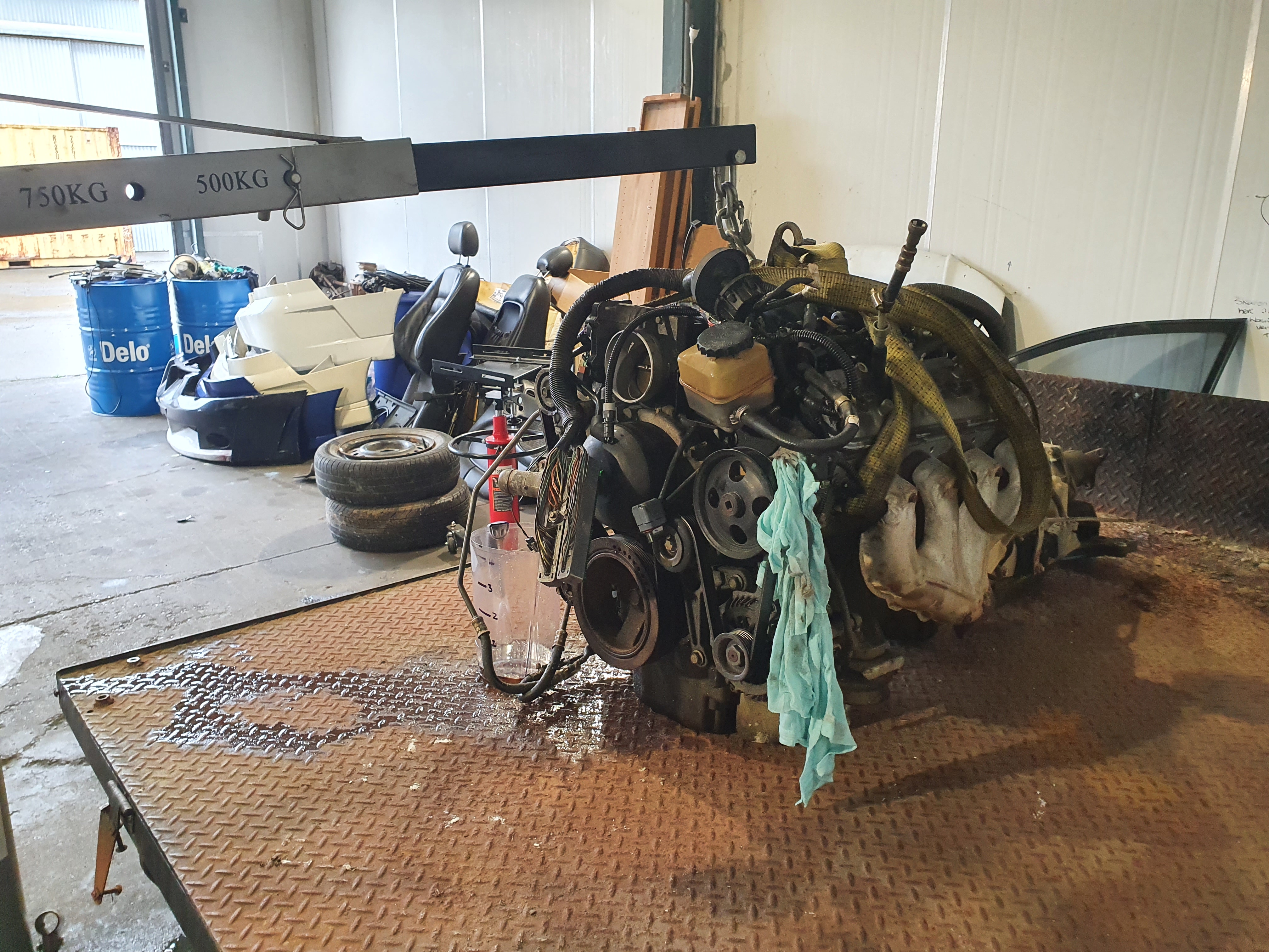

So down she brought my box in the back of her Suzuki Swift. Not a big car at all! Well came time to strip the car for paint and a bit of fabrication work, so motor pulled out.
Once i did the swap, it was actually quite useful, so i started using it more often, and decided to sell one of my other run abouts instead!

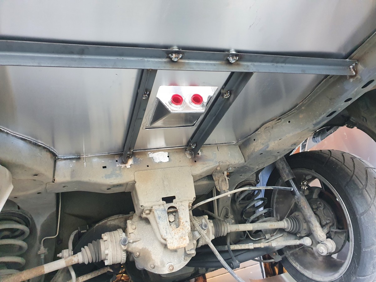

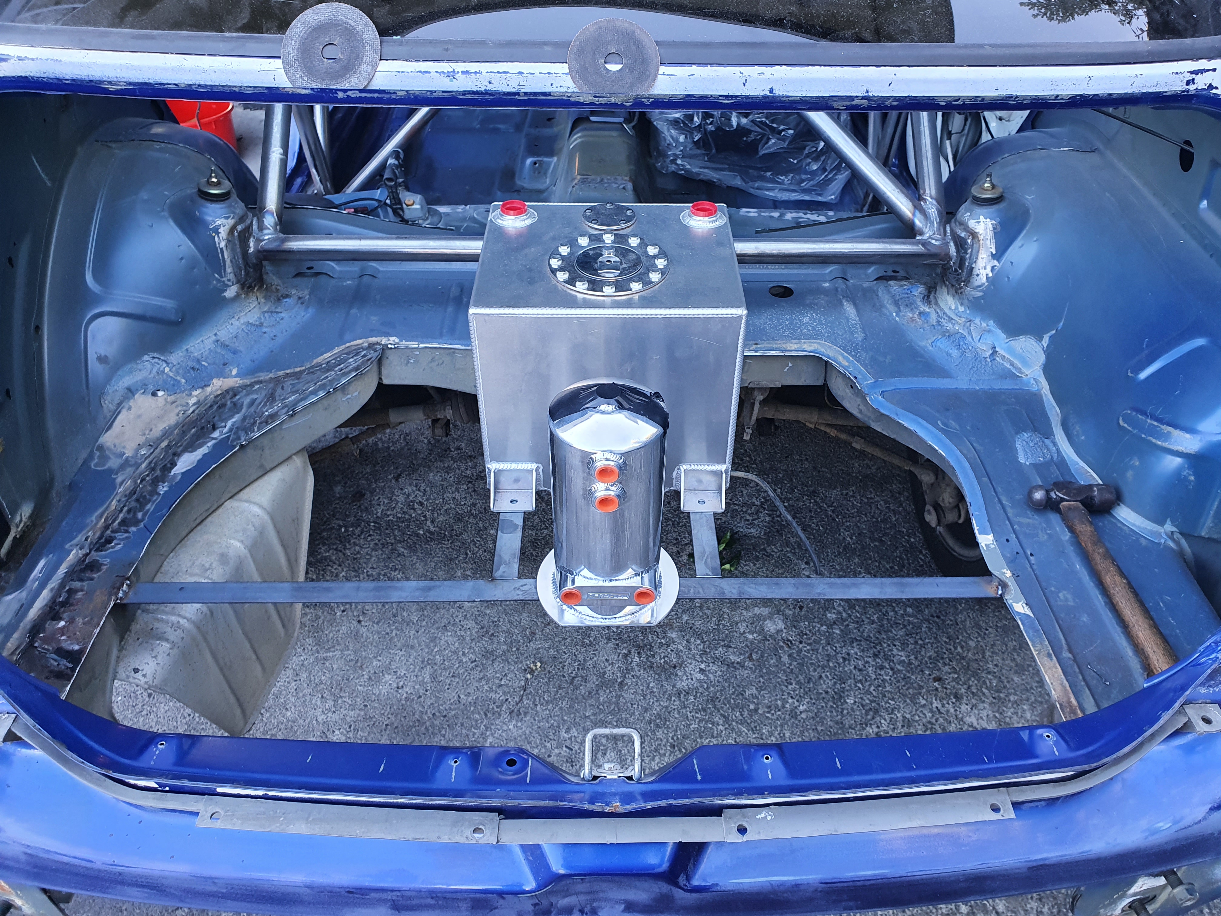

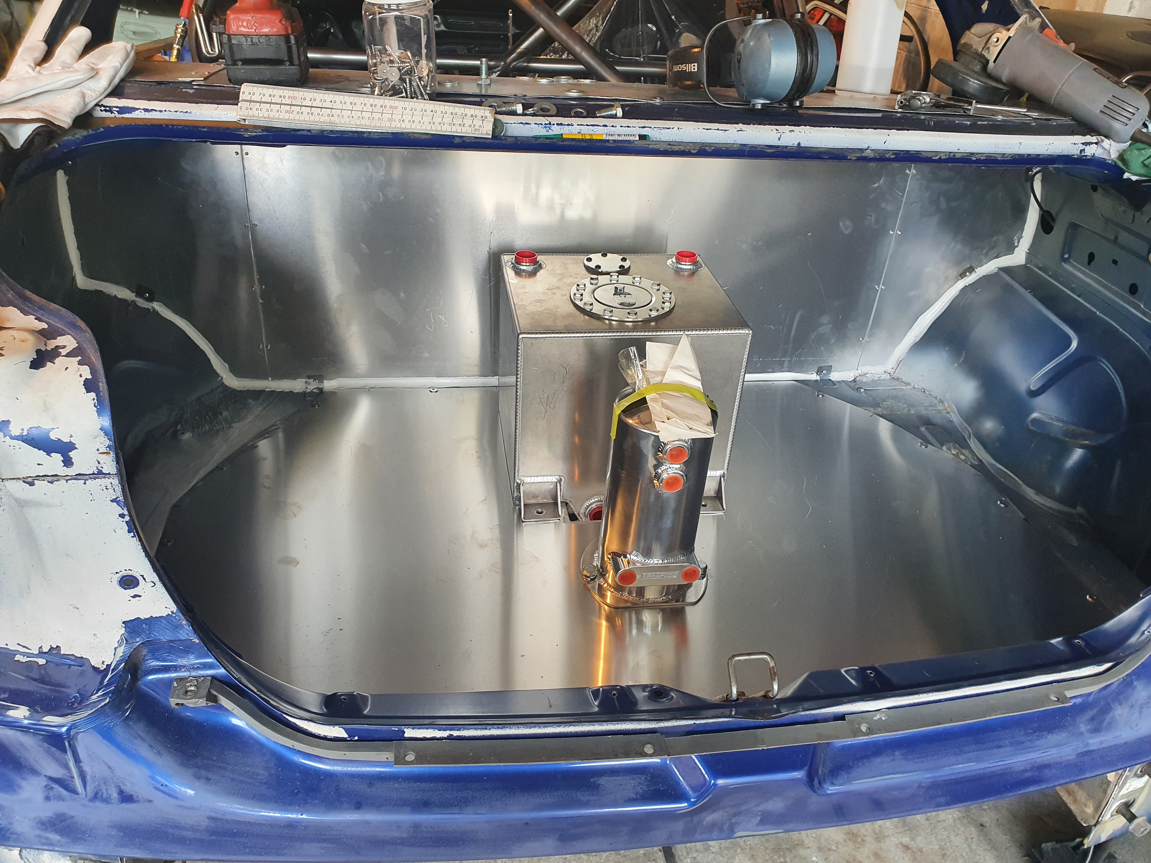

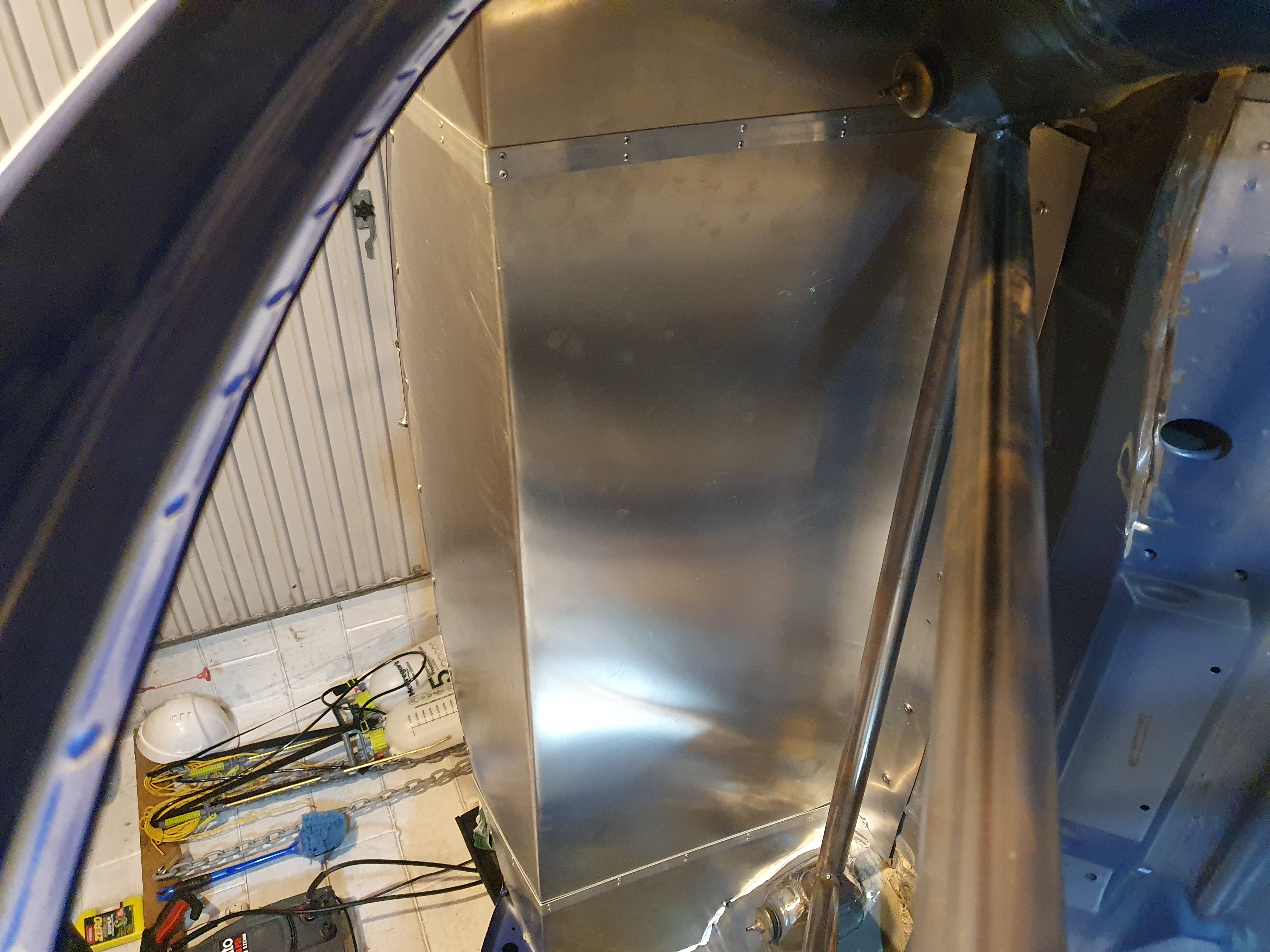

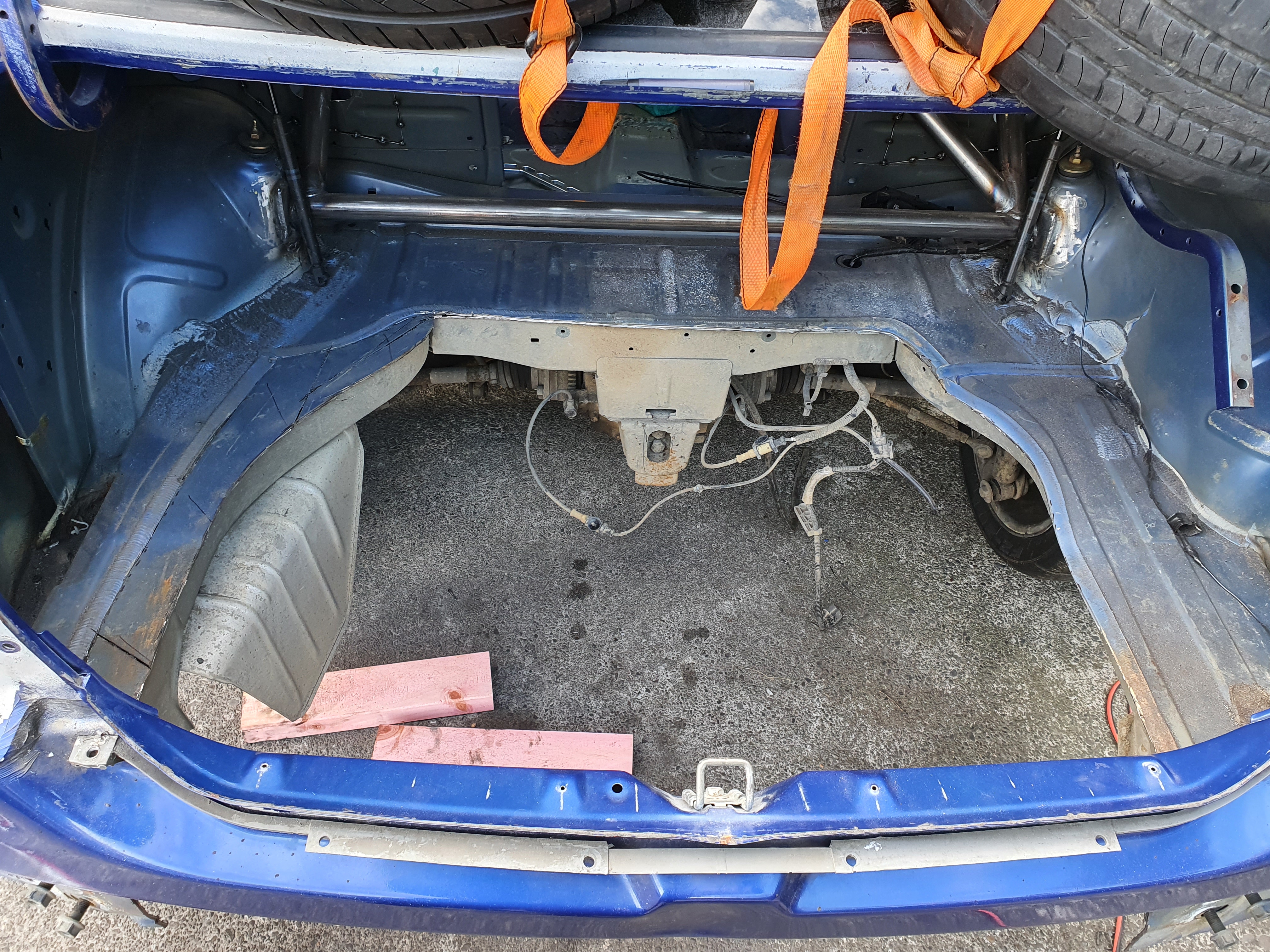

Decided to get rid of the fuel tank and run a external fuel cell and surge tank.
So cut the entire spare wheel well out and made some braces to bolt the tank and surge to aswell as bolt the new aluminum replacement floor.

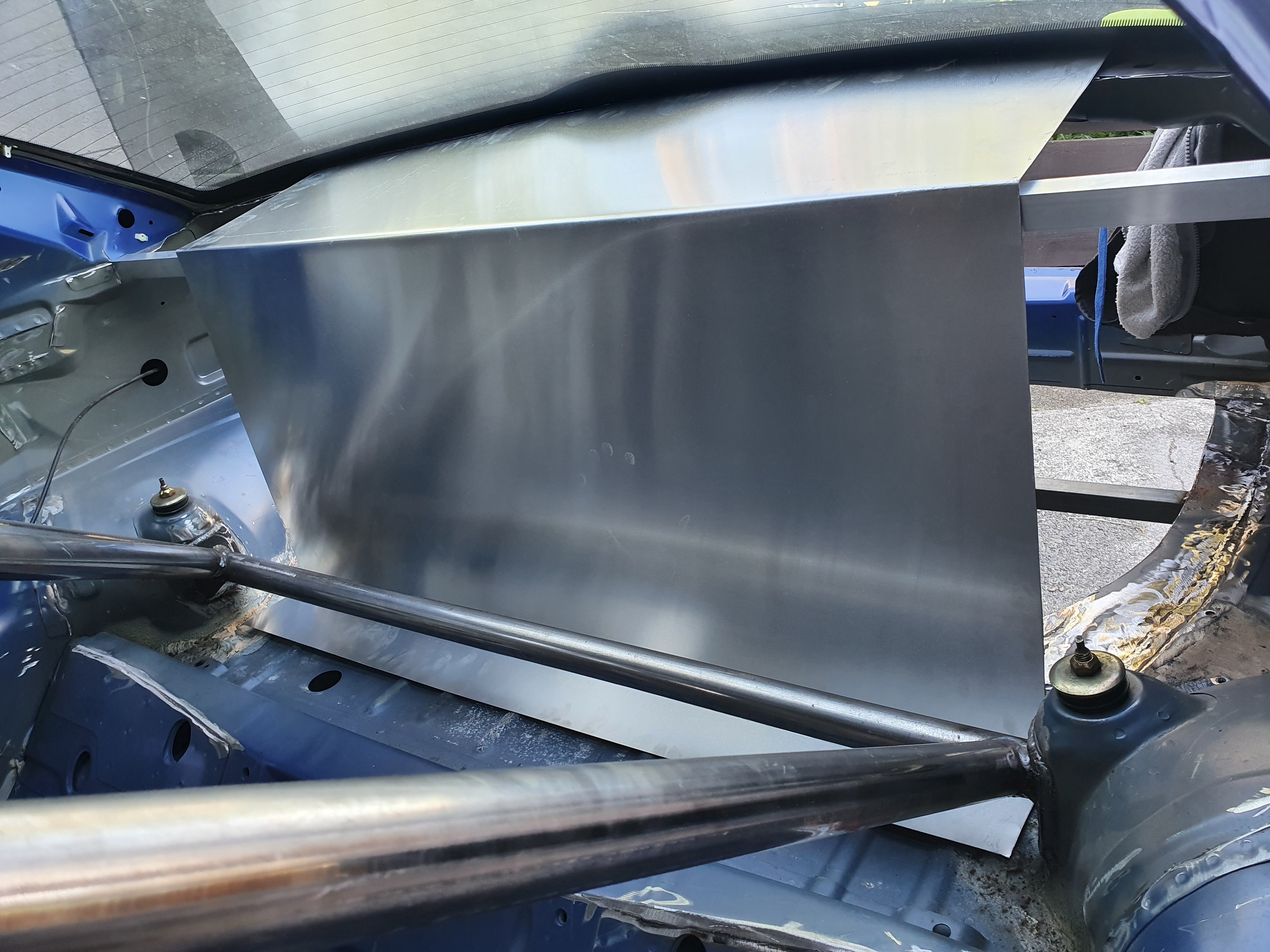

At the same time i decided to cut the rear divider panel out between passenger compartment and boot. Move it back a foot or so to keep the suspension inside the cockpit, makes adjusting the shocks a bit easier. New divider wall bent up ( made a sheet metal bender to help with all the bending i had to do with the left over 3mm angle i used for bracing)
Almost done, just ordering fittings and pumps this week.

I ended up cutting the rear screen as it was going to be to difficult to try screw them divider panel to the windscreen panel, and to rivet the sheet metal but join capping.

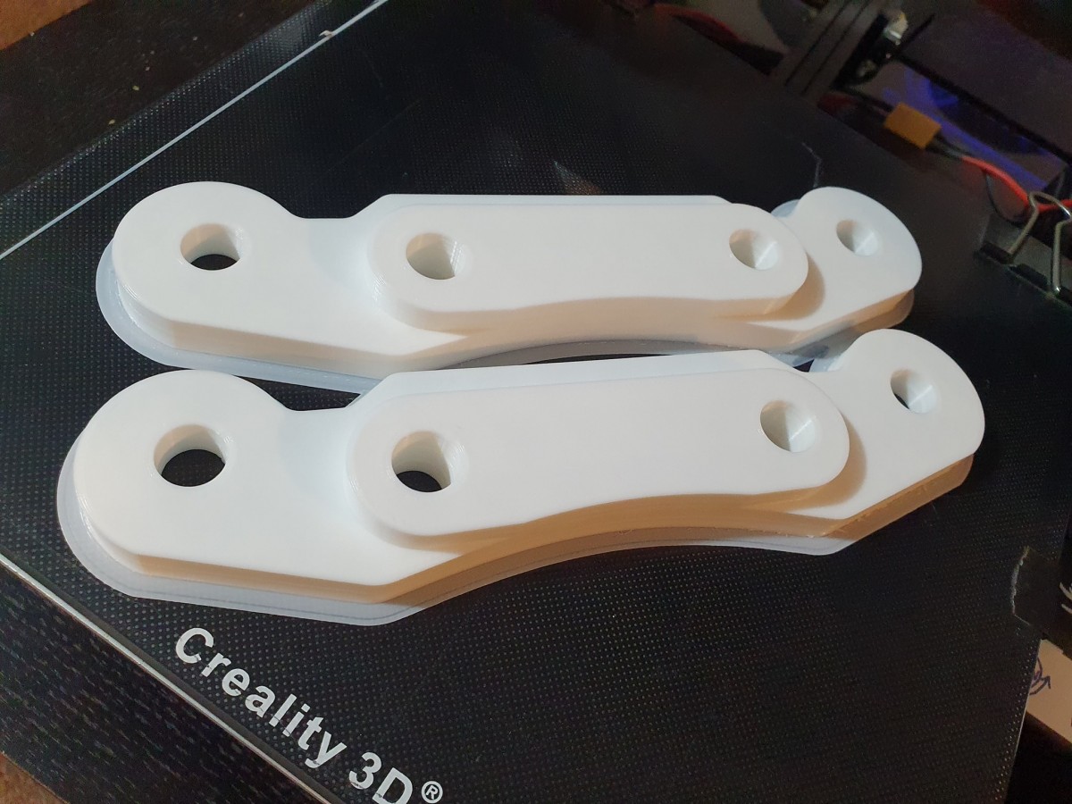

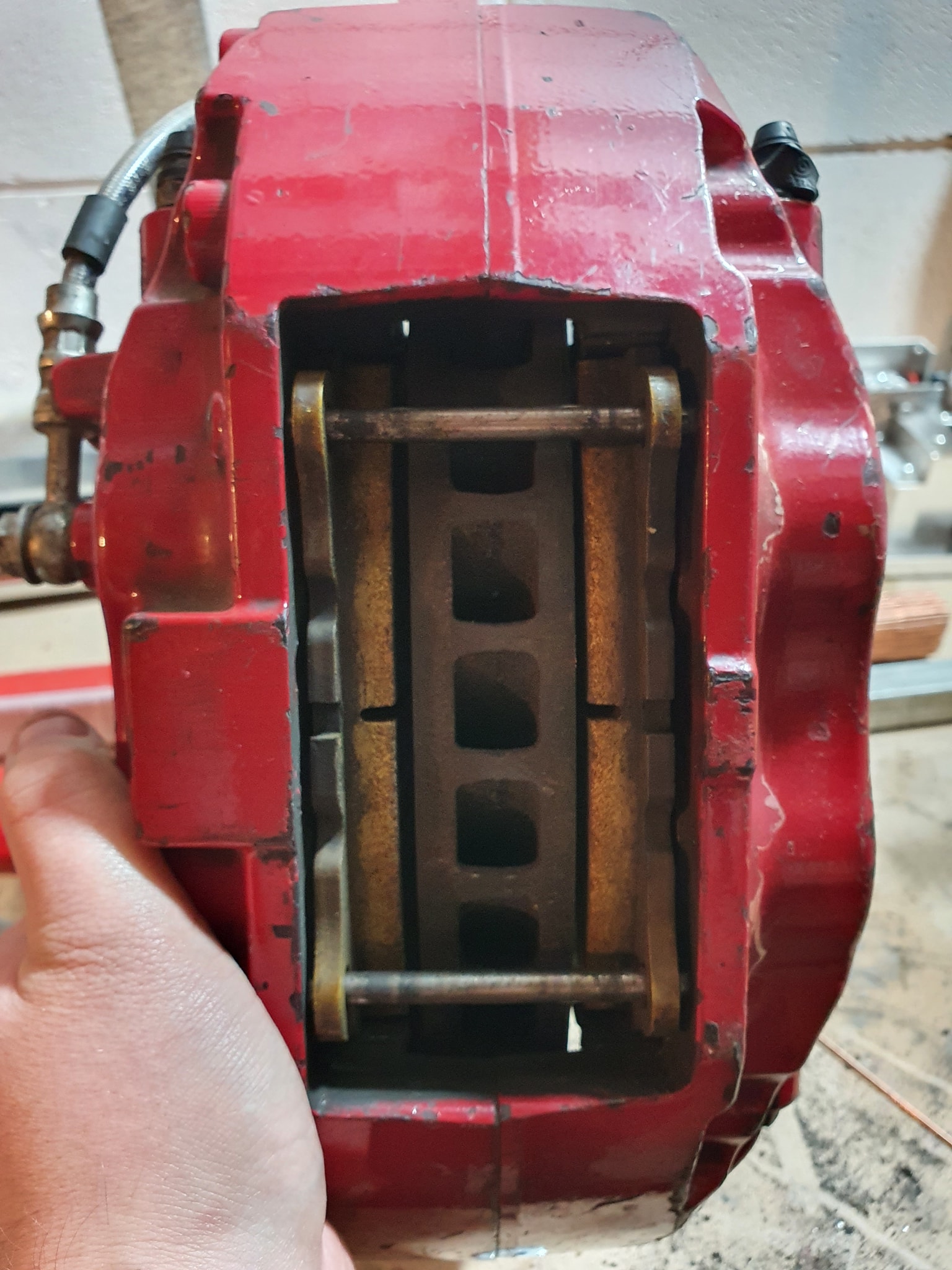

Any how, Needed to fabricate up some brake adapters to fit the Brembo Evo 7 Front brakes to the VZ hubs.
CAD designed up something then 3D printed to test, after V2, have a working prototype to send away for cutting and milling.
