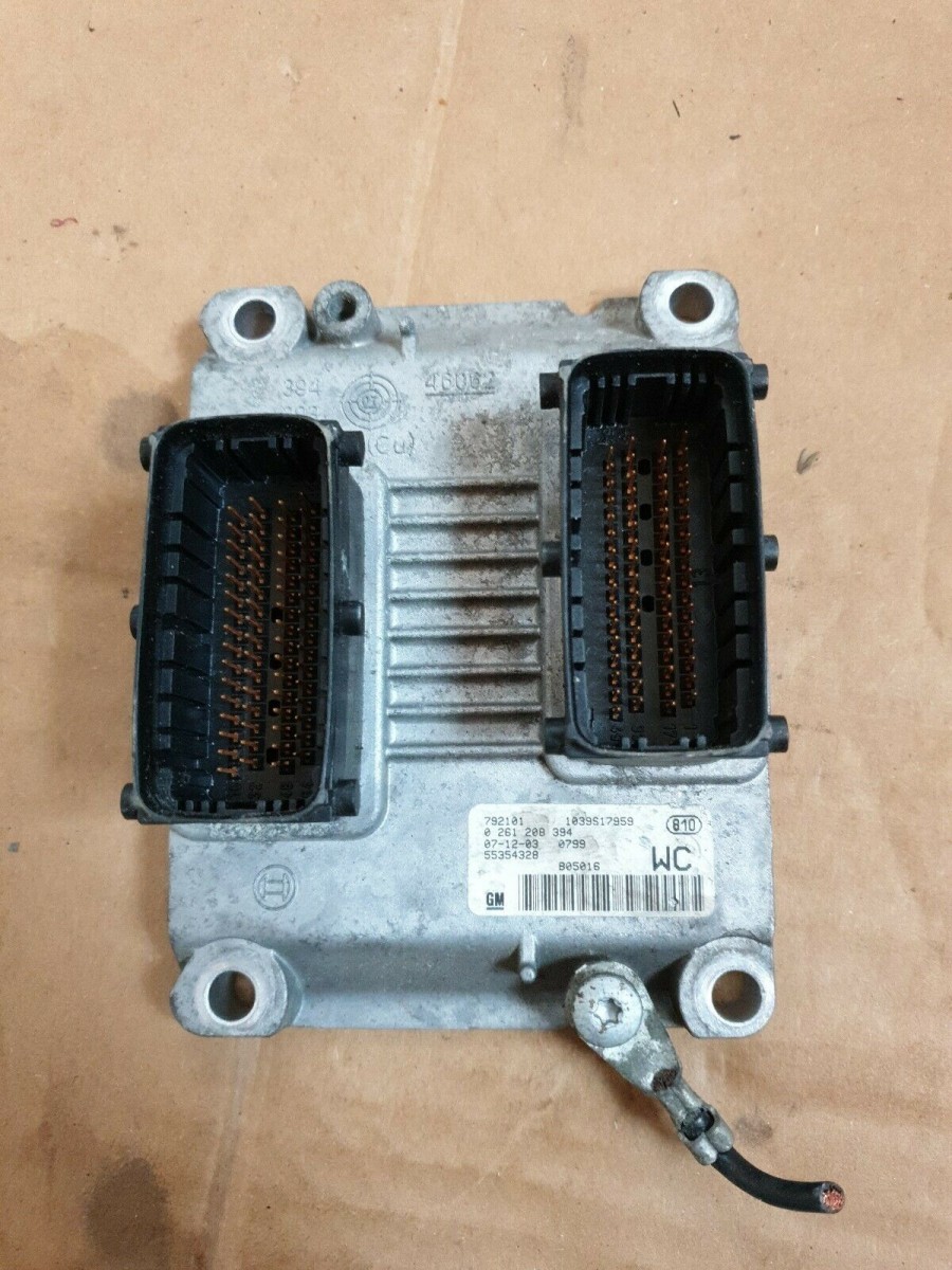

This tool covers the ISO14230 or Kline bus at 10400 with Fast init used on both
Opel Corsa C
Holden Barina XC
With Z14XEP
Using the E55 Style ECU Pictured below.
