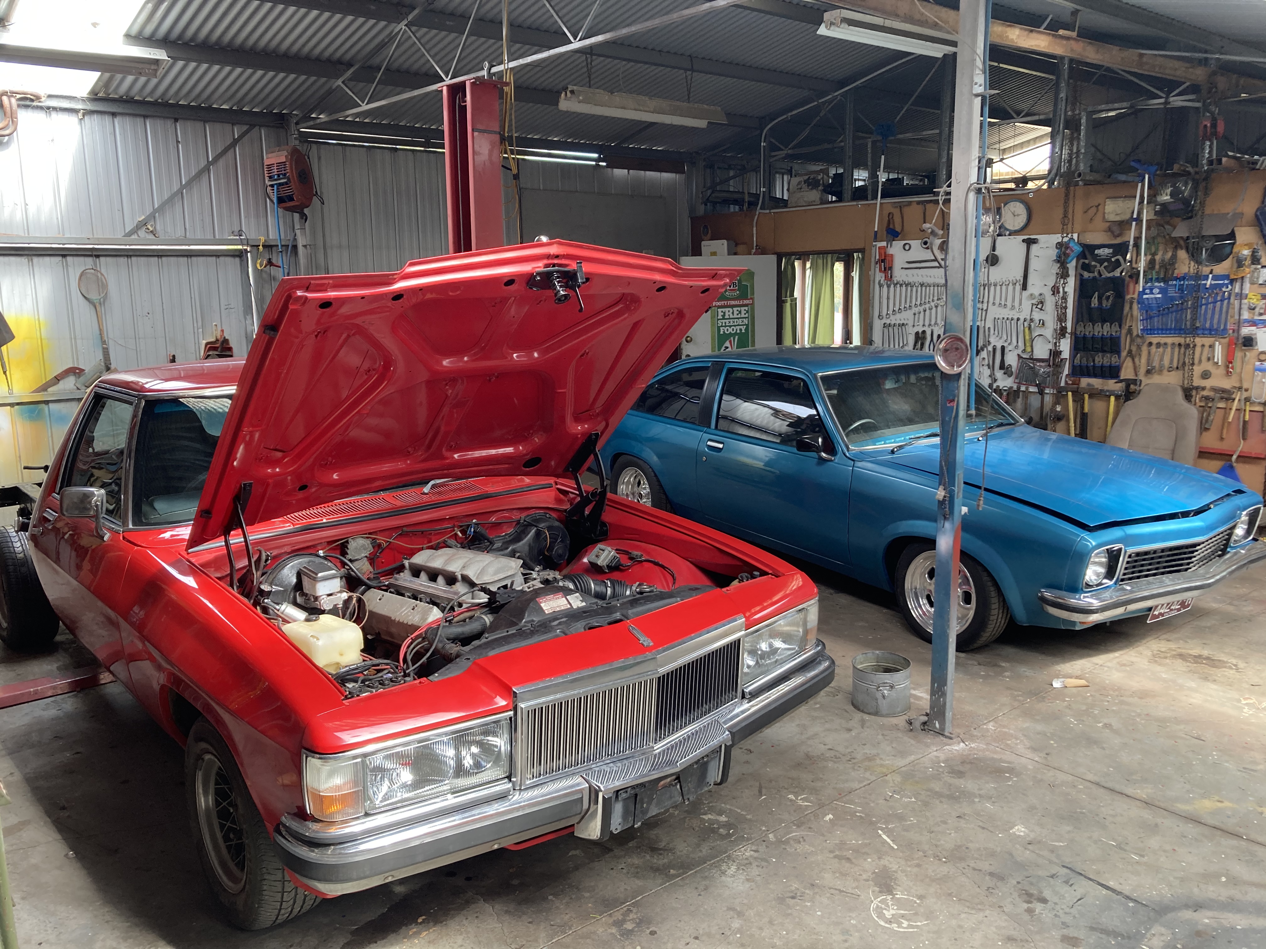

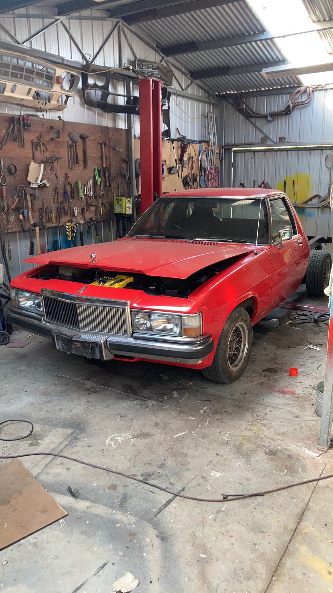

Hi everyone first post and also after help with my first ever fuel injected project.
Already tried searching but it’s so far out of my league I don’t even understand what I’m reading but I’m learning slowly,
Current project is a Holden WB one tonner with an injected 5lt from a vs clubsport 185kw it’s running a VT computer and a 4l60e Tranny
Managed to get it all wired in and running had to get a memcal with the HSV security removed which allowed it to run my final issues are I’m not getting the VSS signal out of the computer I’ve already installed an electronic speedo and also checked the speedo signal into the ECU and that’s fine aswell
I’m wondering if the wiped memcal also has the VSS section removed is this a controllable
Option?
Also my looks missing the Diagnostic port my schematic I’ve been following only says I need 3 or 4 wires does that sound right?
And for this still reading my rambling I thank you for your time
