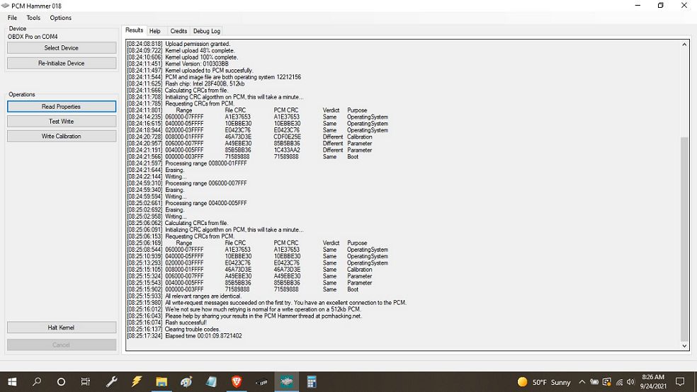

I love the Xpro VT cable.
Full read 2 min 24 sec. Full write 1 min 9 sec. on a 0411 pcm.
This is some assume software NSFW.
