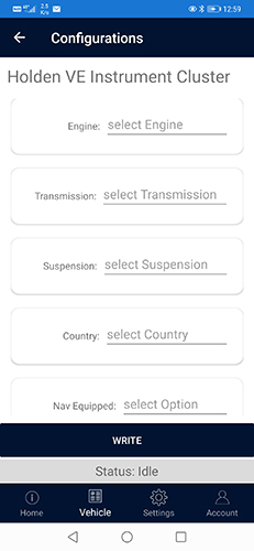

The MOST common question I have ever received is "Do you have someone in (insert country/state/suburb here) that can program this?". It genuinely kills me when I have to say no, and that an item needs to be shipped in to be reprogrammed. This is primarily due to the complexity of the programming procedure, complexity of the software to be made and also the cost of a capable scantool (Which can be many hundreds).
Recently I had a client ask "Why don't you have a phone app to do it?", and I realized I did not really have an answer for that!
With the work I have been doing with Pete and OBDX Pro, we have a solution that allows connection to both Android and iOS smartphones which will be suitable for all Global A vehicles (Plus I snuck in ALDL too).
This then brought on the smarphone revolution for myself, a completely new concept for me having to worry about space, view area, flash memory and ram usage ect.
Its quite the change from PC software, but its surprisingly been alot of fun. :D
My main priority has been to make something thats so simple to use, that anyone can use it.
I wanted an all in one flash tool, that can do absolutely anything I can do currently.
Plus I wanted to be as simple as it sounded, so I introduce to you... NVS Easy Flash.
Easy Flash Home Screen500px.jpg (71.62 KiB) Viewed 5353 times
Easy Flash Module Preview500px.jpg (49.29 KiB) Viewed 5353 times
Easy Flash Program Preview500px.jpg (52.74 KiB) Viewed 5353 times
I am finally at a point where I can maintain a progress thread as its now at a point of adding various module support as the main framework has been completed, although there is still a huge list on the todo list!
Just some of the things include:
1) Complete the BLE integration for iOS (Prototype template in place for basic communication)
2) Implement recovery modes in models which support
3) lockout programming when voltage detected is too low
4) Reconnect scantool in event of dropoff and reconfigure tool to current selected vehicle module
5) Implement ALDL processing (Currently only done HSCAN and GMLAN)
6) Implement Googles Material Design method to maintain consistency between iOS and Android apps.
7) Honestly so much server bullshit that it makes me want to smash the pc. :lol:
As always, I will be wanting to send out some freebies to those that have something to test on and are active on the forum.
I am probably a couple weeks to a month off of that stage, but almost there!
