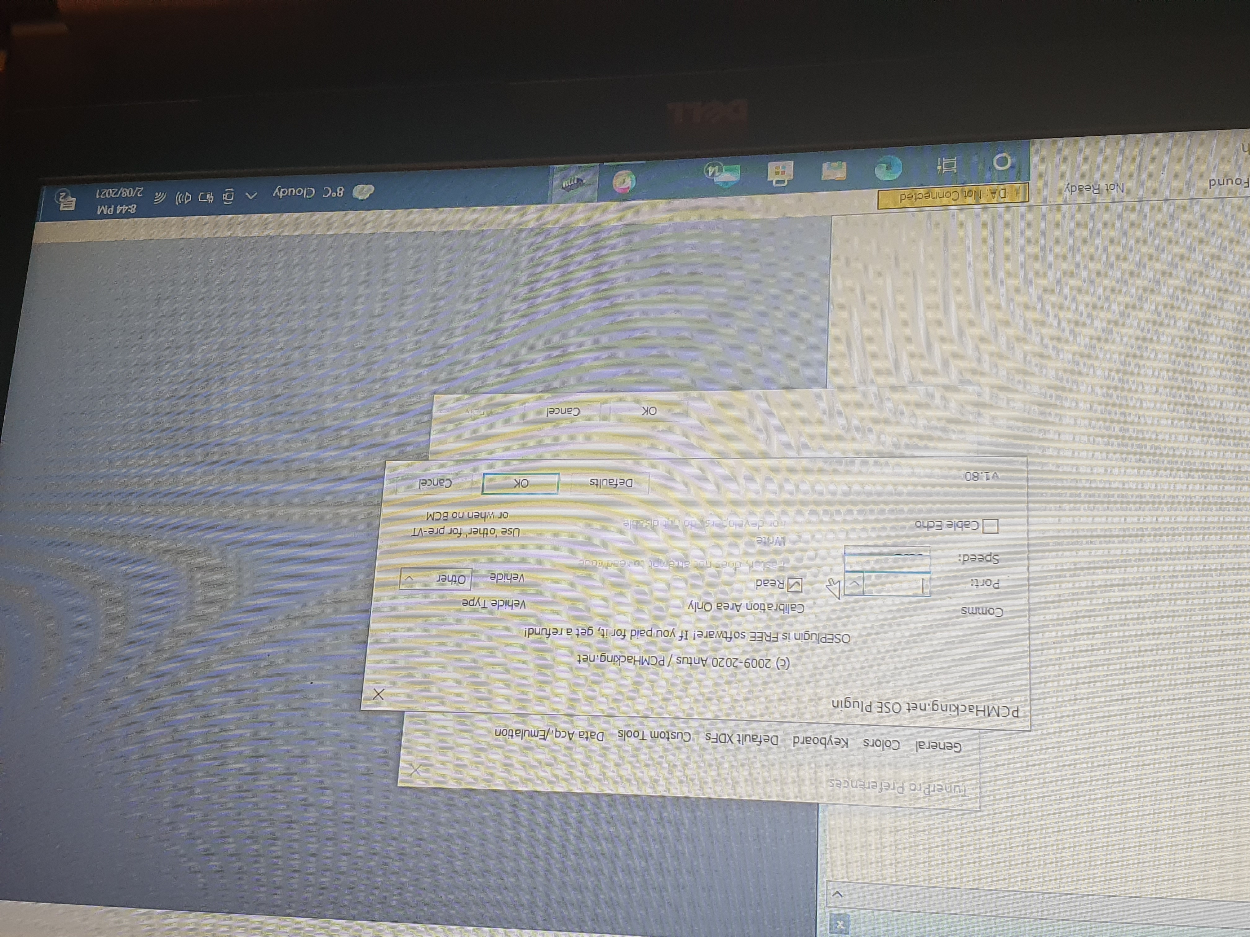

Hey just setting up new laptop has windows 10 iv installed tunerpro 5 RT
12$p file set it all up got ose 1.80 set up framework 3.0 installed wont conect to coms bourd
Go into settings and it wont allow me to select com port its blank im at a loss on what to do im probs missing something
Coms issue on windows 10

Iv tryed all i know no luck this is all i get
- Posts: 10111
Re: Coms issue on windows 10
You need a VCP (virtual com port) driver for your usb interface. Assuming your interface is plugged in and running then you either have no drivers loaded, or have the wrong type.
