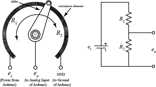

So I don't teach this thing to smoke ...bubba2533 wrote: C1 - Pin 60: Low Ref
C1 - Pin 8: +5 Volt Ref
C2 - Pin 24: TPS Sensor Signal
[edit]
And I would of taught it a bad habit!
Incorrect,
Correct,10k pot hookup ... ??
Right = C1 - Pin 60: Low Ref
Middle = C1 - Pin 8: +5 Volt Ref
Left = C2 - Pin 24: TPS Sensor Signal
Middle = C2 - Pin 24: TPS Sensor Signal
Left = C1 - Pin 8: +5 Volt Ref
- Posts: 9010
Re: PCM Logger test simulation
pot has 3 pins. one end to ground, other end to +5v, the middle one (the arm that sweeps on the resistor pad) to the sensor. If you swap both ends over you'll reverse the voltages and swap whether a left to right sweep is low to high or high to low. Just dont connect +5v and ground (low ref) directly together. Thats bad.
