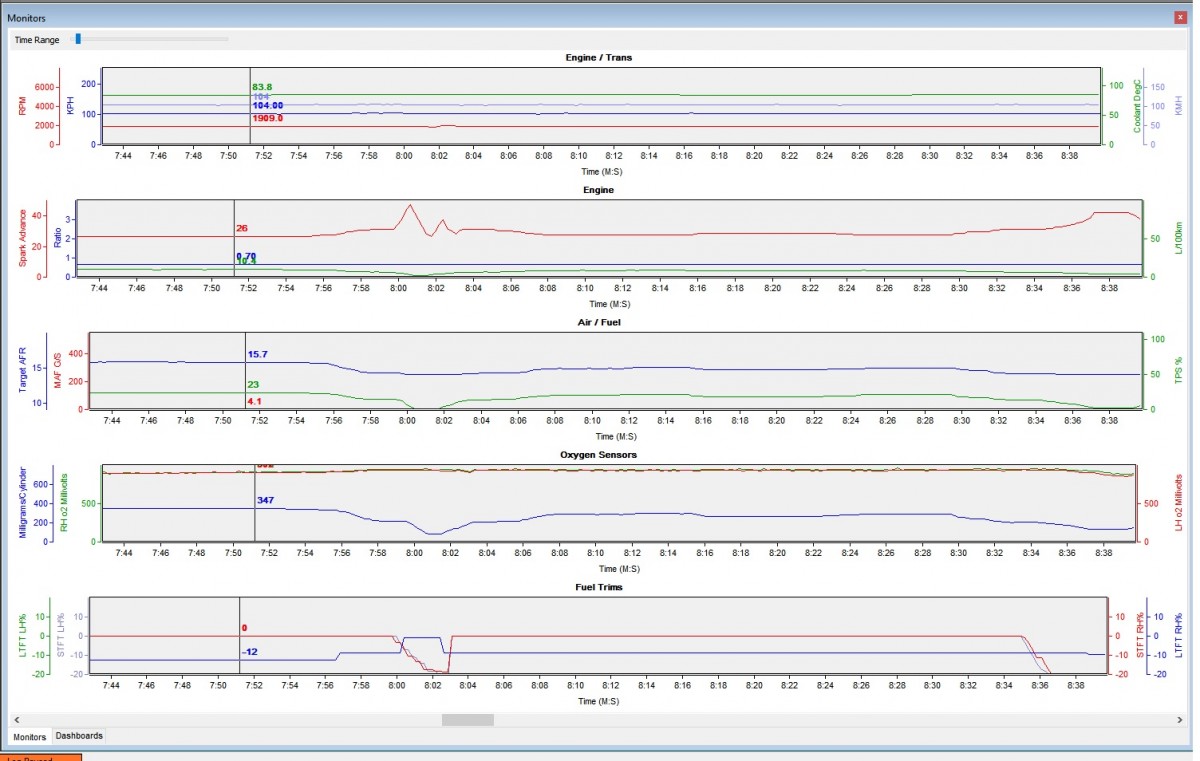

Another thing while thinking of the Rich / Lean issues in what the Base Injector rate varying will result in.
While taking a log on the current setup with the Injector Base Rate at the increased value of 550 msec/gram (as calculated with the kinjflow formulae using the 149cc/min specs). Which we seem to be in agreement should be causing a leaner condition rather than a rich condition. The intermittent error codes returned are P0131 & P0151, which by the obd-II generic codes state a low voltage or short on the O2 sensor bank left hand side. Then I question as to why is the TunerPro O2 sensor readings displaying high voltages (closer to 1volt = Rich ) not low as the error codes state will cause the errors?

Here is a snap shot of the log where the O2 sensors both are reading high, around the 800mv.

Ignore generic OBD2 codes as they don't apply to the V6 engines which still uses ALDL comms protocols.
