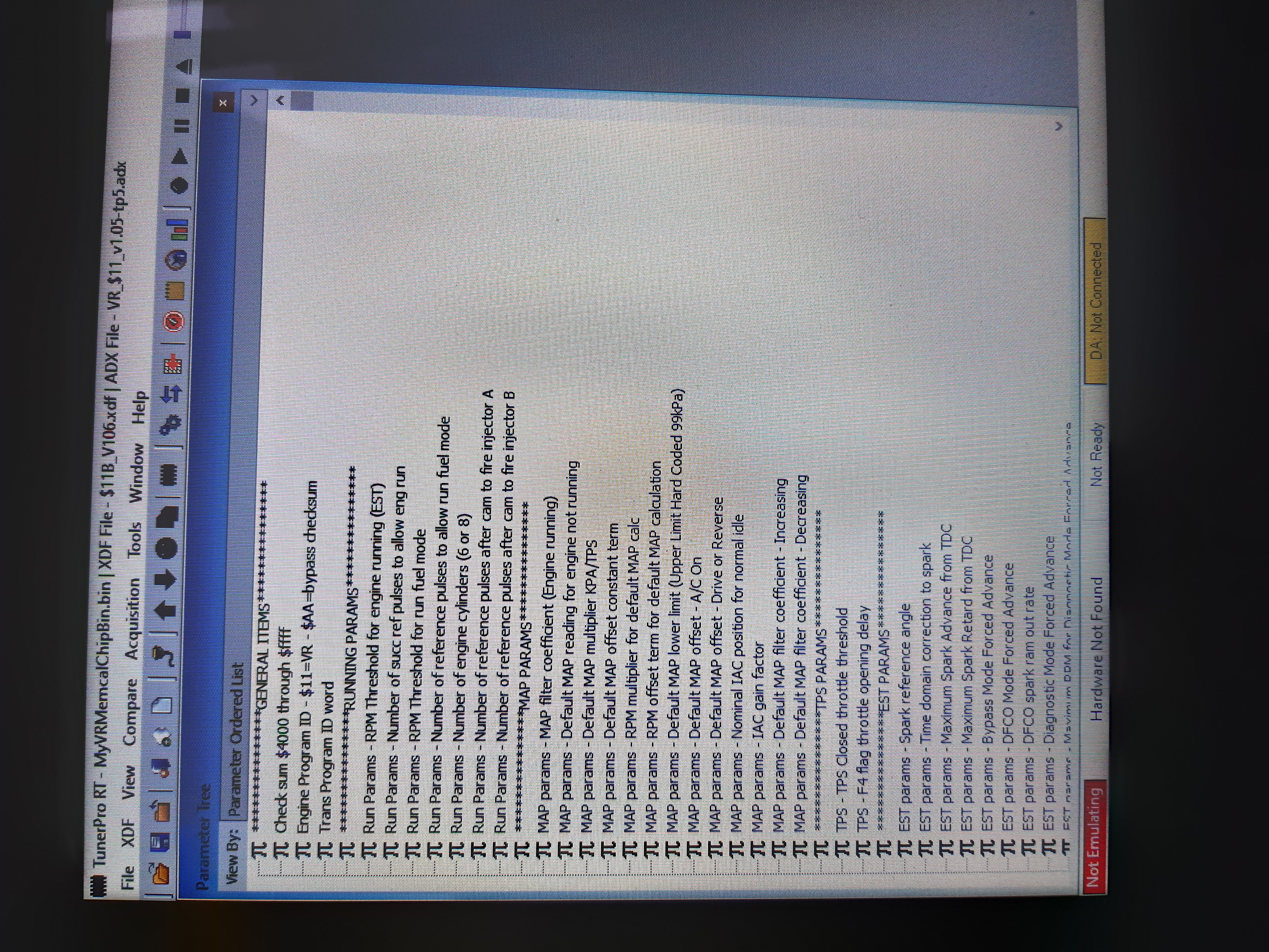

I finally got to grab the Bin from the VR V6, i think i use tunerpro to read it. But I'm unsure how.
To read it, do i need the bin file, and an adx file also?
cheers
Pete

Re: VR V6 Memcal Bin Grabbed - How to read
Your attached VR V6 Bin is based off the Holden CAKF bin or BTXN with the only difference being code 68 turned off.
You will need a XDF file to view the attached bin file. Try $11B-V106.xdf from this site.
One thing you should beware of your attached bin file is missing a block of data between 1000 to 1B0D. This happens if you have downloaded the file via ALDL mode.
You need to download TunerPro RT and with your bin and XDF file loaded in TunerPro RT you will be able to view the attached bin.
CKAF and BTXN are Holden VR V6 bins

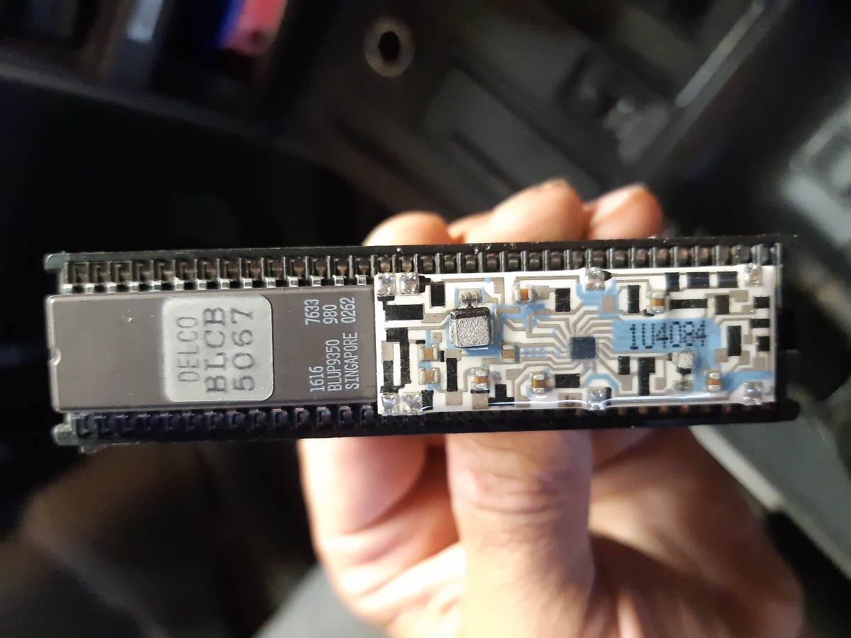

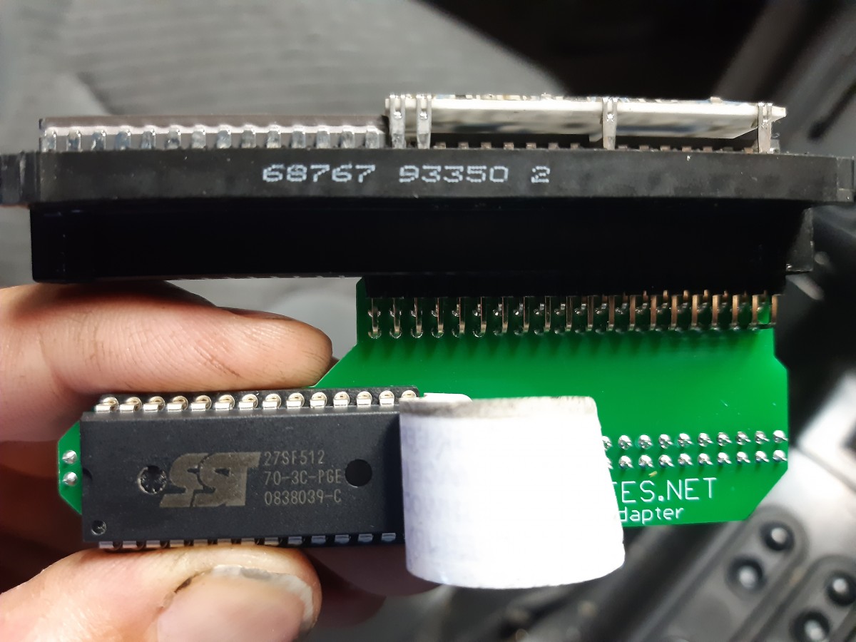

Hi
Would you say this is open and in a readable state?
I'm about to go get the numbers off the old, and the new memcal(s)
Will post back shortly.
Edit: attached factory memcal photo
And newer memcal
Cheers
Pete
And newer memcal
Cheers
Pete
OK I had another look using the number off the eprom and your flash chip and yes they have smoothed out the timing map but also pulled fuel out of the VE tables which seems very odd to me. They have also extended the lean cruise area. I think that program is aimed at less fuel consumption. I used your Bin file and the BLCB5067 and the $11B XDF from the1's Memcal ID program. At least the replacement has a 27SF512 flash chip which is a lot faster to program.
