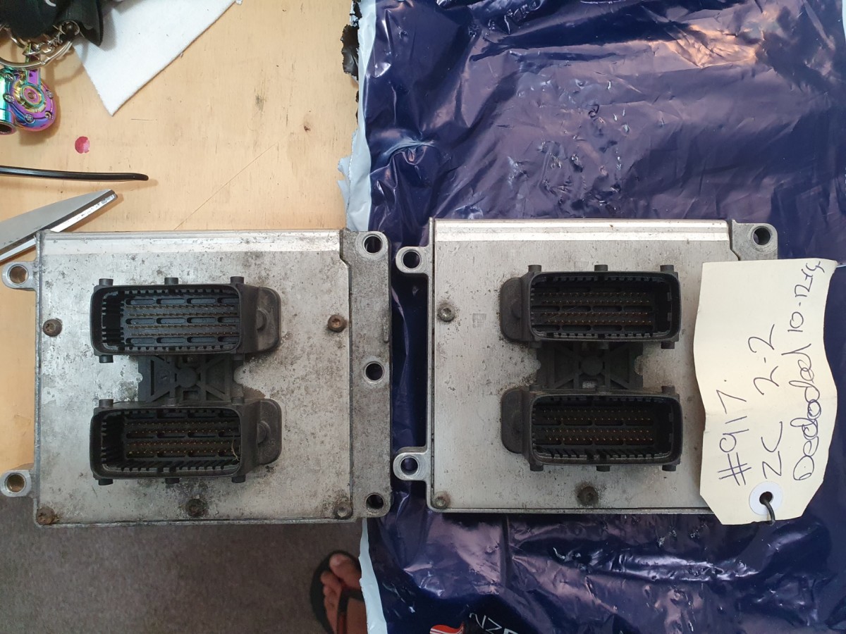

As above, After a diagram to bench program one of these ECUs. I generally dont do this stuff but with them failing so often i want to get into them.
Hopefully the CD ecu on left is compatible with the ZC on right

2006 Vectra should be ZC, the CD is the boot badge (in Australia anyway)
JR - 97-98
JS - 98-03
ZC - 03-07

Gareth wrote:2006 Vectra should be ZC, the CD is the boot badge (in Australia anyway)
JR - 97-98
JS - 98-03
ZC - 03-07
Great thanks for that mate. Ive got to learn about them a bit more!
You wouldnt happen to have a diagram for them?
Also have you ever done a link process for them?
If so, do they link to a bcm or tdm?
Ill have to link in vehicle, But im wanting to know if when delinking, do need the original bcm or tdm on bench to delink or can i just delink via code on bench like we can VZ VE.

A 19 & A 20 power
1P earth
A 21 comms
