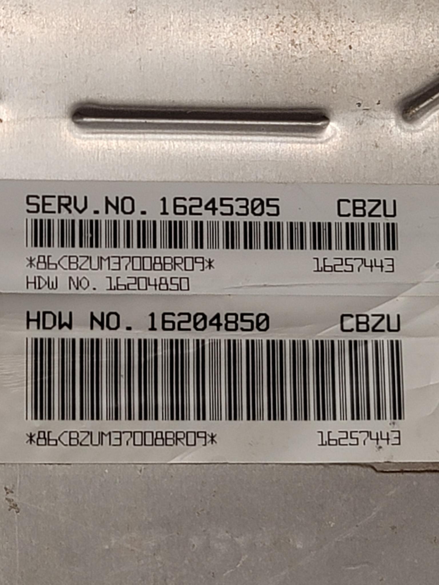

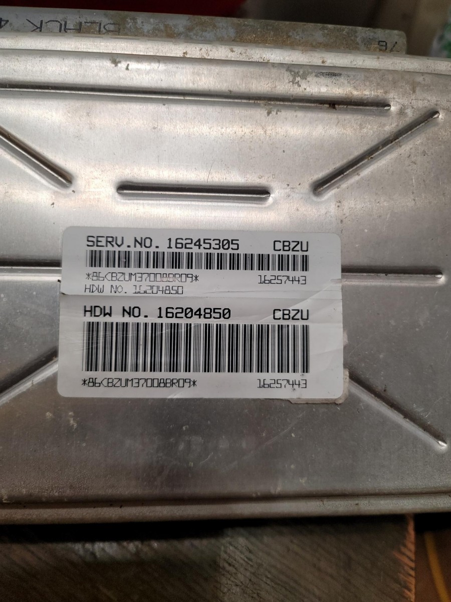

So I had this PCM gave to me. It's from a 1999 Chevy Malibu 2.4L engine.
Can anybody tell me a software I can use to read it?
I haven't tried PCM Hammer yet, but I don't think it will read it.
I have a bench harness I use on my P01 and P59 Pcms.
I guess I can try with PCM Hammer and HPtuners.

Well Hammer nor hptuners will read it.

I THINK it is a P08 PCM and the only CURRENT app that has support for them is EFILive (unless THEY discontinued it recently).
