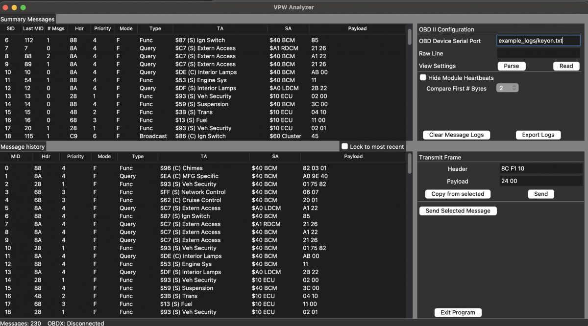

Well, after a few request for this, I decided to make a github and publish this barely working tool that I used to sniff out a lot of VPW data on my car. I'll warn that it's rough, and that I am NOT a UI developer. I deal primarily with MCUs and embedded devices.
https://github.com/jonofmac/vpw_analyzer
I threw this together for my ABS sniffing project as I was trying to get around and understand the ABS module's ice mode. It's also been helpful for some other personal projects.
Features
  • Parses VPW frames headers, target and source addresses
  • Can export received messages to a text file
  • Can import text files
Bugs/Not Implemented
  • Crashes when closing (often times requires a ctrl-c on the task to end it) - Fixed in v0.2
  • Does not support sending any messages
  • General Bugginess :)
Requirements
  • Moderately quick machine to keep up. Python isn't efficient, nor is my software
  • Python 3 or higher
  • Tkinter (tk)
  • Pandas
  • serial
How to use
Easiest way to install these if you have a command line interface is with pip
pip3 install tk pandas serial
Then simply point python3 to the python file by being in the correct folder and running
python3 vpw_analyzer.py
I've provided an example log of my C5. Enter the relative path to a log in the OBD Serial Device Port, for example: "example_logs/keyon.txt" and then press "Read". You should see it populate the tables as if it were reading it live.
Any ELM327 device should be compatible with this, as it uses only basic AT commands to listen to the bus.
You need to enter the serial port into the "OBD Device Serial Port" box. For Windows, this is typically a "COM1" name. Check device manager to get the actual COM port.
For Linux, you need to specify the full /dev/tty device path.
Once the serial device is entered, press the "Read" button to connect and begin listening to the bus.
I'm honestly uploading this so that it might provide some help to the community, and if someone is more familiar with python, helping clean it up a bit.

I think th crashing bug is related to the threaded task not receiving the request to kill app. It hangs and eventually has the terminate the task.
I did a lot of reading into VPW protocol and actually can decide messages further with some more software work but I'd like to get the basic functionality a bit more stable.
The "last MID" column seems to not work properly either. Which is weird because I swear it used to lol.
Being able to look for repeating messages is convenient.
I realize my car published my VIN and odometer reading to the bus in that log I uploaded. Haha whoops. I've got a few more logs I can upload as examples too.
I really wanted the OBDX device to have a way to support transmitting a message (or writing the data to the pipe to transmit) without having to drop incoming messages. It's been a problem on some other projects I can't work around.
Seems that if you want to send, ATMA must be cancelled. There was a background reception mode on OBDX I saw but that also seems to drop any packets that were received while the input pipe was not cleared. I was hoping it would store incoming messages in a FIFO then transmit them after the message to send line has received it's newline character.
