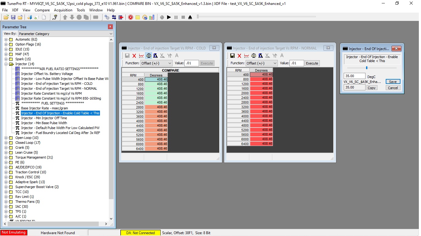

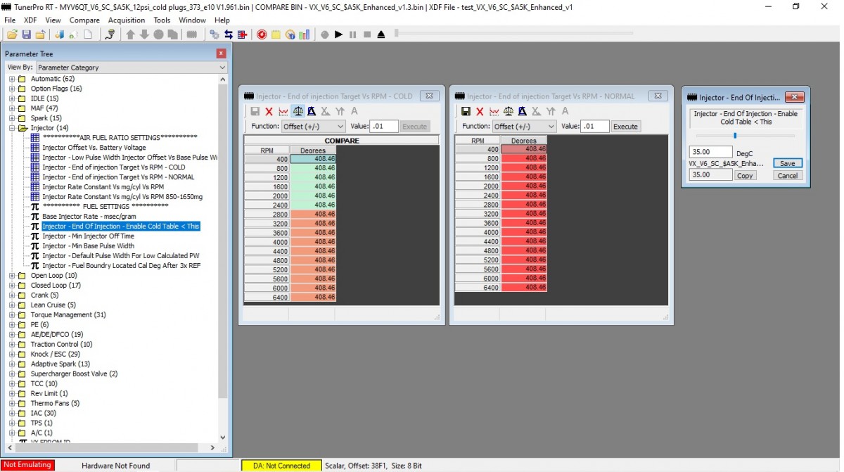

Re: End of Injection - L67/ecotec
For those playing along, These are the options available on the ecotec/L67 enhanced tunes for EOI.

It would seem the later LS tunes have a lot more settings available than what I have. As I understand it. In our original tune there was only a single setting, The1 created the tables we have now so we can adjust EOI by RPM as well as a Cold and Normal operating temperature table.
Just for a moment, can we clarify exactly what the EOI point is, my understanding is it relates to the intake valve closure point. So we are timing the injection event to occur before the intake valve closes on the induction stroke and regardless of injector PW so the end of the event always occurs at the same point (measured in crank rotation degrees).
I'm just trying to establish when exactly the 408.46° number and where the relevant reference point starts on the V6 motor.

If I look at this table,
It shows that when the engine is cold the EOI is happening at 229° but once the engine is up to operating temp EOI is at 499°. So if 499° is the intake valve closure point than 229° (some 270° earlier) happening when the intake valve is only just opening or even before.
