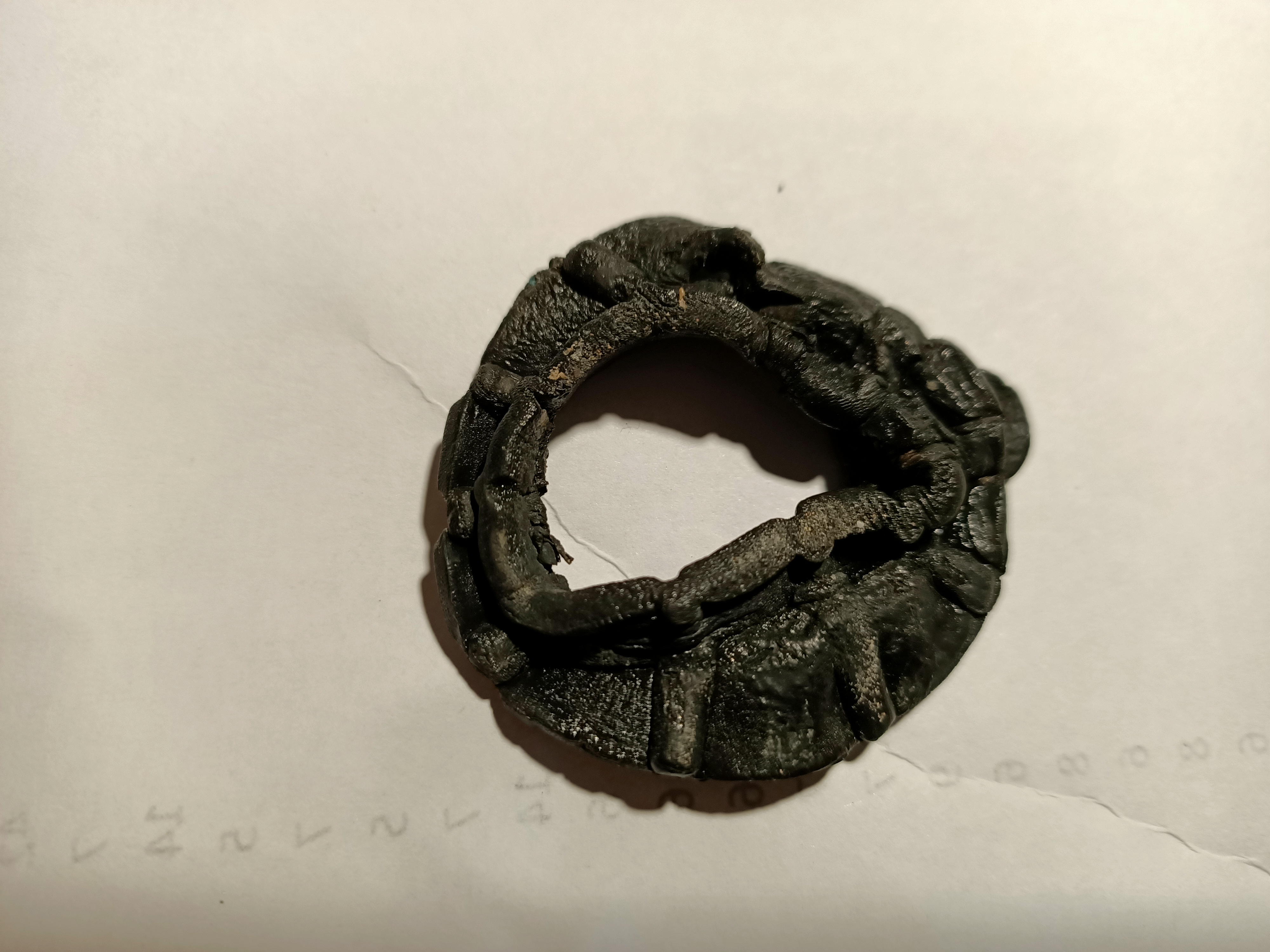

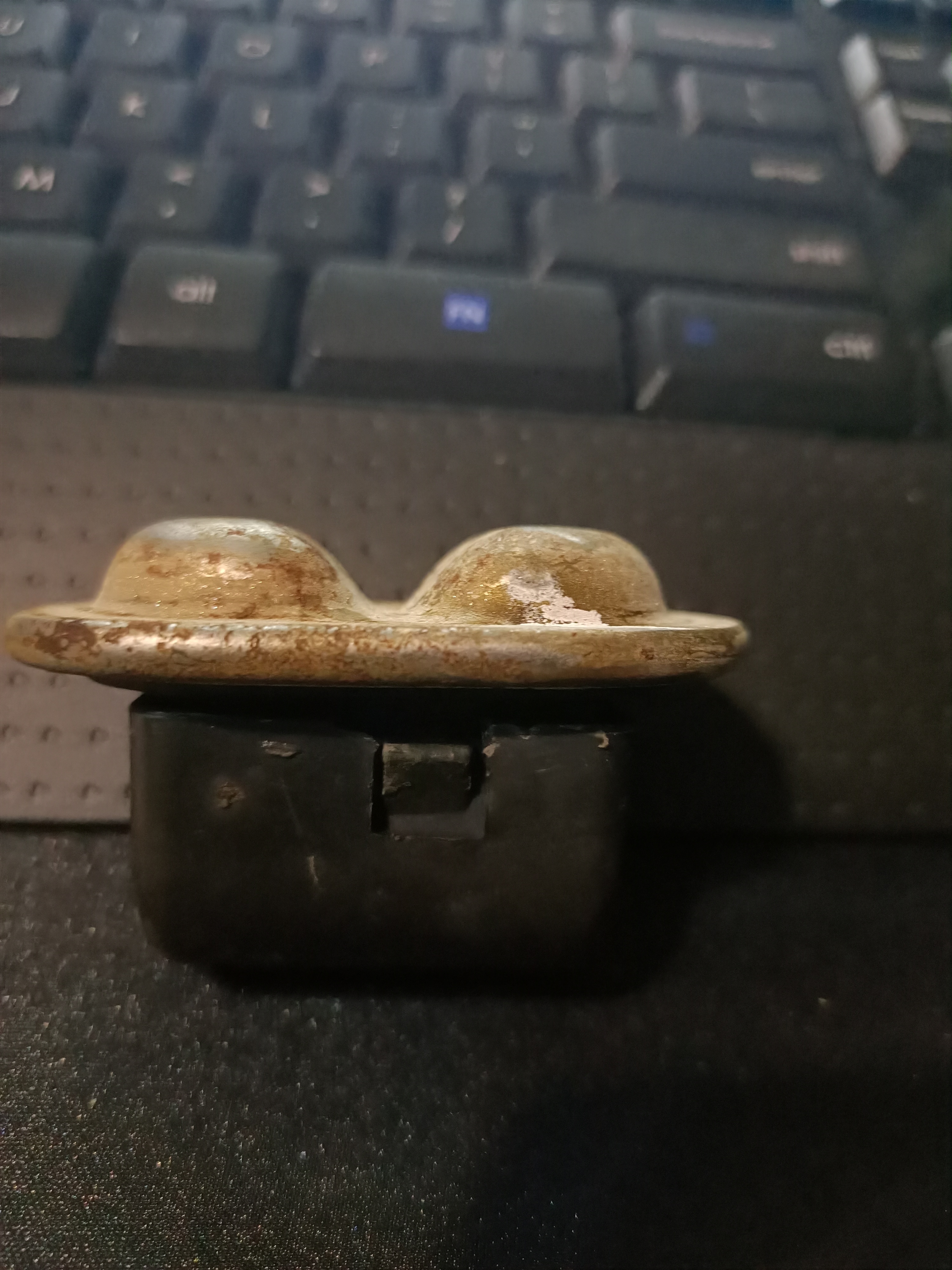

Post by Charlescrown »
My guess is it's a pulsation damper. If I'm correct can I leave it out? It's a VR Commodore intank pump suffering the normal broken return hose problem but when I took it apart the rubber components were just mush. I think the fuel I was buying was loaded with incompatible rubbish. I'll stick with either BP or Shell from now on after problems with 3 cars.
Posts: 8118
Re: What is this???
Yes that is a fuel pulsator. AC delco part FP27. Ideally you want it there to smooth the fuel delivery.
What fuel did you use?

Re: What is this???
Been using 98 from Speedway Petroleum. As I said this is the third car where the fuel pump has had it. I admit I don't run/drive them much but the effect on rubber components shouldn't be happening.

Re: What is this???
Perhaps you might know the part number for this. It's a suport rubber at the bottom of the pump.

Re: What is this???
I agree with your comment. I ahve no idea but they sell a big quantity here is Sydney. I have been buying diesel fuel for one on my cars for 12 years and the other 6 and never had an issue but the petrol is another story. Just trying to fix the return line in the tank. It turned to absolute mush and broke off.
