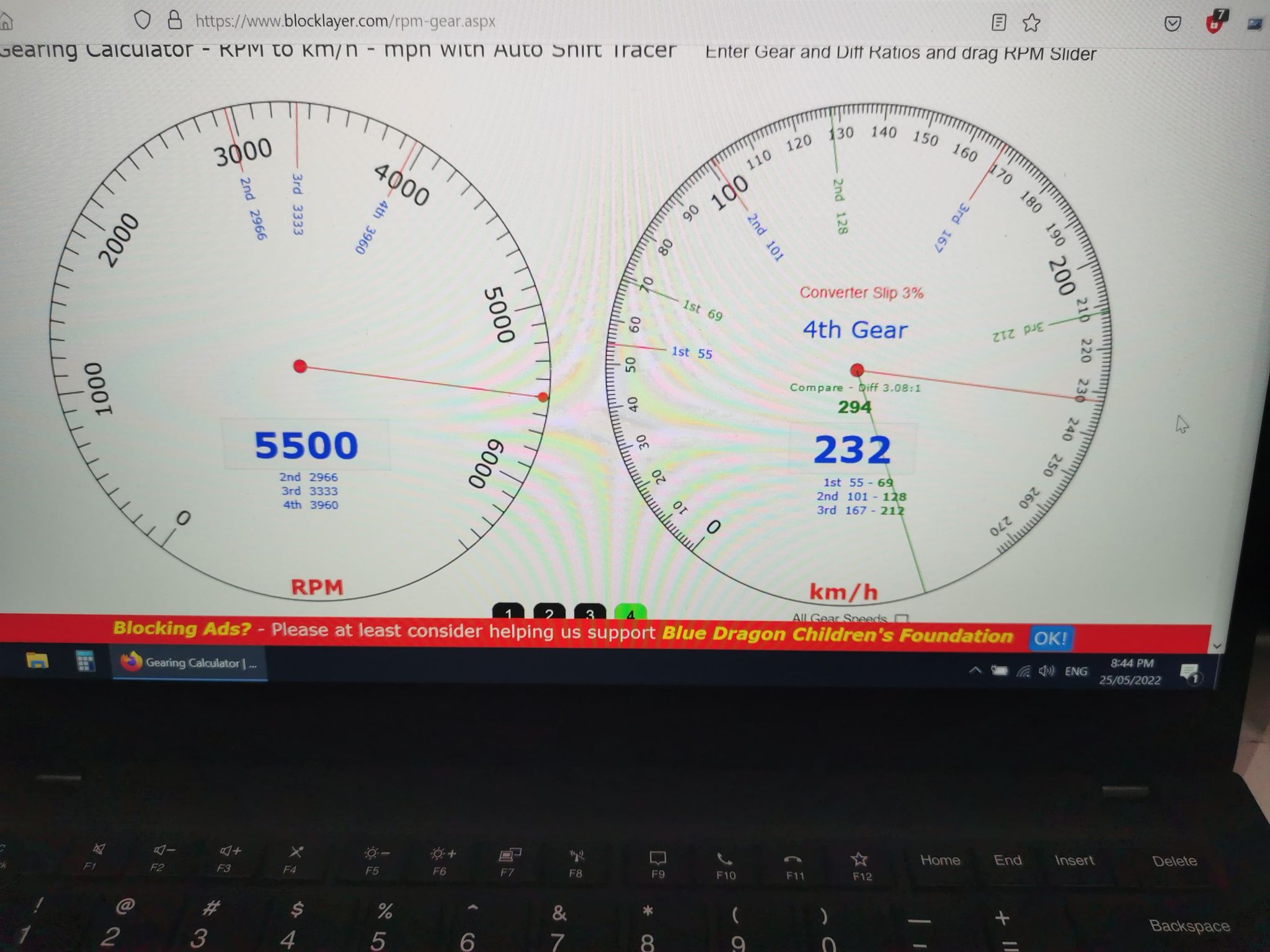

The shift tables for the Auto trans are based on road speed Vs TPS, with the shorter gears the engine rpm will be higher for a given road speed so you will need to adjust the shift points at full throttle to suit the lower road speed the car will be doing at max revs. There are online calculators that can help with working at RPM Vs Gear Vs Speed. I use this one.
https://www.blocklayer.com/rpm-gear.aspx
To make the trans stay in 1st you will need to increase the max road speed/rpm in all the manual shift tables for 1st gear.

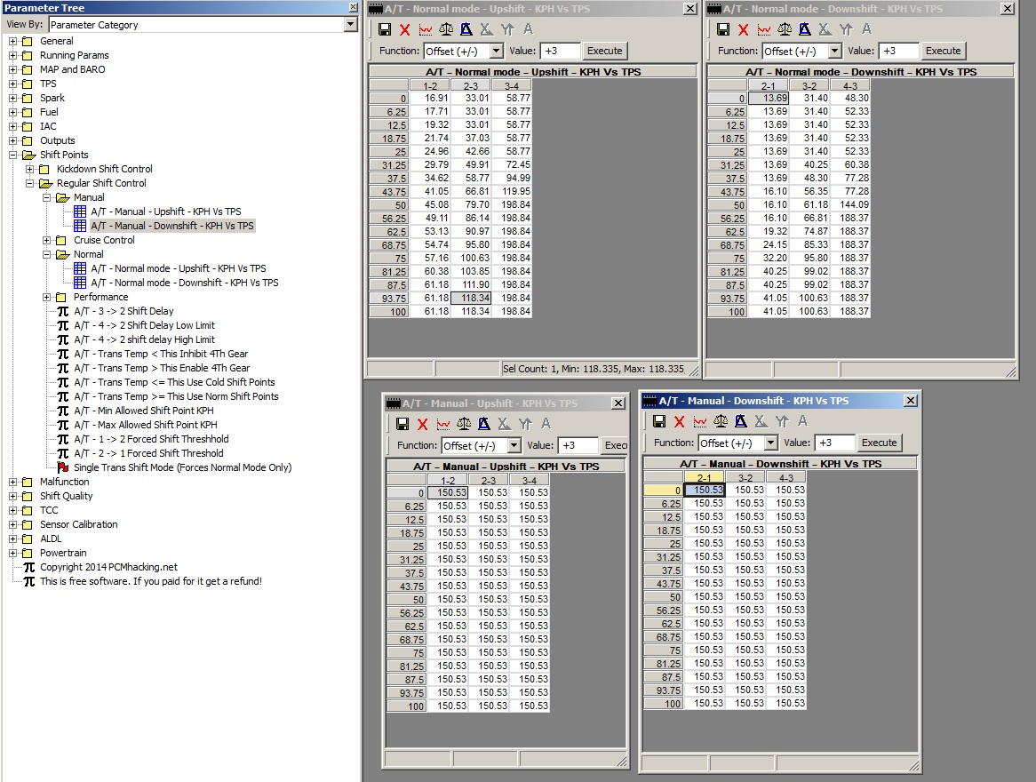

Im guessing these tables which i have played with before i should lower around the 93 and 100% tps tables a couple of km at a time and see how i go in normal mode and performance mode?
Looks like manual shift tables maxed out already ?

Use the calculator to work out the actual speed in gear allowing for a few percent converter slip rather than just guessing.
vp304
- Posts: 479
Re: Vr 4l60e help needed

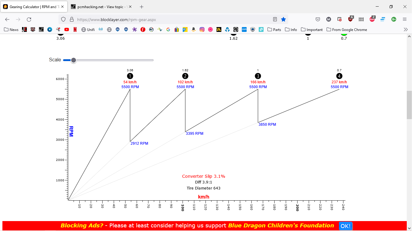

Does this look like im on the right track put in all my details and around 3% for converter slip

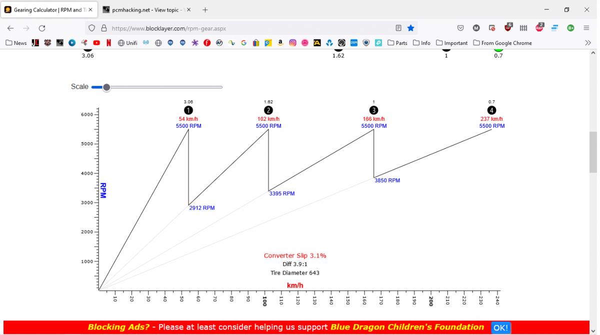

That doesn't look quiet right. I get this.
I'm taking a guess at wheel diameter based on a 235/45/17 (643mm).
vp304
- Posts: 479
In my picture the 3.9s are the green line and within 1kph with what your chart shows.

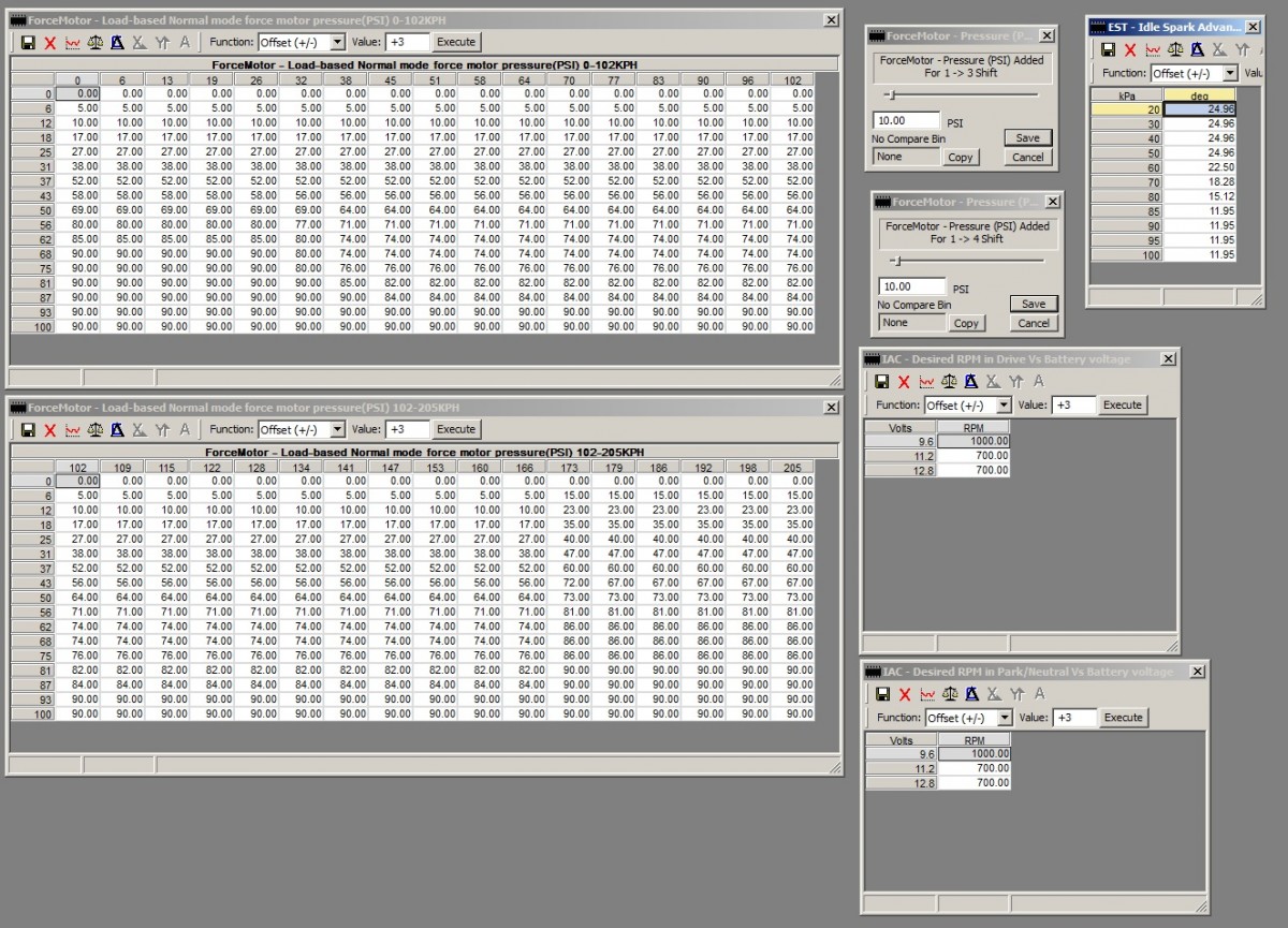

Immortality have you played with force motor settings before?
- Posts: 3820
- cars: VS,VT,VX,VE
I have, turn up the pressures to much and it bangs into gear under low load.
Basically you want enough line pressure so the trans doesn't slip a lot on a gear change but no more than required really.
