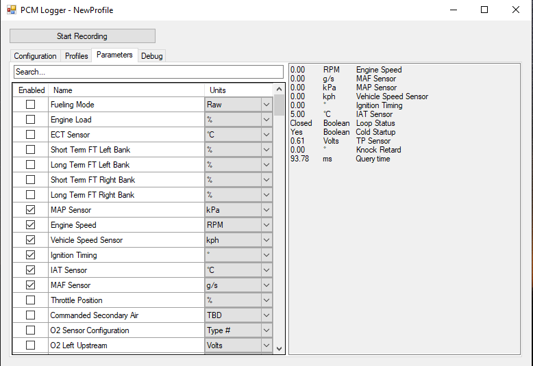

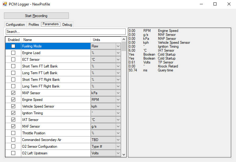

PID Boolean Profile Issue:
I've been able to reproduce this error multiple times.
  1. Connect Device to PC, Open PCM Logger, Select Device
  2. Select Profiles Tab and Open Basics Profile
  3. Open Parameters Tab and add Boolean Parameters "Cold Startup" & "Loop Status" (Both are from PID 1105)
  4. Open Profiles Tab and Save As new profile
  5. Close PCM Logger and re-open
  6. Select Parameters Tab and now 2 "Cold Startup" Parameters are listed
Before Closing PCM Logger:
PID Boolean Issue Before Closing.PNG (36.26 KiB) Viewed 4249 times
After Closing and Reopening:
PID Boolean Issue After Close & Reopen.PNG (30.64 KiB) Viewed 4249 times
NSFW
Posts: 745
Re: PCM Logger 21 - Testing
Post by NSFW »
Thanks for reporting these. I'll look into it.
