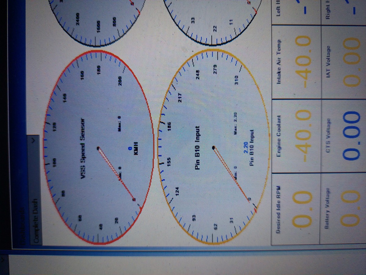

Hi guys im trying to(I think) change values on pin b10 for the adx that VX L67 Getrag made. I have the gauge display on the dash screen but the values are from 0 to 310 and I think that basically represents the degrees of the circle. I need to display boost pressure and I can't figure out how to do this. The gauge itself moves with boost so I'm sure it is boost that pin b10 is displaying but I need to put the values of psi or kpa somehow. Everythingelse on this adx that VX L67 Getrag made works great ... Any help on how to do this would be very appreciated thanks guys.

Here is the gauge I'm talking about

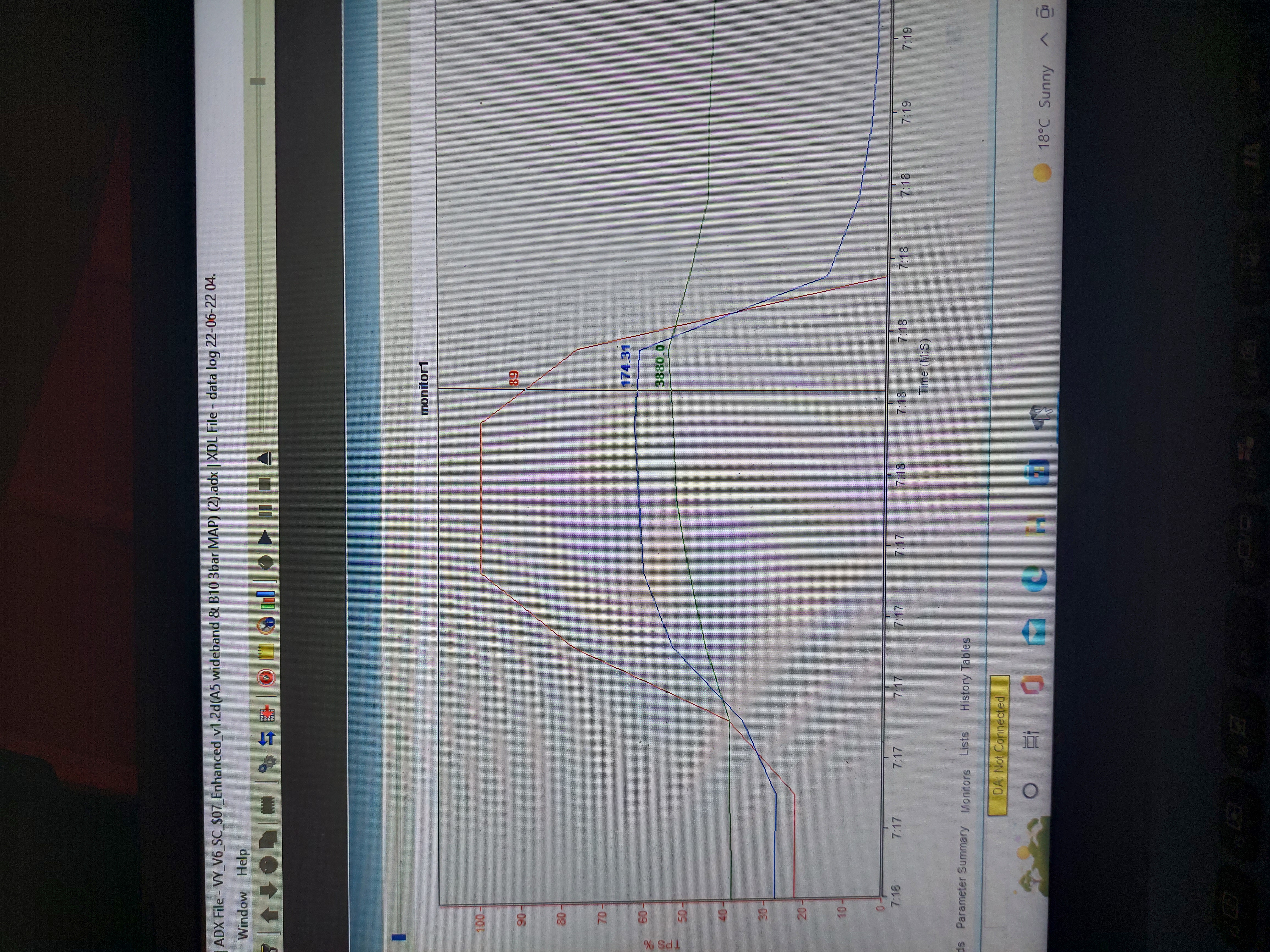

Here is the graph at WOT. And I checked the part number and I have a delphi 3 bar map installed so I assume I use the 3 bar calculations in the adx

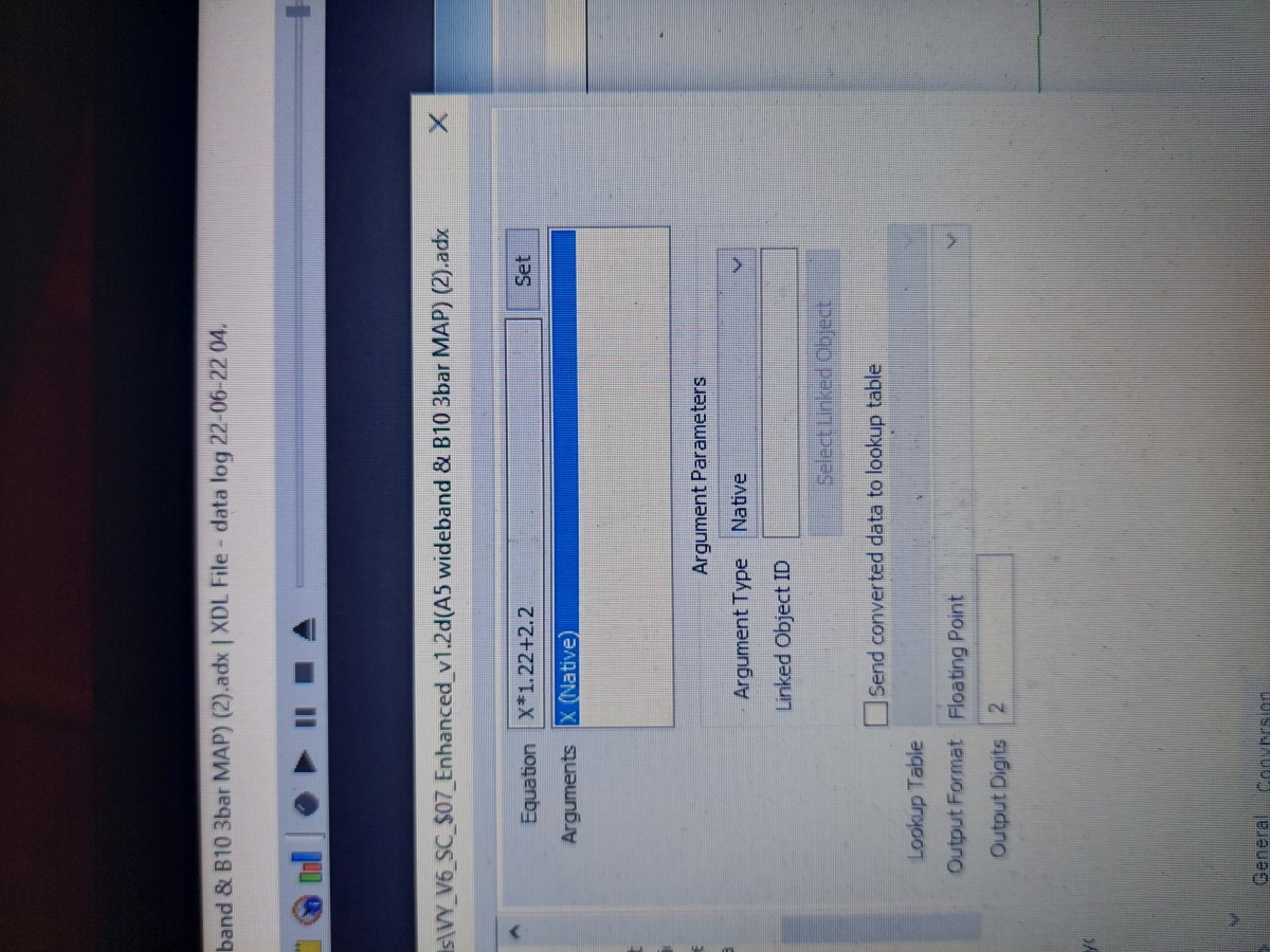

It might help if you post up what the current calc is for it.

Are these the calculations you mean

Re: Help logging boost on tunerpro
And I have this calc as the one im using
