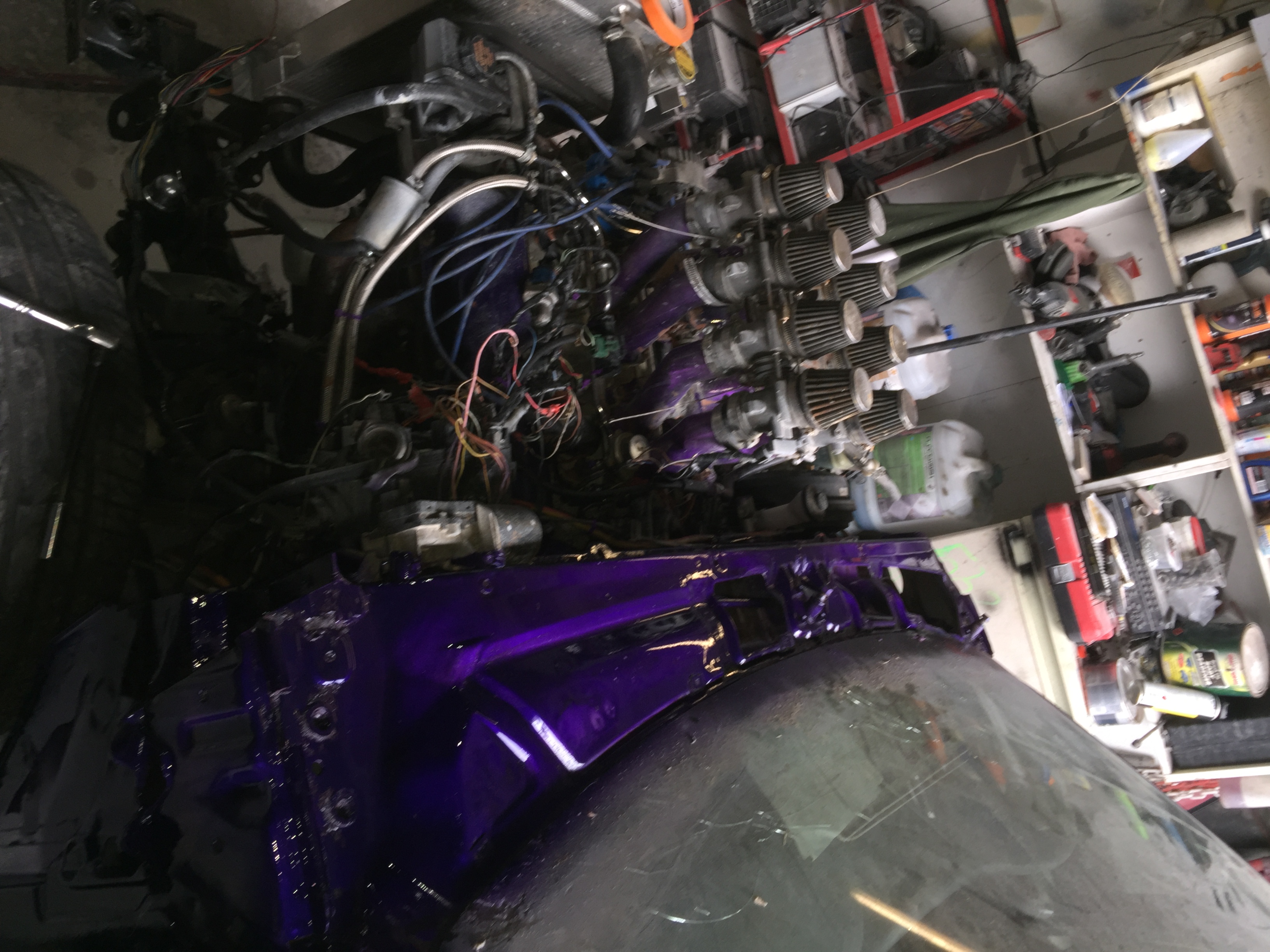

OK, with my frankenstiened AU 5.0l running an EL dizzy with sensor and delco from an VN. 2 pairs of BMW 1200 throttle bodies from bike on a custom manifold backed up by a fully manulised btr auto

We need pics of this Frankenstein it sounds wicked

i do have the build pics on instagram :) https://www.instagram.com/vaxx70/
Have'nt posted since I've been driving it, to busy with trying to get this thing right now

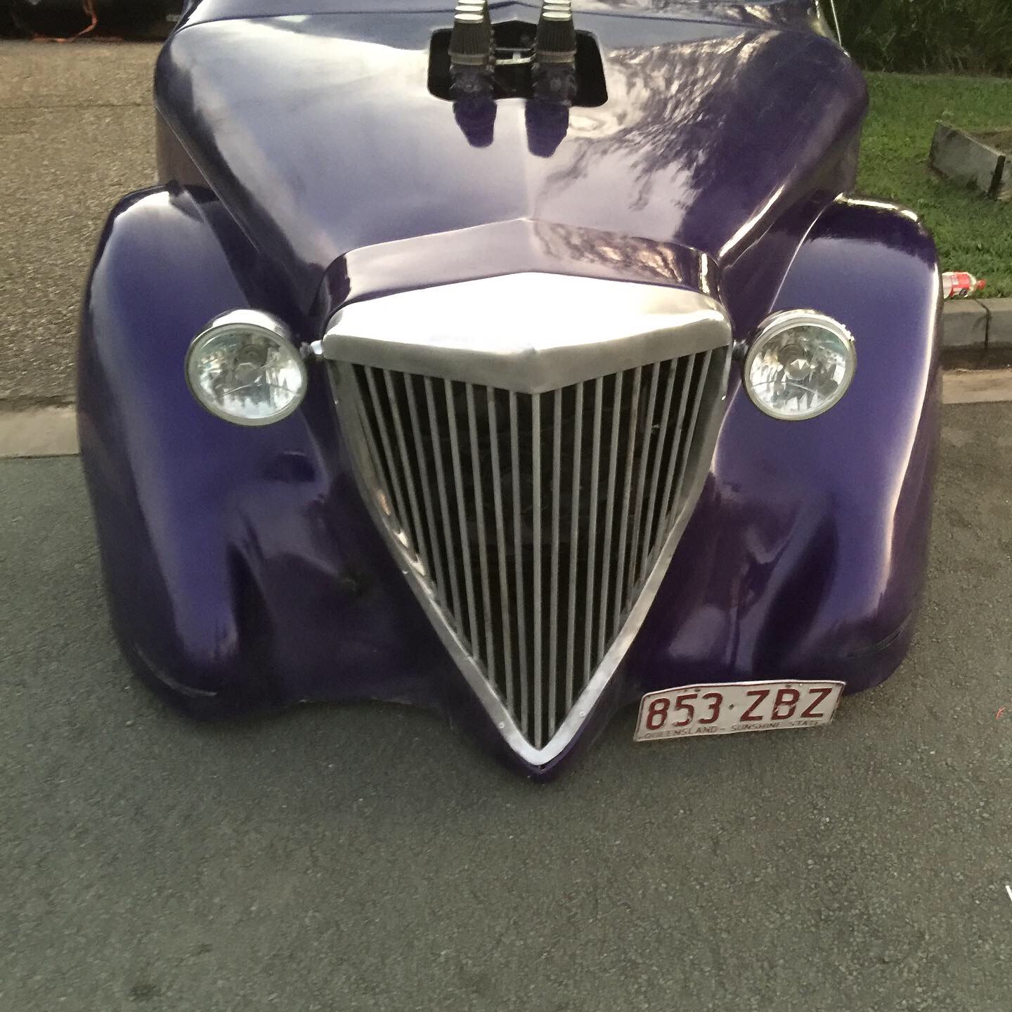

i'll have to take a few new pics, got a bit of battle damage, and I have the stepside rear almost done apart from getting stoved in the arse the other day. Good thing I hadn't done much on the back and he ate the towbar :D
