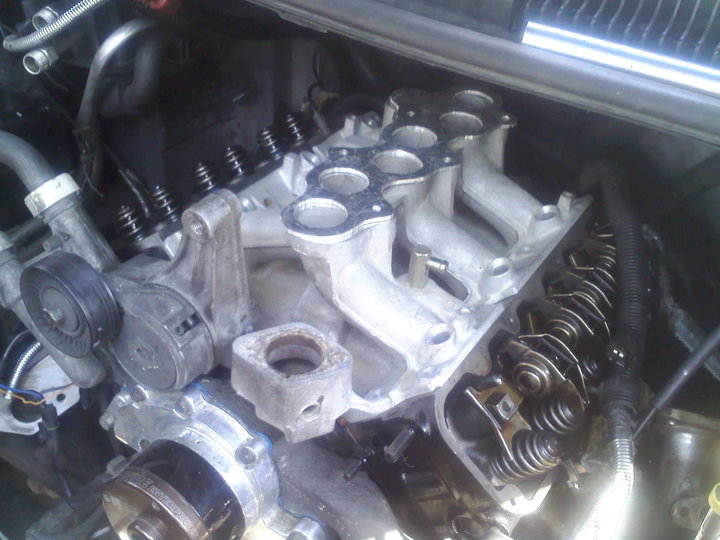

I’m looking for an intake manifold for a Ecotec VS Commodore
I don’t need the upper sections or throttle body. Only the lower piece of the intake manifold as pictured below.
I’m located in the United States and we don’t have these style manifolds in any factory vehicles.
Any help would be appreciated.

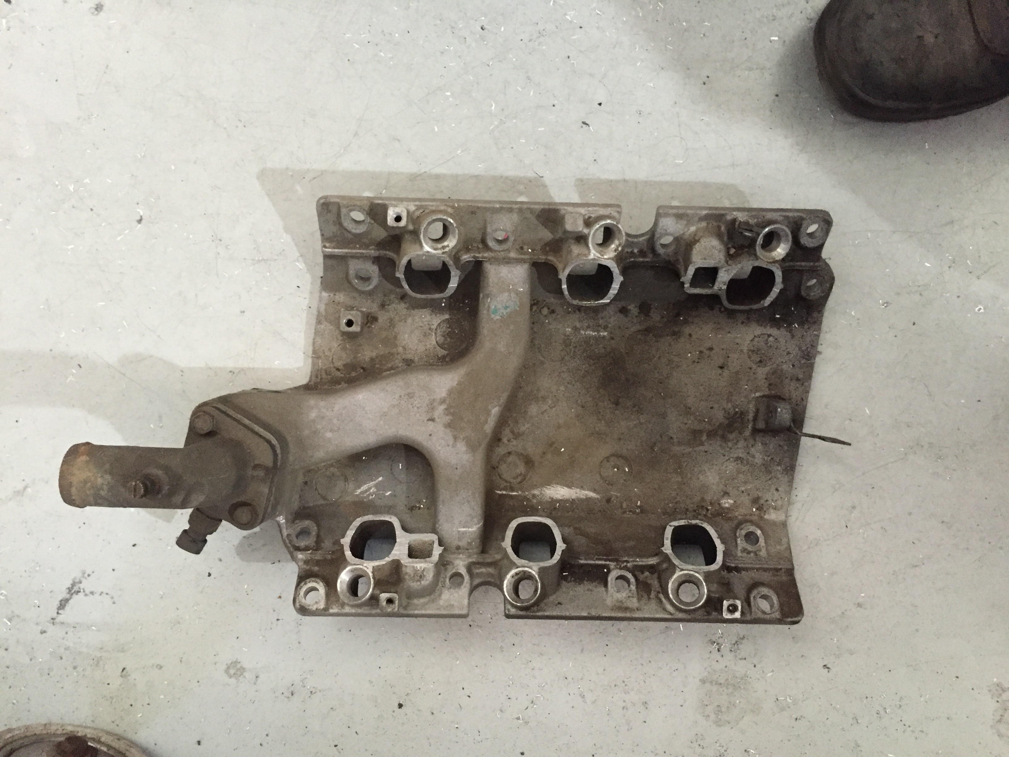

My factory manifold is pictured below (2000 Pontiac Firebird), which I haven't seen any direct comparison between other US manifolds. I 3D printed an adapter to test fit a 92mm LS style throttle body, which I would make out of aluminum. I'm thinking this is the US manifold you called the banana manifold: I might just go to my local junkyard and grab an aluminum FWD intake manifold.

The one you have now also isn't too bad. I read years ago an engine builder who raced a car like yours got something around the 270hp at the wheels with your intake.
You will need the lower section too and new runner insert/seals like this.
