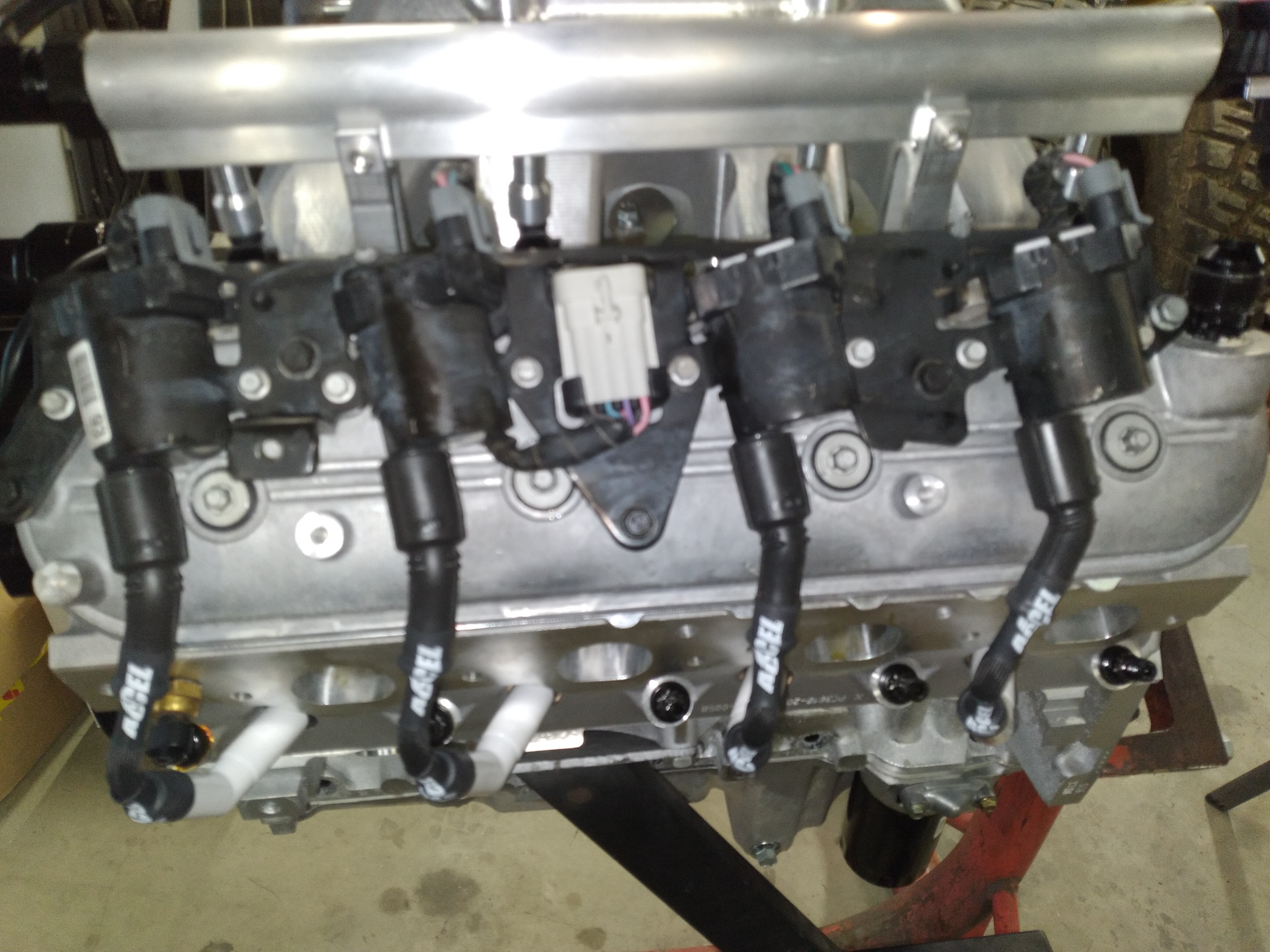

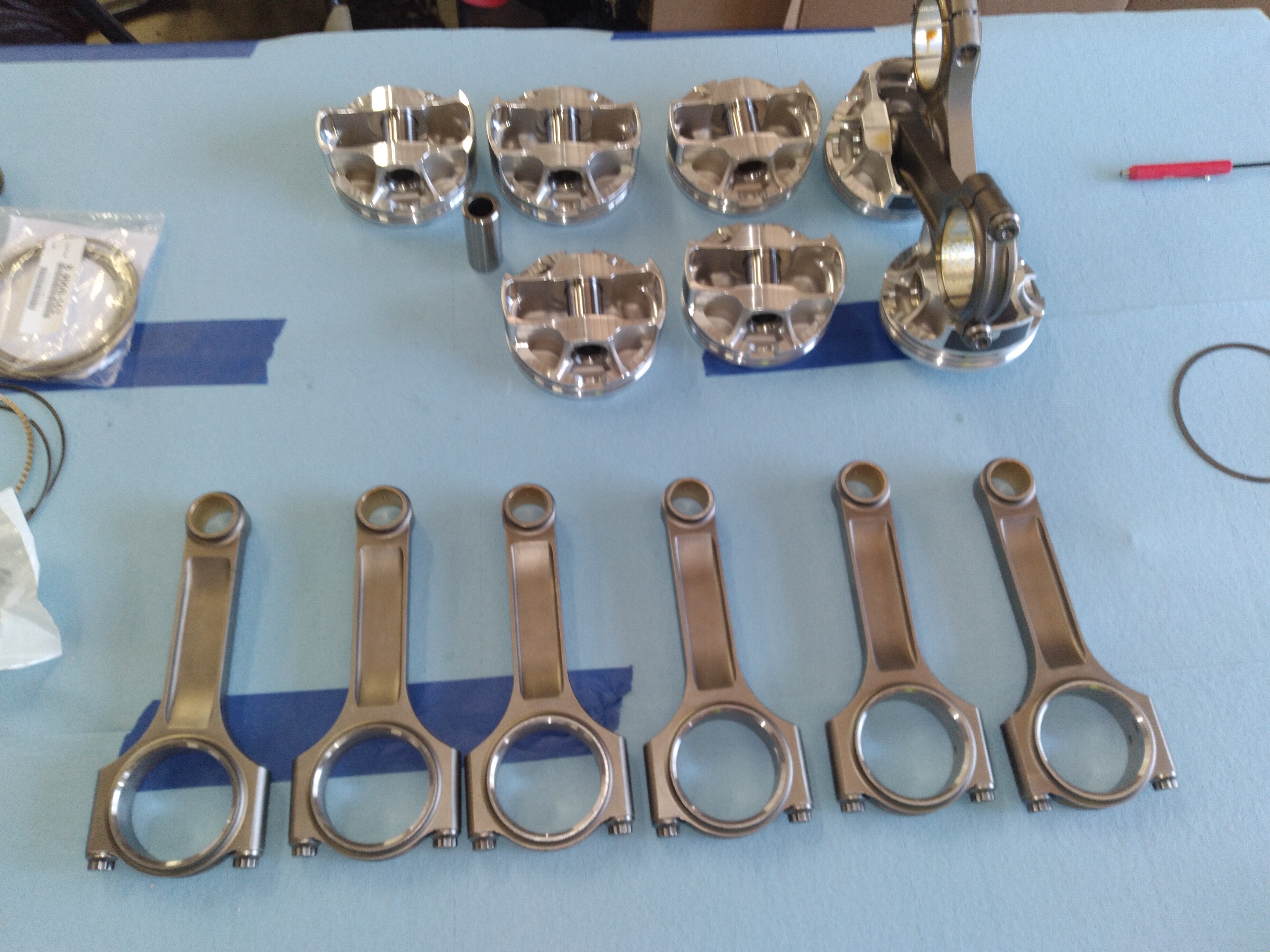

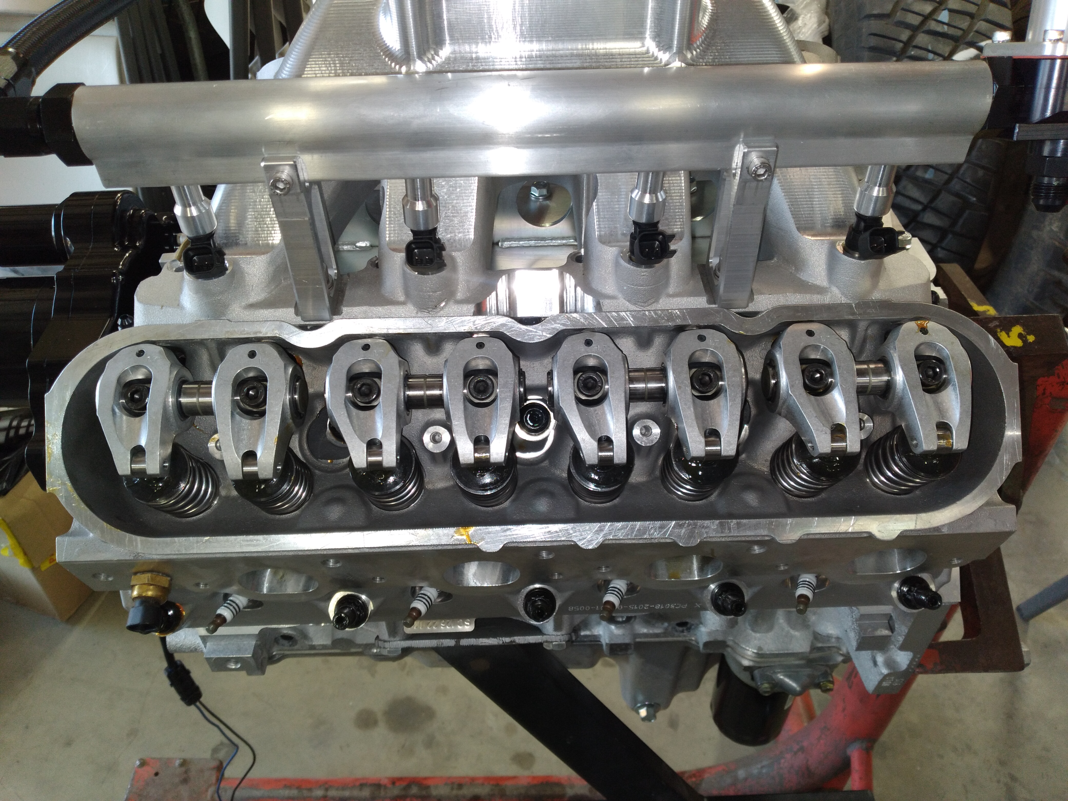

430 cu in LS 4.070 x 4.125
6.125 rods 11.6:1 compression AV gas Tuned open loop then the Delphi Mefi4B is closed loop wide band with fuel pressure safety/control/adjustment as well as oil pressure safety vs rpm. Yes, those are -12 fuel rails, the beauty of large rails is it helps absorb the harmonics of the injectors :D

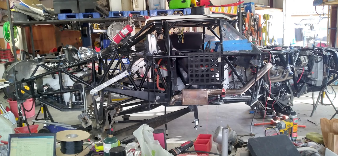

Any pics of the car??
In-Tech
Posts: 785
Location: California
Re: Off road race truck
Post by In-Tech »
Hiya, and thanks. I'll have to dig pics off of the phone but there is pics in the tiktok video if you can view, plus you will get some sound of the nasty :) It's right at 698 fwhp now. If I can get some real heads on it, it should be 800-825hp at the cranky

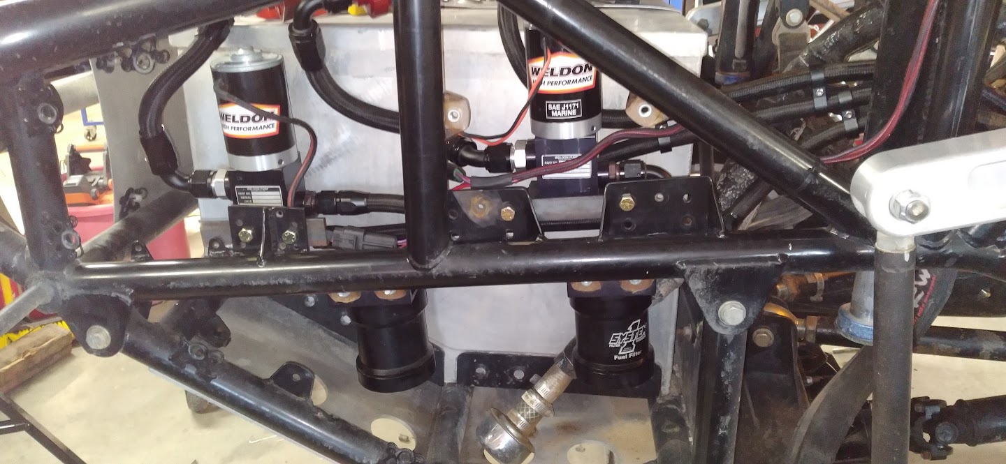

I couldn't find another db2015 so the backup pump is an overneeded db2025

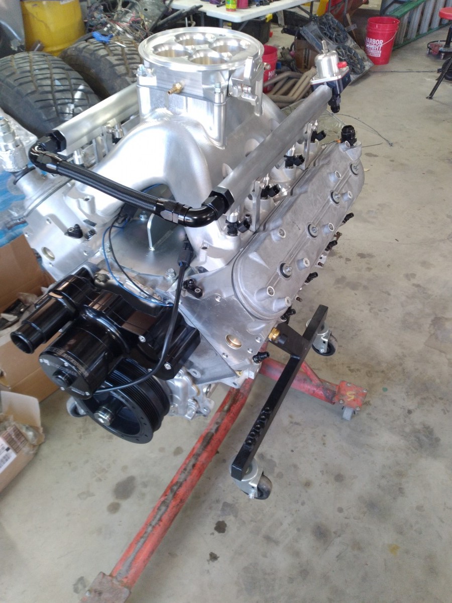

Posts: 8118
What cam has it got? I just noticed they look like hydr ones as the yella rockers aren't adjustable. This engine looks too serious to be using a hydr cam?
