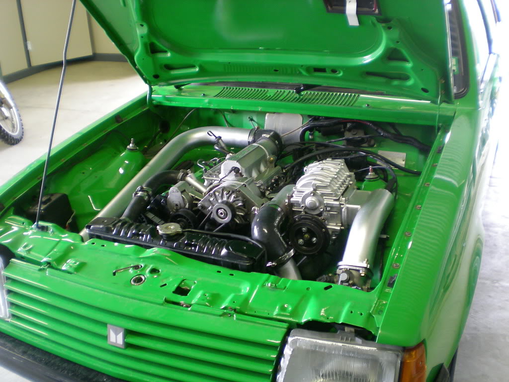

Selling a Holden Gemini with a Supercharged V6 3.8l commodore engine.

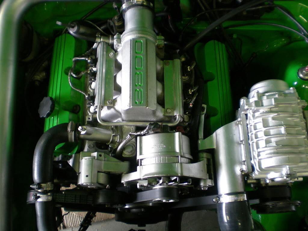

Engine: 1992 VP 3.8LV6 engine, new seals top to bottom last December. Supercharged at 10psi, intercooled 600x400 3” core, Holden supercharged injectors, large fuel pump, relocated throttle body and coil packs, 2 bar map sensor. Custom tuned Delco 808 ECU, large radiator, custom exhaust. Ready to hold 15psi if required. Can also include previous 2.5 psi, 5psi pulley and custom tunes.

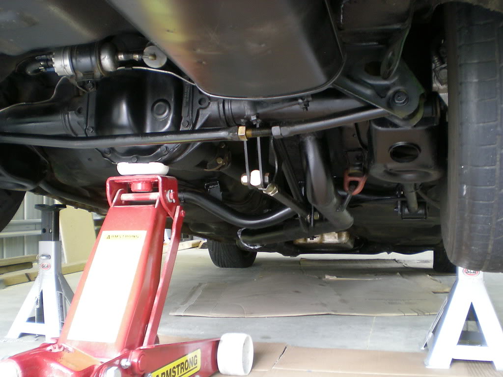

Rear end setup: Shortened VL Turbo diff, custom 28 splien axels, 4 pin LSD, 3.45 gears. Chrome molly ladder bar arms with full adjustable diff tilt and offset, integrated 2” tail shaft loop and floor supports. Heavy duty thick walled custom tail shaft.

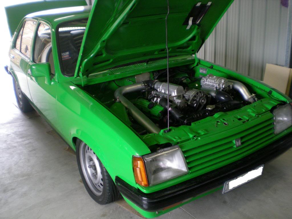

Body: Full restoration about 6 years ago (18 month restoration), finished in MIPA 2pack. No rust, no dints, no scratches etc etc. It is a TE with TG update throughout.

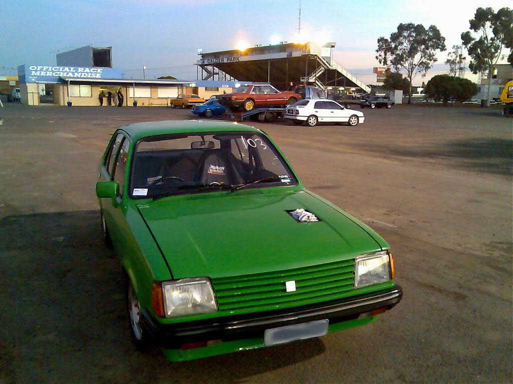

Performance: At it’s outing to Calder Park it ran an easy 12.5 on a conservative street tune and small 205 tyres. Ran a mid 13 on 2.5 pound, see youtube.
Will run quicker with larger tyres and quicker again with a more aggressive tune. An 11 second passes should not be an issue.

did you have any problems with rego with the ladder bar ?

Nope no dramas. The buyer is from ACT, so he did not require reg transfer. Will be visiting the engineers and the its off to summernats.. lucky bugger!!
