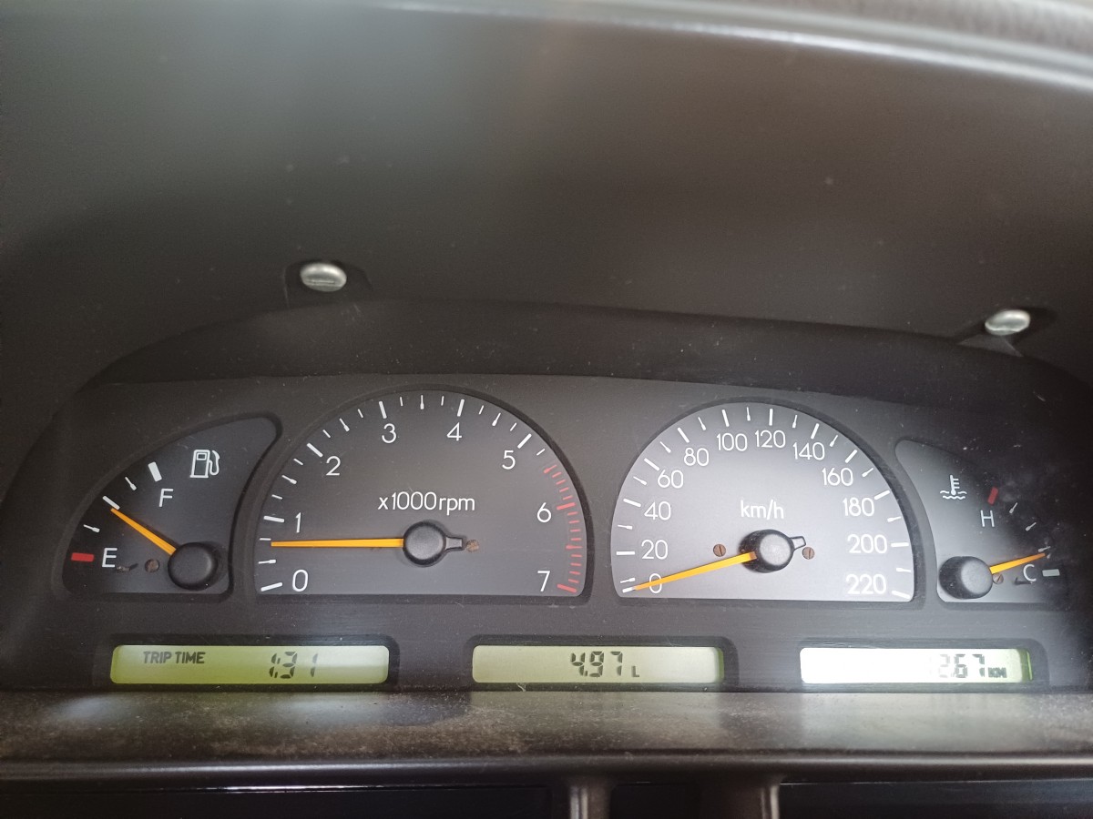

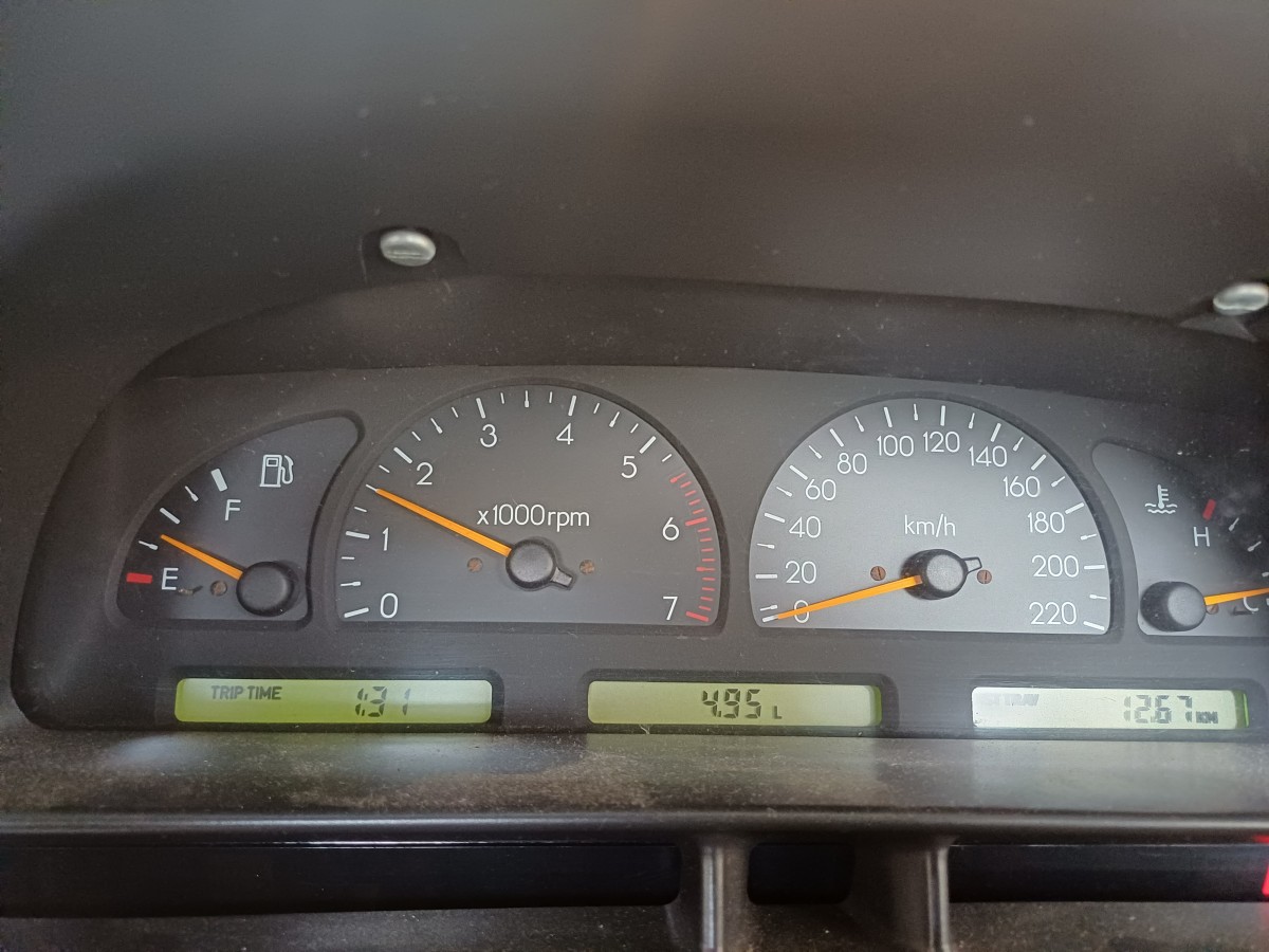

Today I had another look under the bonnet, tracing vac lines. Blanced off the hose that went to the vacumm tank to eliminate the possibility of a bad tank. During this time also spraying some carby cleaner.
Listening to the revs pick up some, then drop again.
Still unsure exactly from where.
Car starts fine, 1500rpm then would settle to about 800rpm and sound semi smooth.
I noticed when revs are coming down from 1500 I can feel vibration/roughness.
Mostly it will settle at 700rpm and feel rough
Photos attached
