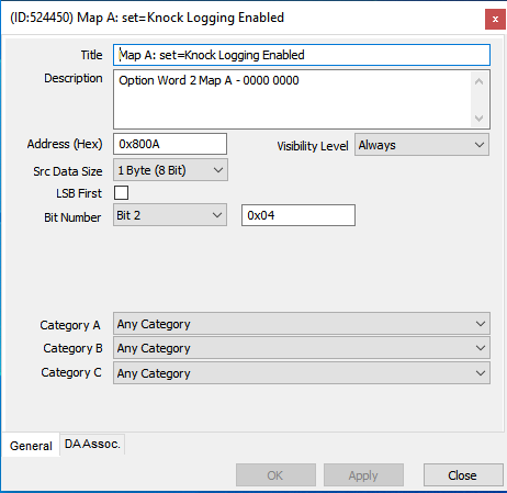

I don't think TunerPro can just change certain bits, but I believe it is a feature on the developer's radar.
- Posts: 10096
Re: OS 12598977 E40 2005 GTO XDF and bin files
It can do bits a a flag. We've been doing that since 2009 for option bits on the older systems. And you can document where more than 1 bit is required in the name. Examples:
