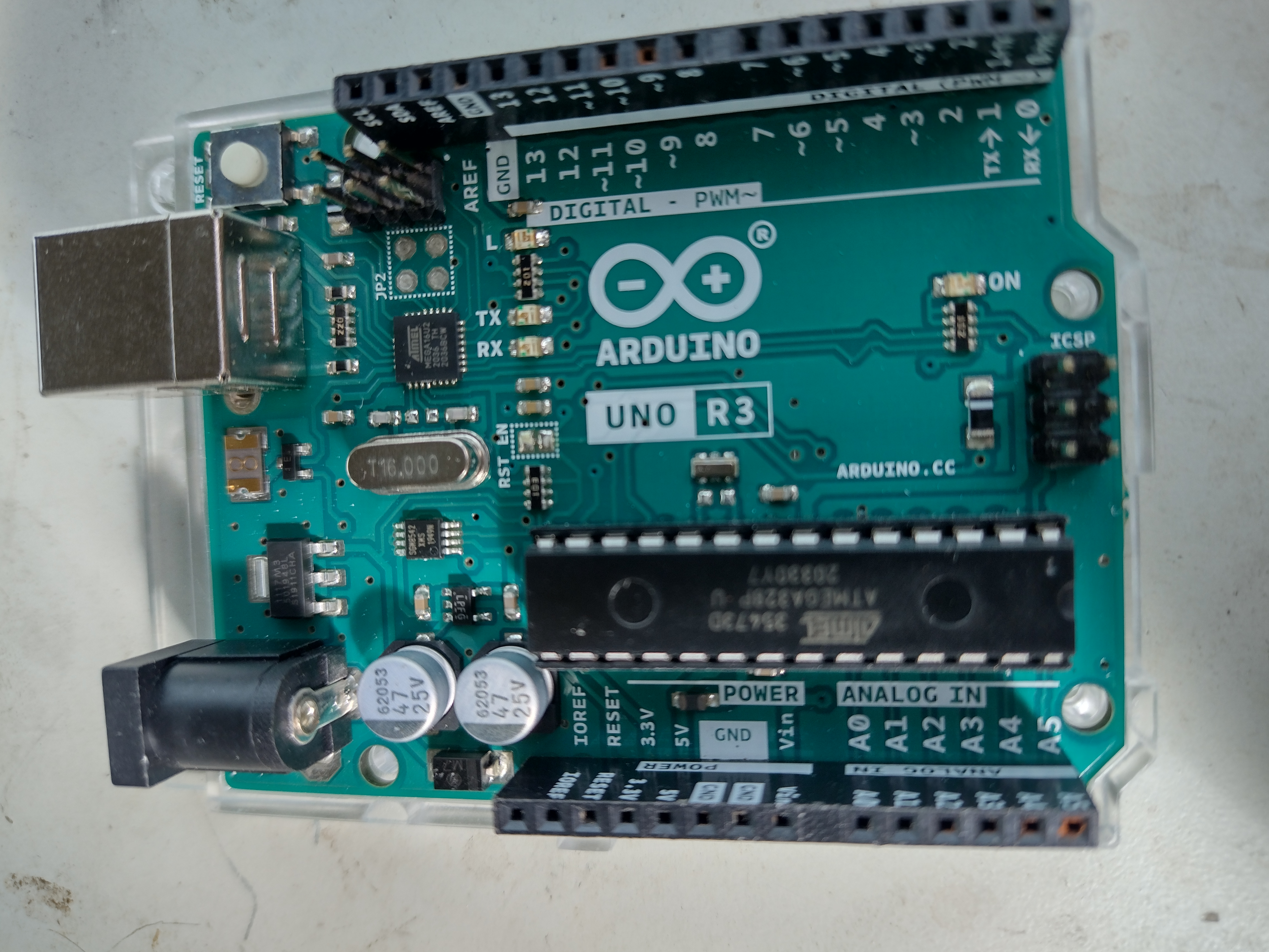

A set of refurbished XR6 turbo injectors arrived and with no dead time data that I could find (and what I did find is clearly incorrect), decided to put a few parts together to build up a 12P deadtime table.
You'll need
A fuel rail with injectors and reg
Fuel pump (If your fuel rail is out of your car, just use that - jumper the diagnostic port to keep the fuel pump on)
High sensitivity scales ($10 set from ebay, good up to 200gms)
A bench power supply to adjust the voltage to the injectors
An arduino
2 push buttons and a MOSFET (I'm using IRFB4110 because I had a bag of them, but just about any N channel MOSFET rated at 40v or higher, and say 20amps or higher will be fine - It should also contain a freewheeling diode )

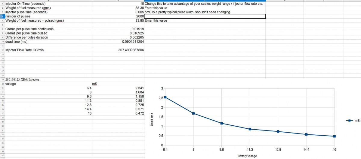

The aduino code is simple, two buttons, one will trigger the injector for a solid 10 seconds. This will give the flow rate of the injector and the fuel weight per second. The second button will fire the injector in 2000 x 5mS bursts. If zero dead time, both weights will match. Calculate the difference in fuel delivered, use this to find the injector dead time (or use my excel sheet). You can adjust the injector time and pulse number if you have super high flow injectors etc.
Repeat at whatever voltages the dead time table in your ecu needs. Only took 20min or so to run through all the voltages 3 times and we've got ourselves a very accurate injector dead time table.
DeadTimeFinder.rar
(688 Bytes) Downloaded 290 times
injector dead time calc.xls
(10 KiB) Downloaded 358 times

I will add this to my injector cleaning benches. I have done very little with arduino's. I think I have some uno's around somewhere. Which 'duino did you use in case I need to connect to different pins?

Yeah just a Uno, and an old shield proto board I found in the shed.
I can draw up what goes where If you like.
If you used normal sized tactile switches you could code in the option for various injection durations to cater for 100cc/Min up to 4000cc/min or larger/smaller.

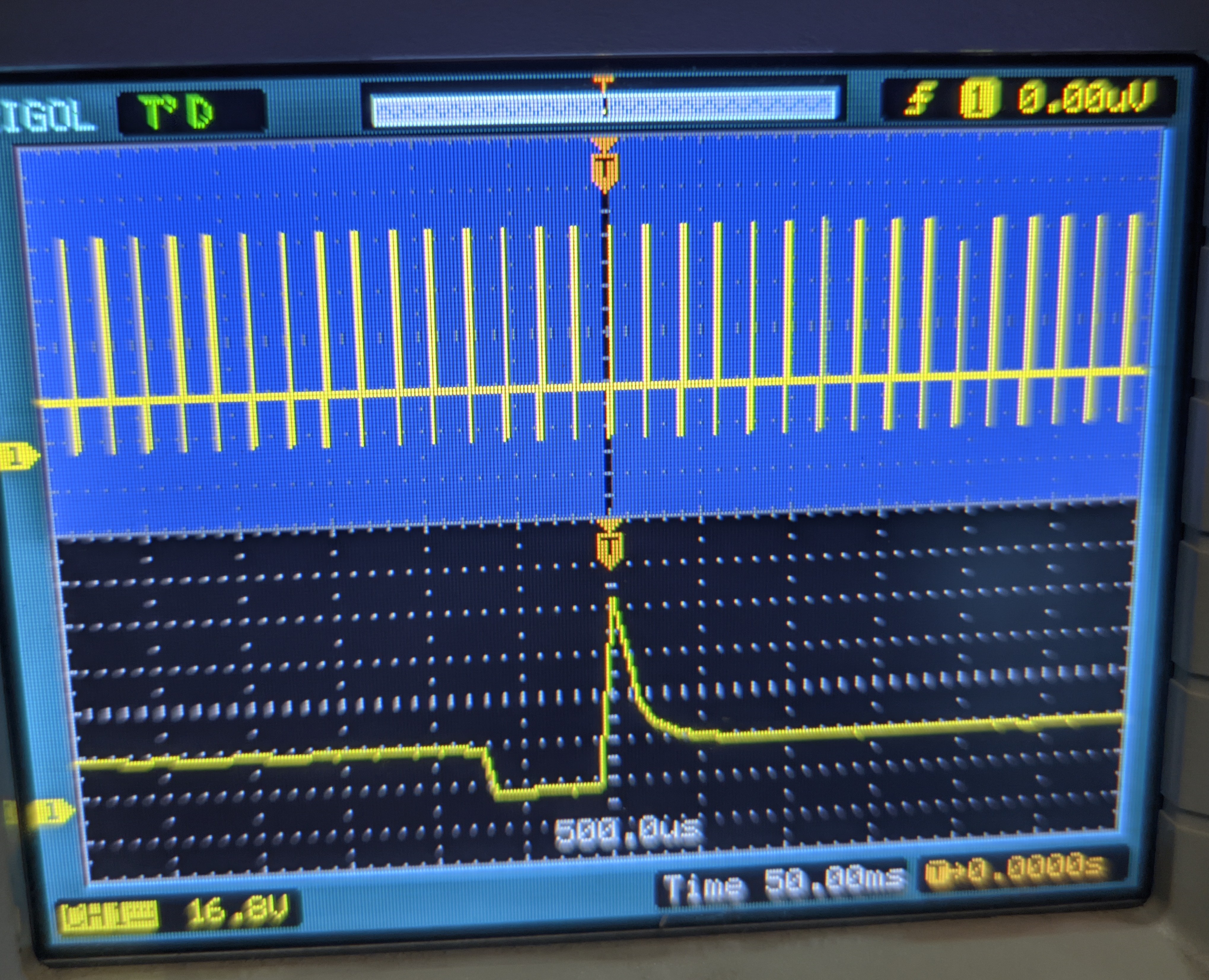

Easiest methods ive found is dribble test, run at a voltage, run pressure to spec, then increase pulse width until you get repeatable amounts, i use 10ml, most current gen injectors can do 5-6ml stability repeat, then go through each voltage range.
Other method is do the same thing but with scope hooked up and watch a wide range of the pulse, you'l see when the coil starts to become stable.
In saying this different ecu's all call deadtime different things unfortunately, but i think the main thing at a minimum is to have the same fuel output across the voltage range.
viewtopic.php?f=27&t=7214
Unstable
Stable

The1 so you're mapping the nonlinear and linear range of the injectors, not necessarily just the deadtime?
As far as deadtime goes, my method seems very accurate - I can switch between single and double fire and get an identical AFR both down near idle and under load which wouldn't happen unless dead times were dialed in.

Please correct me if I'm wrong, this is my understanding:
In 12p, the voltage offset IS the dead time table. Injector dead time changes quite largely with the voltage at the injector.
In double fire mode:
Commanded injector pulse width = dead time + BPW
In single fire mode:
Commanded injector pulse width = dead time + (2*BPW)
For example, if the dead time is 2mS, and BPW=3mS:
Double fire = 2ms + 3ms = 5ms every spark event
Single fire = 2ms + 6ms = 8ms ever second spark event.
The amount of fuel at the valve, every intake stroke will be the same in both modes.
If we get dead time wrong, let's use 1ms
Double fire= 1ms + 3ms = 4ms every spark event
Single fire = 1ms + 6ms = 7ms every second spark event
In this case the actual fuel delivered in double = 2ms and in single = 5ms ( /2 = 2.5ms)
So when ticking the single fire box you'd see your AFRs richen up significantly. This is a simple indication your dead time values are incorrect. I can confirm this is what happens in 12p.
The voltage offset table is simply a way the ecu approximates the dead time at any particular battery voltage.
Injector flow is a constant regardless of voltage, and assuming correctly sized injectors running in the linear range, independant or pulse width. A 10 second continuous flow will give an almost exact flow rate of the injector /min etc.
There is a second offset table in 12p to make the flow characteristics more linear when firing in the nonlinear region.
