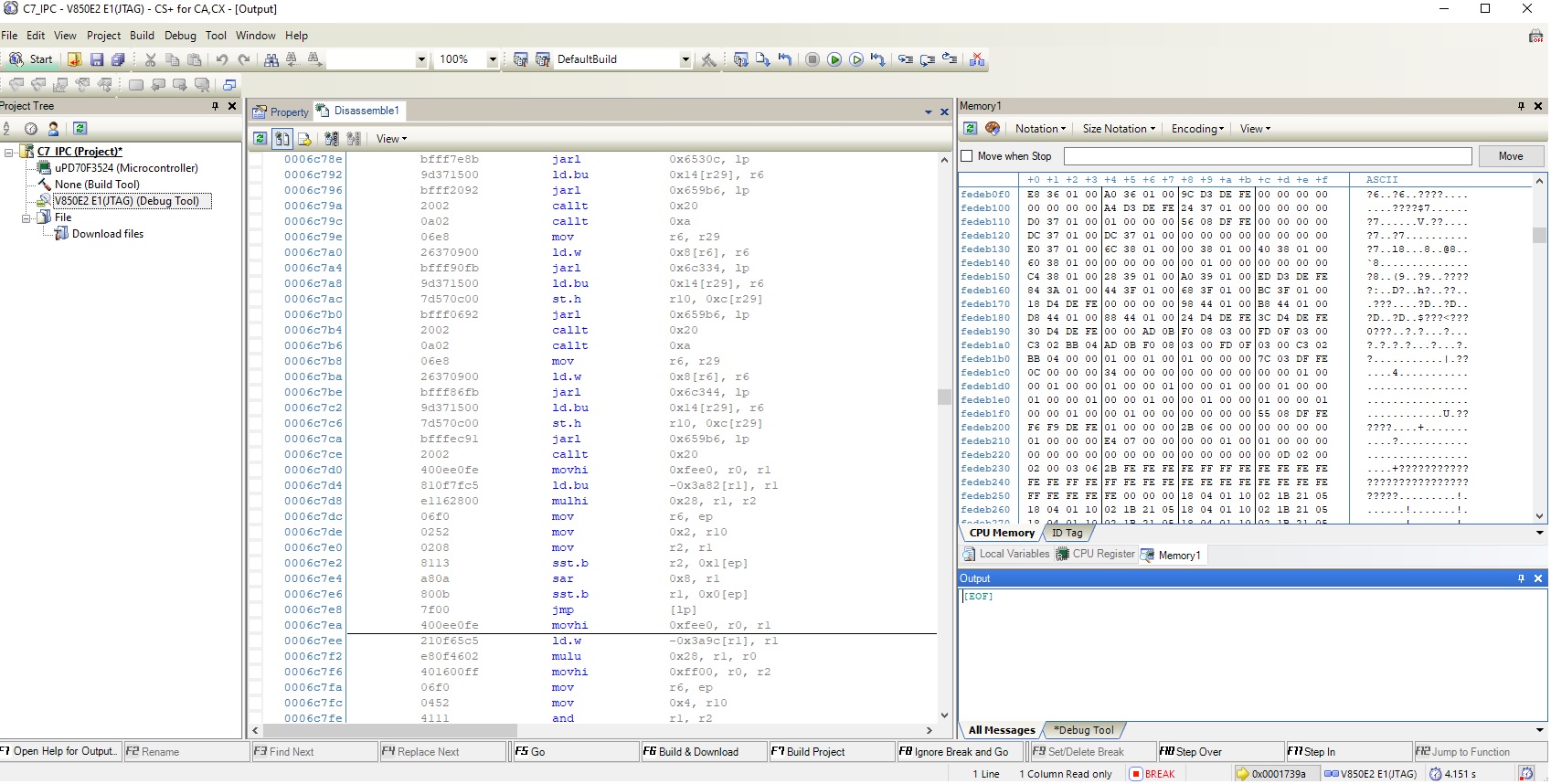

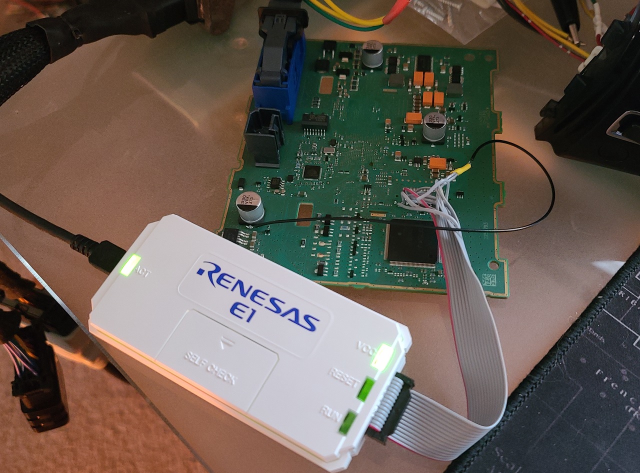

I can't believe this worked. My pinout was right and my horrible ghetto wiring actually worked. I've got full flash, memory and CPU register access. It dumps the full flash in seconds.

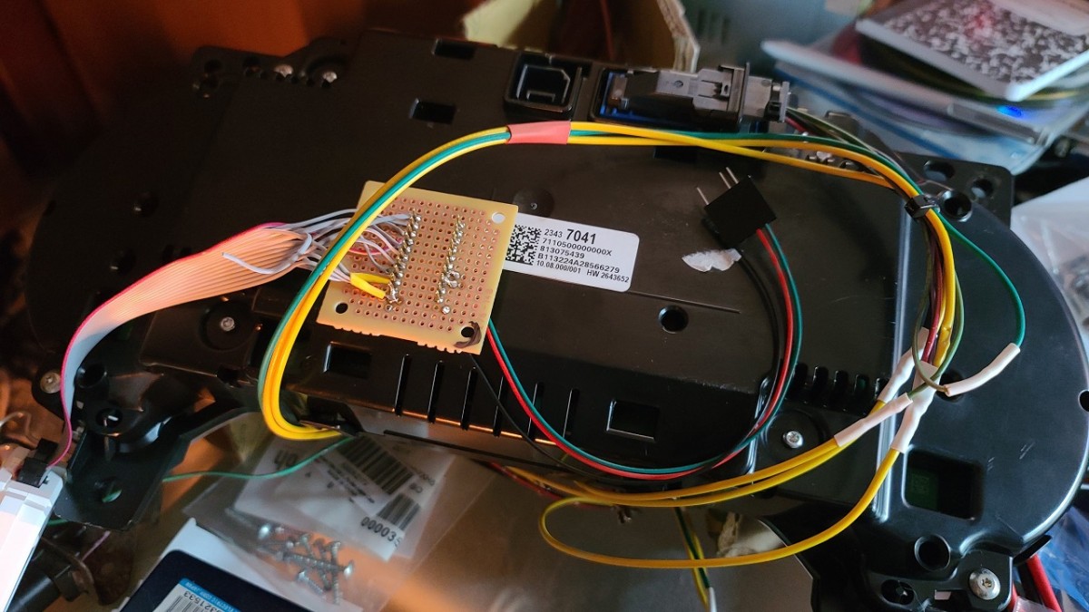

This is a donor board from a GM 8 inch LCD cluster. I don't know if this can be done with generic JTAG or not. Everything I'm using right now is the proprietary Renesas tools. I think my next step is going to be to rebuild this around a nicer jig that can be used with an intact cluster, and then see about getting JTAG access to the IMX processor that runs the LCD. I think that can be done with a Segger J-link.

Its actually nice seeing a decompile of the V850e2 that doesnt have errors/missing opcodes! Does it allow you to debug the processor and step through the opcodes 1 by 1?Gatecrasher wrote:I can't believe this worked. My pinout was right and my horrible ghetto wiring actually worked. I've got full flash, memory and CPU register access. It dumps the full flash in seconds.

Yep! I haven't figured out exactly how to do that yet, but the step and breakpoint functions are all there.
Ghidra has been pretty damn close so far. I've been working off of recombined SPS files up to now. This will let me double check Ghidra and give me access to the memory and registers as well. I've got the boot block now too.

I got the breakpoints and stepping working. This is so cool.

Your last two posts have made my day.Gatecrasher wrote:I got the breakpoints and stepping working. This is so cool.
I know what my next purchase is going to be

Decided to make this a little less ghetto. I took some measurements and 3D printed a pogo pin jig that fits into the back of the cluster housing. I'm pretty sure this is how Visteon would have programmed these during manufacture. I was really lucky that the PCB contacts used exactly the same spacing as generic perfboard.
It was tedious as hell getting this thing assembled without breaking the pogo pins. I'm even worse at CAD than I am at writing code, and there's enough slop in my printer that everything was a really right fit. But somehow, miraculously, it actually works. I dumped another cluster without opening it. I've also got the serial console for the IMX chip hooked up and working. If I can get flash access to the IMX, this thing will be completely jailbroken.
