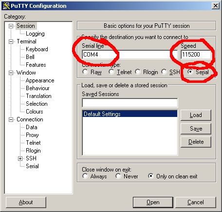

PuTTY is simple ... The three red encircled settings are the only important ones,
Set the "Serial Line" to whatever COM port the device is installed as.
Set the "Speed" to 38400.
Select the Open button ...
If all is well (you may have to hit enter) you should get a prompt like,
They call that the AT prompt ...
Type ATZ and hit enter, you should get back the ELM version.
If you do not, reset PuTTY and try with a different baud (Speed) rate.
Once you have a clear connection to the device ... Set the default baud to 115200 at the AT prompt, follow each with the enter key, you should get OK in response.
Example:
AT PP 0C SV 23
AT PP 0C ON
Restart device and test.
Leave Windows port settings alone, they need no change, they are basically ignored.
