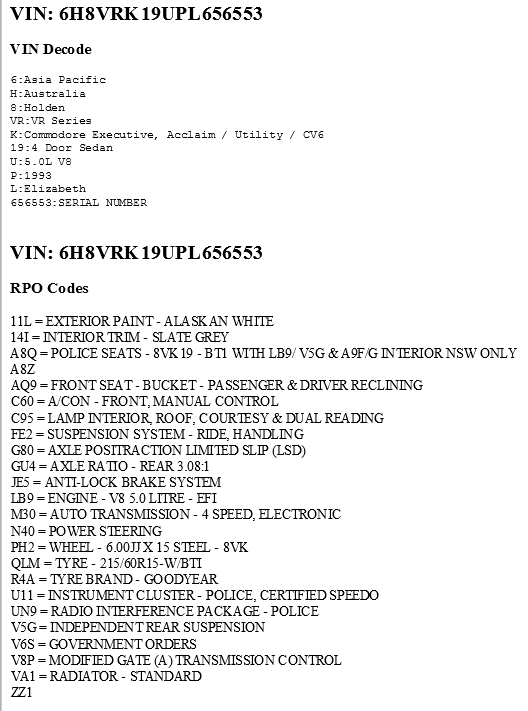

post or send me a full vin and I will get all RPO options for it.

kur4o thanks this is the full VIN 6H8VRK19UPL656553.
It's got IRS, ABS and FE1 suspension. Also the little things they did for the Police model like removed the gate lock on the selector and the small light for the speedo so you can drive with the lights off (why I don't know) and the 2km/h speedo increments.

Can you check the number for typo. It is listed as invalid. it does have some digit that verifies integrity.

Charlescrown wrote:I checked and that is the VIN. I had a look in the original owners handbook and it also confirmed that VIN.
My system indicates it is:
1993-1995 Commodore Executive Sedan Police
Engine Type:
Engine Serial Number: VU616583
Paint Code (Lower Body): 11L
Paint Code (Upper Body):
Retail Date: 08/27/1993
Sales Type: 03
Interior Trim Code: 14I
Transmission: A
Dealership Name: (-630) Suttons Motors Arncliffe - Arncliffe
Series Code: VR
Pack Code: BT1NSW

Thanks Tazzi.
Yes that is the car and has helped me identify it.
