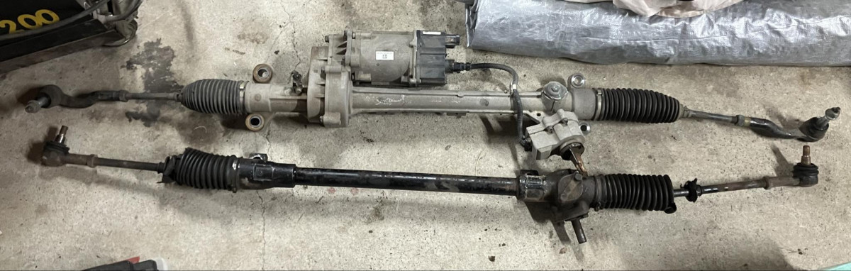

Anyone looked into using these for other cars?
They obviously have canbus comms to them, so would probably need to have some sort of box to talk.
I've got 1 from a wreck, if someone wants me to log some data directly.
VF Commodore Steering Rack

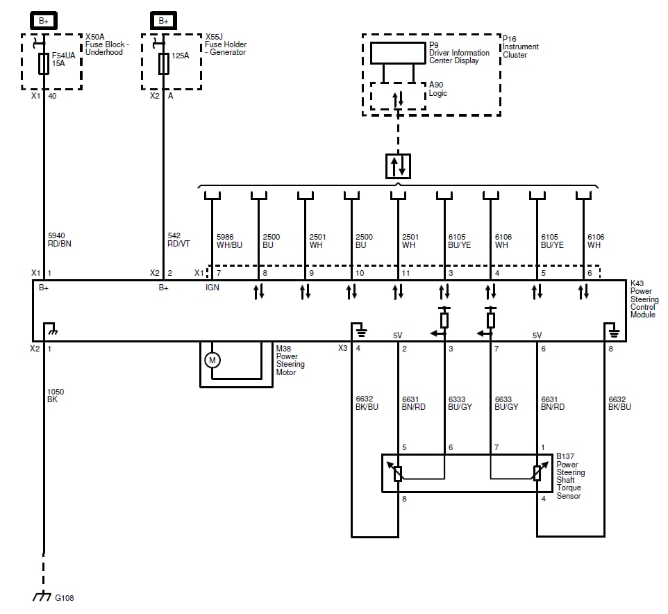

Yeah I've looked into this abit. Looks like it uses 2 separate canbus circuits. One on the main to get a engine and vehicle speed from and one on the chassis canbus for steering angle. No idea if it needs the steering angle to work in another car. I looked into using the controllers for the opel corsa d canbus electric power steering but I doubt the can ids would be the same but with gmlan been semi universal across the gm range it's a maybe.
Re: VF Commodore Steering Rack
I'm keen to get this to work and happy to help if / where i can, and i have a daily driver VF SV6 i can use if logs are needed as well as a rack on the bench that if i can get it to work i want to fit to my Bedford Van.
The first bus i scanned i believe is the main bus ECU etc ... it basically sends these two over and over.
IN ts: 333541921 id: 148 l: 1 data: 00
IN ts: 333541937 id: 778 l: 7 data: 00 00 00 00 00 00 00
IN ts: 333542921 id: 148 l: 1 data: 00
IN ts: 333542937 id: 778 l: 7 data: 00 31 00 00 00 00 00
IN ts: 333543921 id: 148 l: 1 data: 00
IN ts: 333543937 id: 778 l: 7 data: 00 31 00 00 00 00 00
The second bus i believe is the powertrain bus ? ... and this is what its sending out.
IN ts: 421358765 id: 335 l: 4 data: 70 07 00 00
IN ts: 421358781 id: 335 l: 4 data: 00 00 00 00
IN ts: 421358796 id: 335 l: 4 data: D0 0D 00 00
IN ts: 421358812 id: 335 l: 4 data: A0 0A 00 00
IN ts: 421358843 id: 335 l: 4 data: 70 07 00 00
IN ts: 421358859 id: 335 l: 4 data: 00 00 00 00
IN ts: 421358875 id: 335 l: 4 data: D0 0D 00 00
IN ts: 421358906 id: 335 l: 4 data: A0 0A 00 00
Now if i simulate an RPM signal (0C9) to it i get changes, i believe the 148 ID is a status output like 00 is all good 01 is a fault ... but this is just speculation.
OUT ts: 333672203 id: 0C9 l: 8 data: 00 0C 43 00 00 00 00 00
IN ts: 333672968 id: 148 l: 1 data: 01
IN ts: 333672968 id: 778 l: 7 data: 00 31 C1 26 00 93 00
OUT ts: 333673203 id: 0C9 l: 8 data: 00 0C 43 00 00 00 00 00
IN ts: 333673968 id: 148 l: 1 data: 01
IN ts: 333673968 id: 778 l: 7 data: 00 31 C1 26 00 93 00
Same result if i send a vehicle speed frame to it ... i tried this because i know my Holden Cruze electric power steering started working after it got to about 3-5km rolling with engine off!
sending the two above frames to the powertrain bus didnt have any effect to the can data coming out.
Schematic just for reference. I am hoping to soon scan the VF powertrain bus and see what that shows ....
my hope is if i can find all the frames to send then i can make an arduino type do-hicky to read rpm and road speed, then convert them to CAN and send them out along with whatever other stuff it needs to work.
i am also assuming that the steering wheel angle sensor is on the column but i havent got one of these to test yet....
it also seems that alot of the stuff in te GM LAN Bible doesnt seem overly relevant to VF's ? alot of the CAN ID's i've seen i cant find in it, makes sense though, previous models didnt have electric power steering.

I reckon a lot would transfer over to the late colorado steering rack too.
I just googled it and I'd say your spot on, the motor mech and connections look identical!
