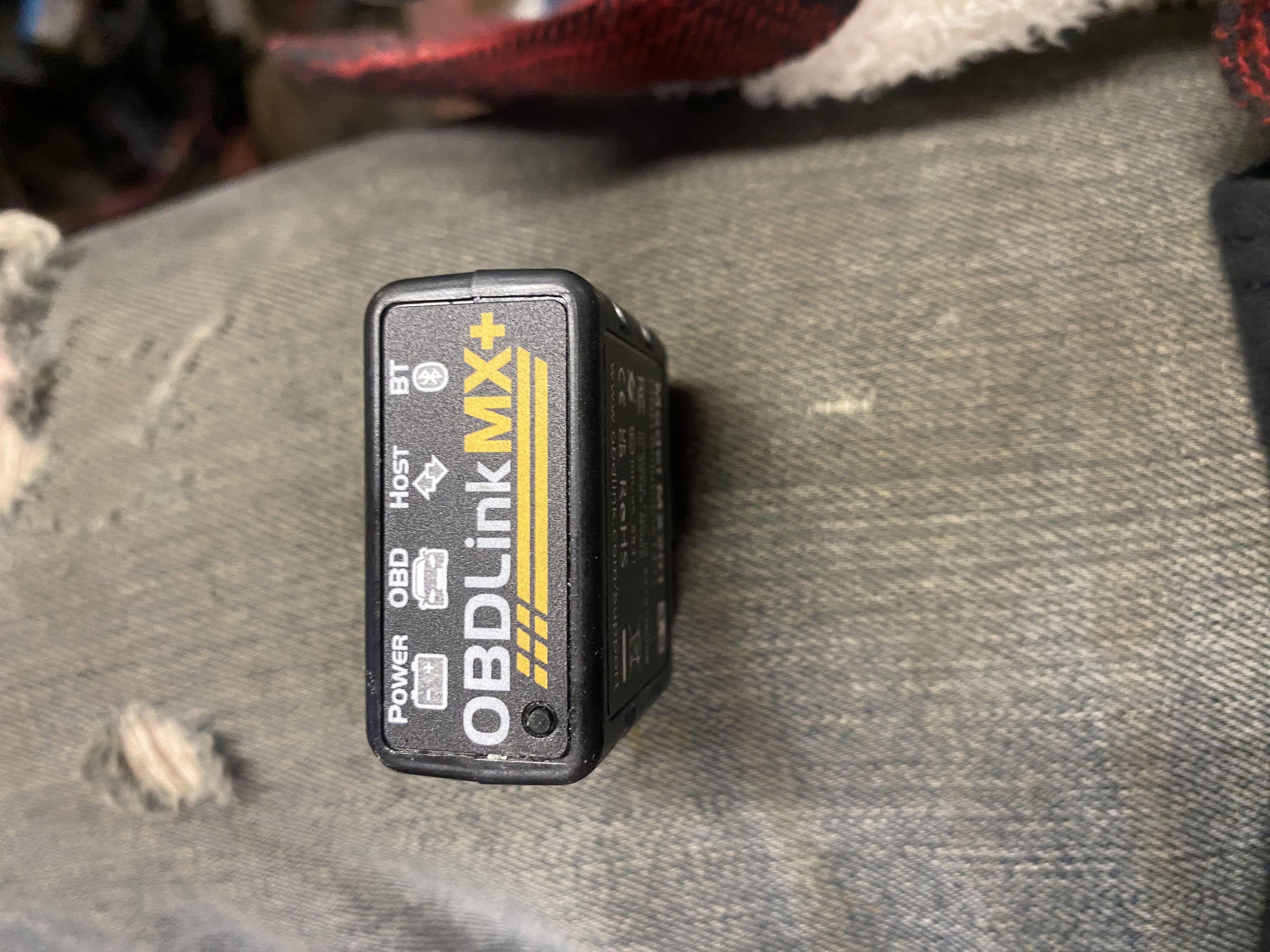

OBDLink MX+
Keeps showing this one is not supported.

It won’t let me use it at all I’ve tired all day. Should have just bought the corded one only got this because it showed it works with ford to. But I seen others posting that the OBDLink MX+ worked for them but that was 2 years ago.

Yeah shows 2 coms but only one will connect just to say this scan tool device is not supported. And com 4 just freezes the software. Guess I’ll send this one back.
