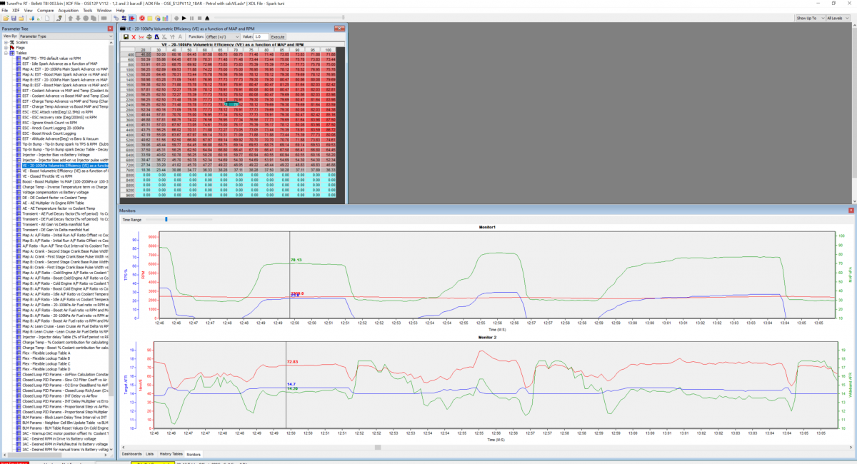

Or even better, if you have wideband is overlay Wideband AFR and Target AFR in the monitors, open your VE tables and turn on bubble tracing, then playback your logs and look for areas with the widest gap between target and actual afr that are not in deceleration areas. You can turn on CalcVE too and even though CalcVE is not accurate enough to automate you can see at a glance where the worst fueling is, and what the VE should be in that area. Then you can work on the VE table in that spot, smooth the changes in by hand or with the smooth function and repeat. You can cycle through tests and changes a lot quicker than waiting for STFT or LTFT to learn something.
Ive attached an example of how I would set it up. Note that this is just loose files from my PC, in this example the fuel is already pretty good and the bin is a different revision, so the actual numbers in the VE dont match the log, its just for illustrative purposes. The green wideband is pretty good over the blue target AFR, you'd be looking to target areas that are worse than this if you know your tune is out.
I put MAP, TPS, and RPM in the top monintor and look at fuel in the bottom one. The top one lets you see whats going on at a glance so you can take decel in to account and ignore those areas and you can see where you hit the throttle and sanity check the MAP at a glance too. Sometimes I'd overlay coolant temp too so you can see where it gets up to temp in your drive and ignore the cold area if you started logging with a cold engine and hit the road but you can easy check that on the dash or data view as well and obviously it doesn't change fast.
