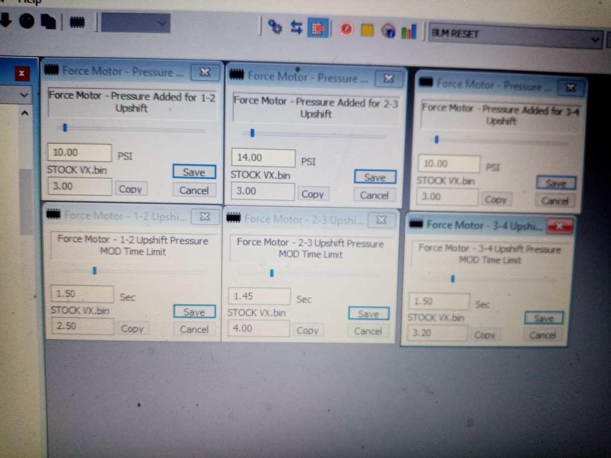

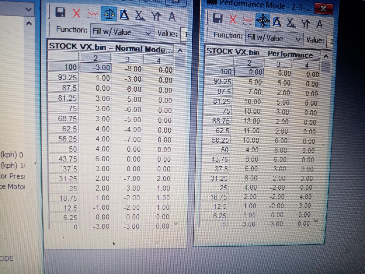

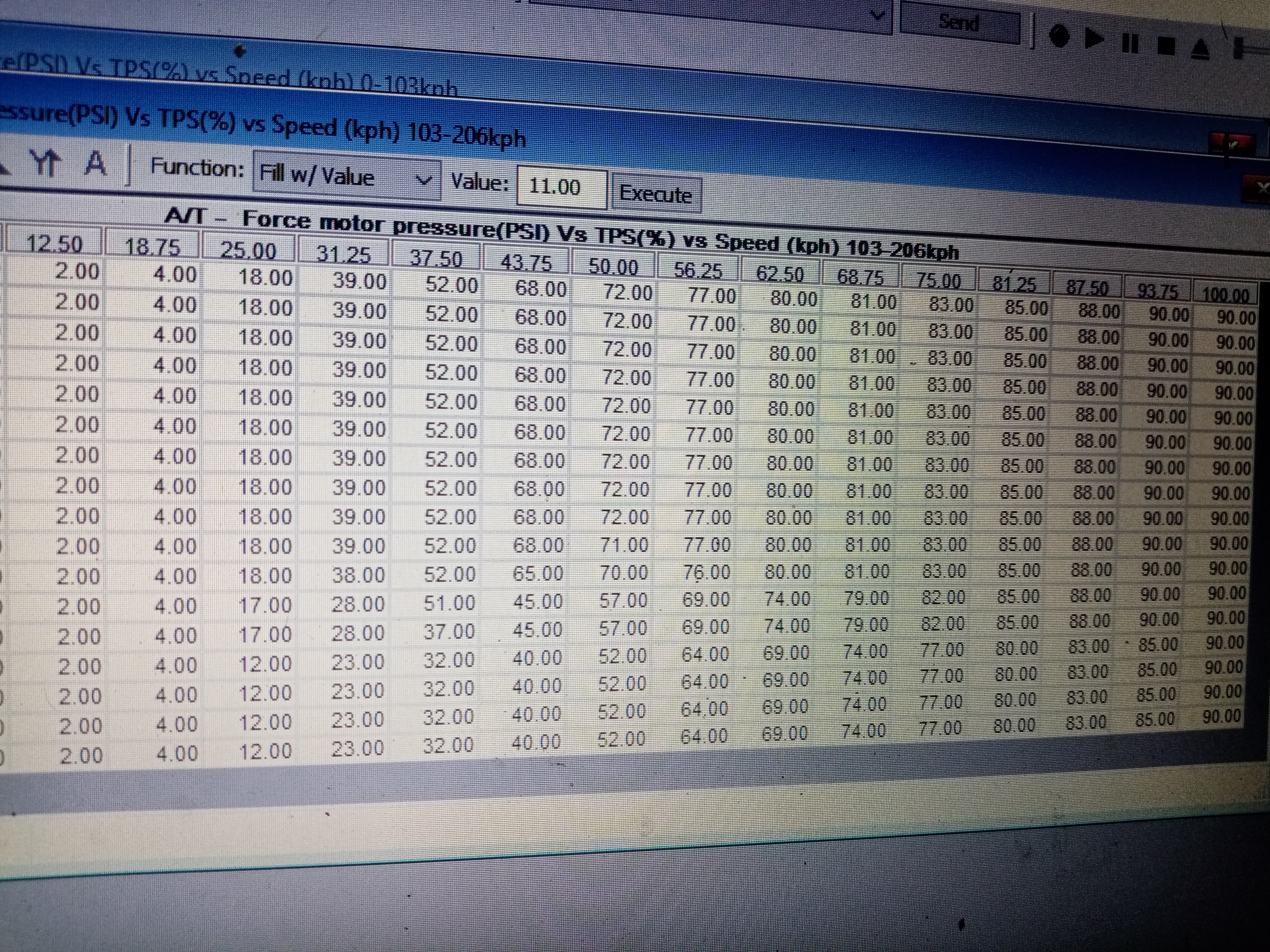

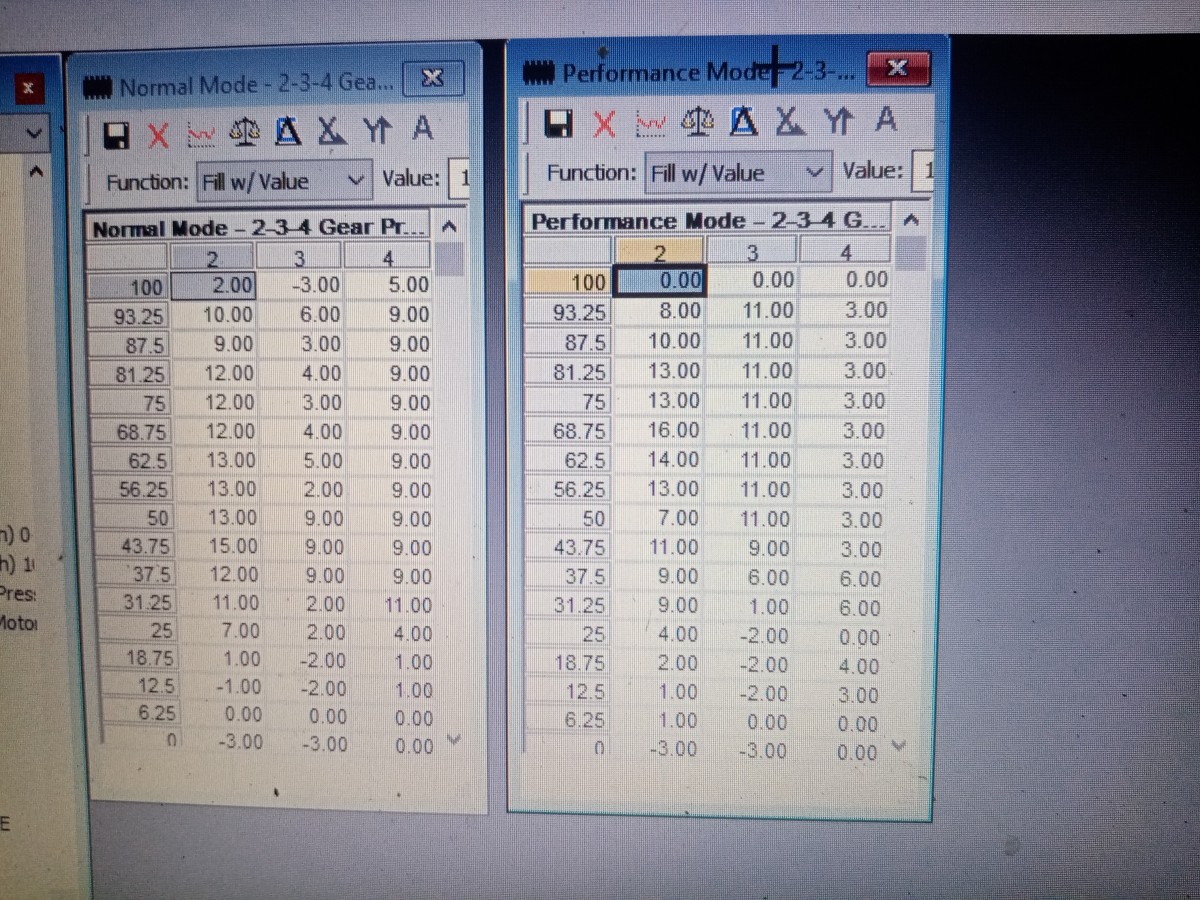

So these are the mods I have done to line pressure hoping it will improve the gearbox shifting can anyone see any issues before I take for test drive tomorrow

OK guys it's stopped the gearbox from slipping and now will change under full boost pretty happy with how it's going just going to make shift time a bit quicker down to 1sec see how it feels
