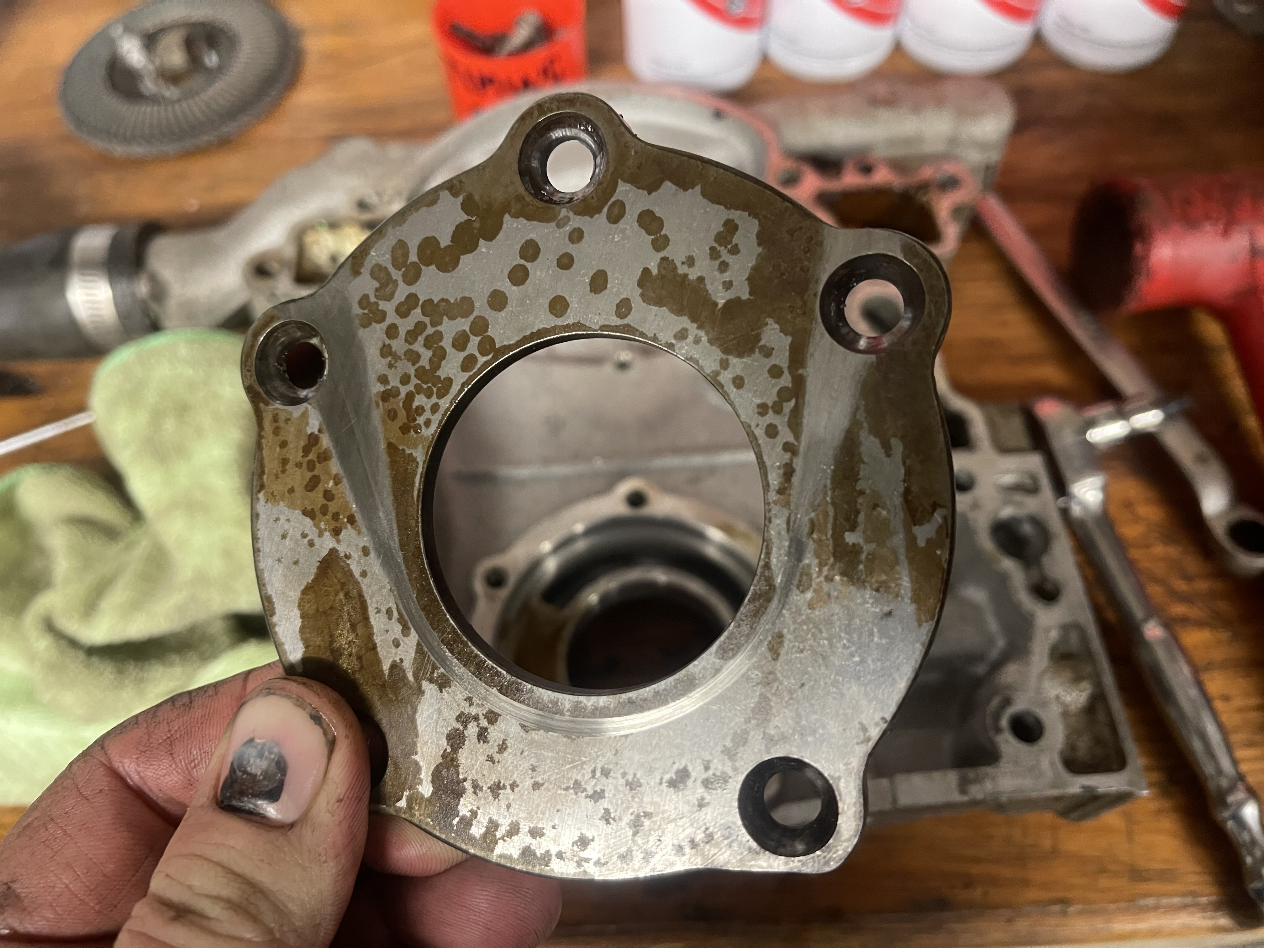

Re: V6 Timing chain questions.
The double row ever so slightly rubbed on my oil pump cover, more like polished. Check out the corrosion from the E85!!

That was a standard oil pump cover from memory wasn't it?
What was the chain like? looks a little stretched going by the marks.
