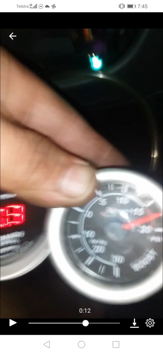

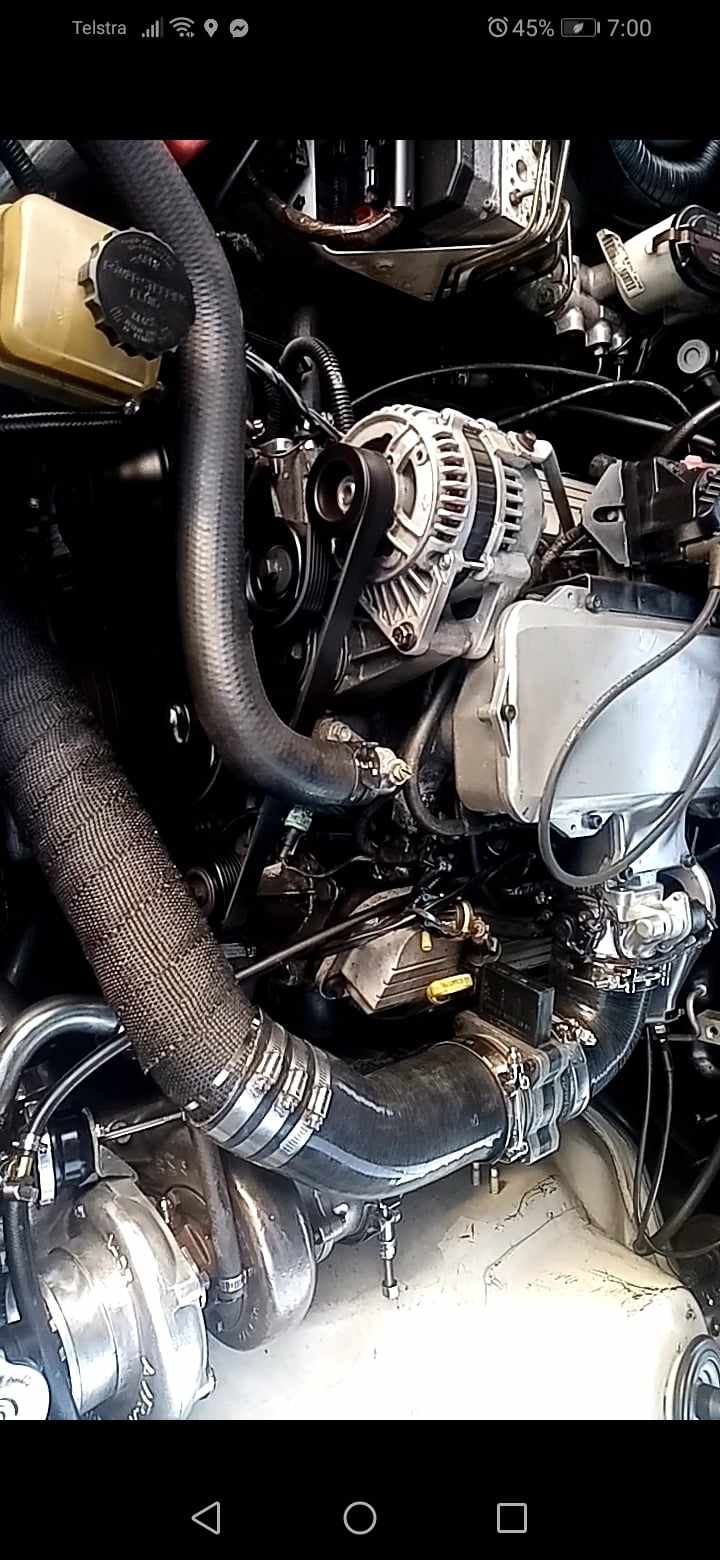

hi guys pretty new to tuning and have been tuning my wh statesman v6 ecotec with a turbo on the side turbo is 1.06 rear and .70 frot garrett exhaust 3in back yard job 600 300 76 intercooler all 3in piping 380lph pump
question are when do i need to upgrade maff as i want to run more boost in stock motor its loving life atm
what the max u want to be running on dead stock motor im at about 15psi at full boost but bleeds back to around 13psi

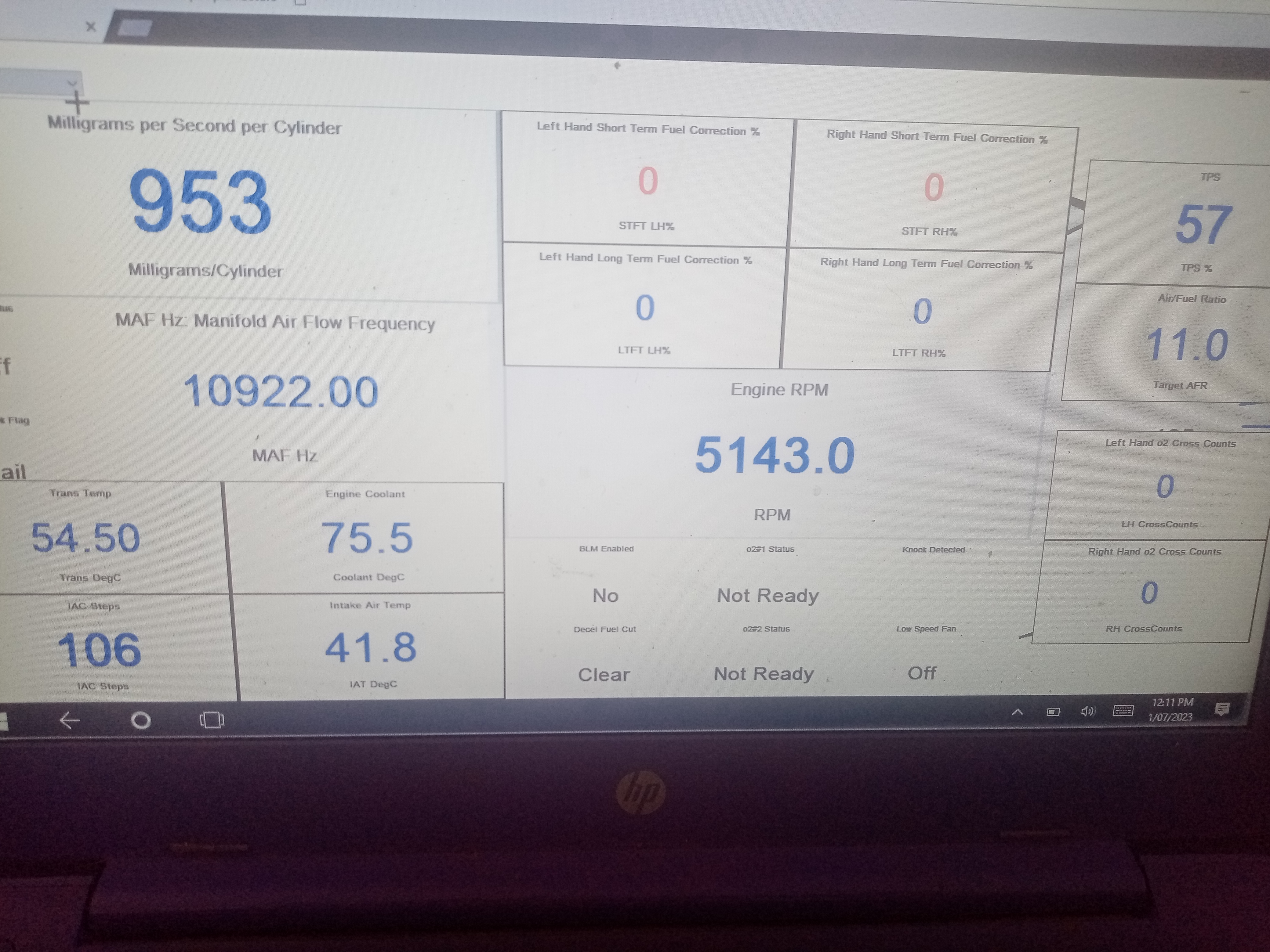

I haven't looked at your log but from the looks of your screenshot, your maf is at max or very close to maxing out. So You should be looking at getting a larger maf or card maf and piping to suit.
As for knock. Is it pulling any timing (not sure if you have a knock board) in certain areas? If so just remove timing in those areas of your spark table till there's no more knock.

You are definitely at the end of the range of the MAF.
I would avoid knock at all costs on stock ecotec pistons under boost, those pistons are reasonably weak. Have you opened up the ring gaps? If not keep it rich to keep it cool.

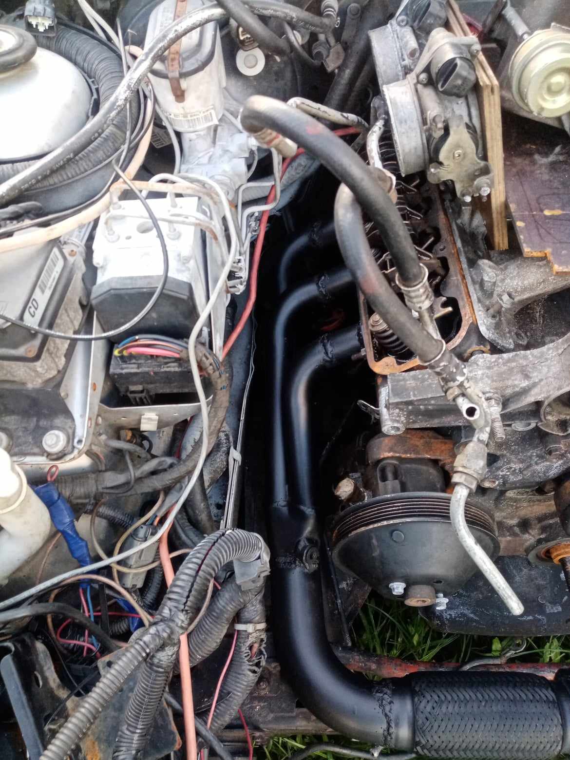

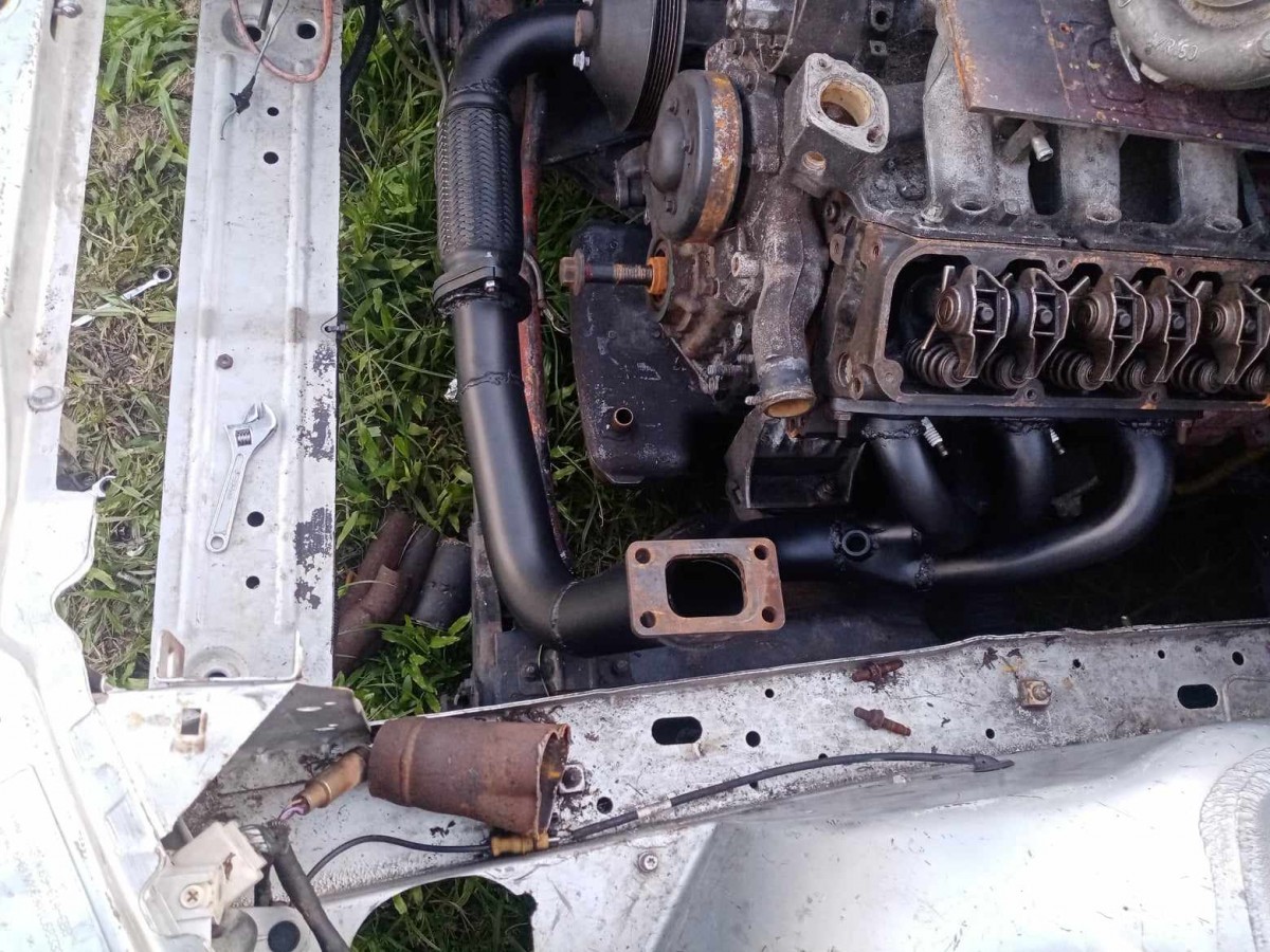

It's been a fun advantager so far having done everything myself from building manifolds exhaust.
injectors are 3/4 length from a barra with vz Injector plugs had no injector data because bought of facebook so had to guess a lot of it that was the first big hurdle turbo is a barra turbo with a. 70 front housing and a diffrent front impeller. the tunning side of things has been a huge learning curve being I don't know what to do and it's all trail and error tunning gearbox was relatively easy.

When maff is maxed out dose it just run same timing and fuel from that point on because it maxed was thinking just add more fuel keep timming the safe and just go blind past maff settings
Posts: 3820
cars: VS,VT,VX,VE
Re: help with tune
tobydog wrote:When maff is maxed out dose it just run same timing and fuel from that point on because it maxed was thinking just add more fuel keep timming the safe and just go blind past maff settings
With the enhanced code it still keeps working as The1 extended the working range of everything. You'll note in your screen shot the Milligrams Per Cylinder Per Second is showing 953, factory code is limited to 850 so you can see even though it's probably not seeing any more air (MAF hz) it knows through increasing revs that it's getting more air and adds fuel etc so as long as you've put put the right timing into the tables at the appropriate areas it'll be safe.
The1 will be able to explain it better how it all works.
