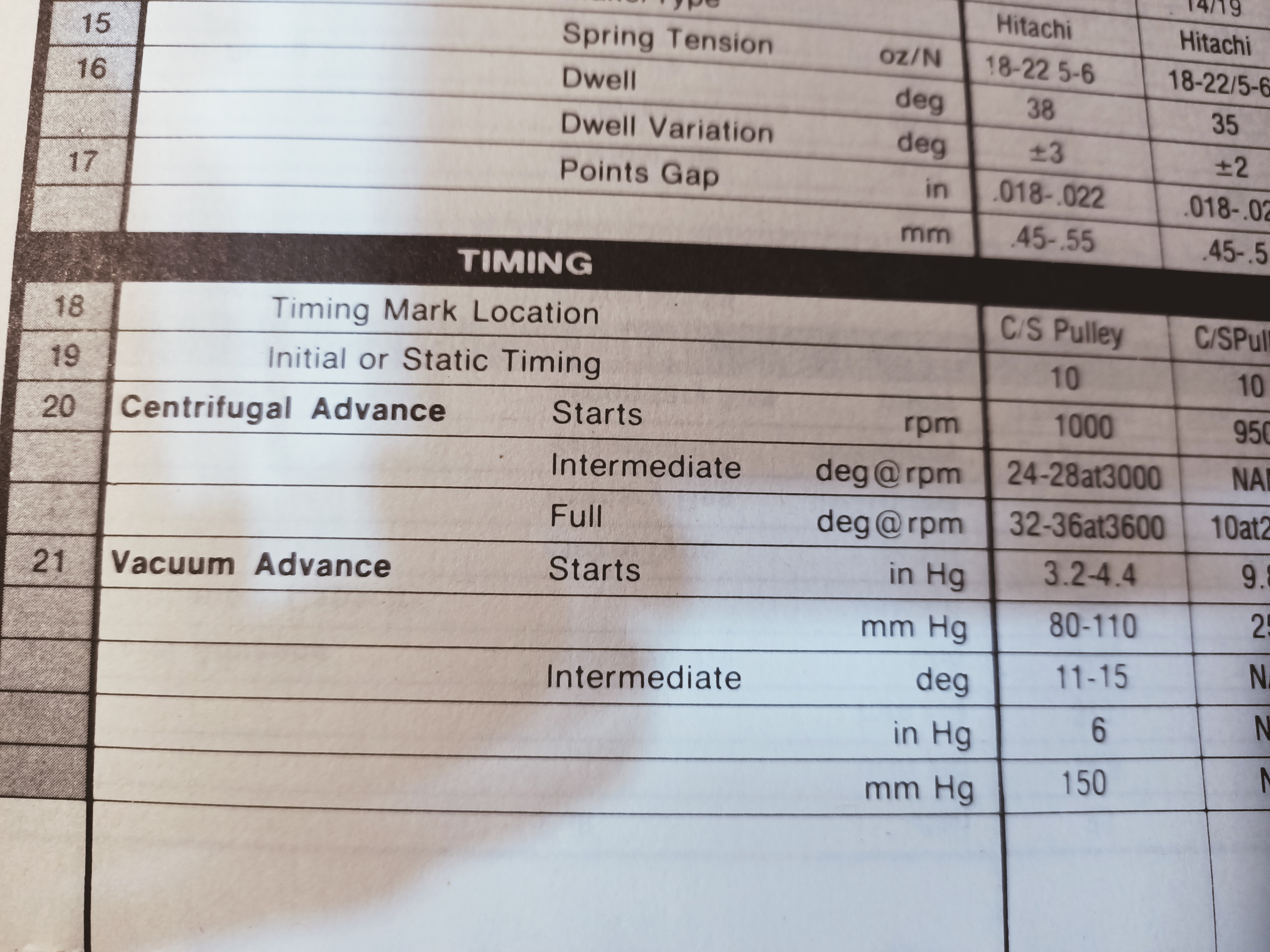

Iv made a map i think is right but under low speed loaded it dose get a bit unhappy ill need to work out timing off a carby one
- Posts: 2076
- cars: V8 VR Commodore BT1
Re: Nissan tb42 timing map
I have used the carbie advance curves to determine a reasonable map the added a bit in the lower rev range. I don't think the old mechanical was very good over the rev range. Probably add around 5-6 dgrees up to 1200 rpm then follow the mechanical curve then add what the vacuum advance would have in the higher vacuum area. Probably about 15 dgerees. Was that engine was used in 4WD Nissan Patrol?
These figures might help.
