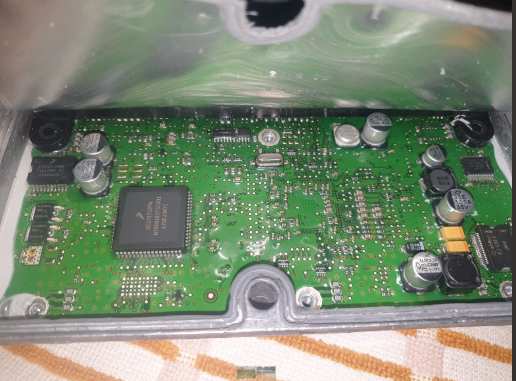

So, I jumped back onto this project, opened up a AP232 PCM and boy they glued the fucker down! as I want to see the bottom side of the MLB to also.
There is a test point pad i see but need to know each test point pinout, don't look like standard BDM pinouts like on other ECUS.
Anyone opened one and removed PCB? Too hard to remove without damaging the board. There has to be solvents to dissolve the silicone.
Looked at the Semiconductors from what i can see, MCP, Fan driver, Canbus transceiver.

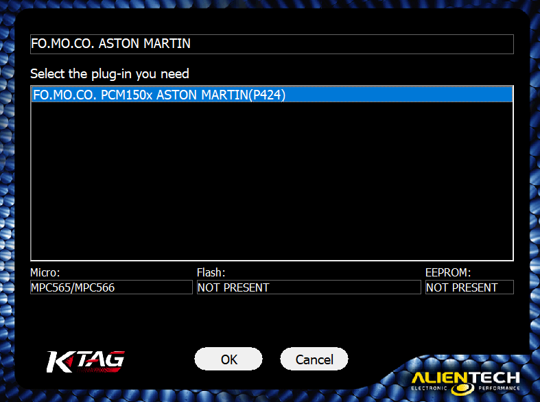

Looking at KTAG, the closest i can find is the Transit TT9 which are Visteon's with the same diag pad, but different ECU or BDM MPC for FoMoCo Aston Martin

Since removing the MLB deemed challenging. I decided to use the BDM contacts to see what can be retrieved from the PCM via KTAG.
based on the pin outs seen from another car. I was able to communicate but, it seemed the ECU cannot be identified (makes sense) but managed to extract the binary.
based on this PCM model, it doesn't seem the PCM has an external flash or EEPROM embedded like other variant ecu's. Pretty much its behaving just like Kess or other flash tools to extract the binary.
