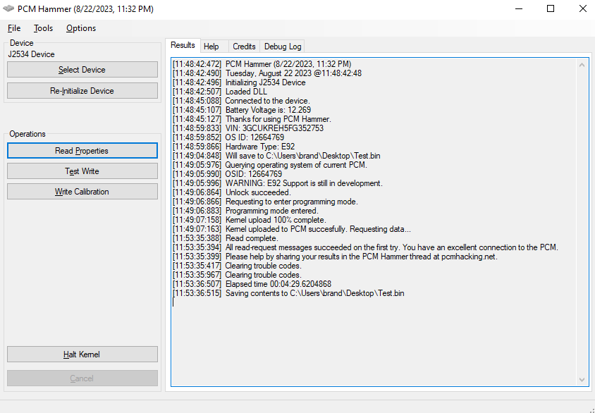

Re: PCM Hammer - CAN BUS Communications
I'll just leave this here...
There is a lot more work to be done and lots of hacks were done to make this happen.
Nice work!!bubba2533 wrote:I'll just leave this here...
What was the packet size used for reading? Looks like it took about 4minutes to complete.
Ok, I'll try to clean it up a little more then I'll push my branch.antus wrote:Very nice! Happy to provide feedback if you want to share a public or private (while in experimental form) branch.
I am planning to overhaul some of the way the data is stored and provided for PCM types, so it'd be good to take this in to account, and even start on that side of it to strengthen can bus support.
Thanks!Tazzi wrote: Nice work!!
The packet was 2,060 (0x80C) which I noticed, but I didn't dig into it.
It looks like that's because of line 64 & 65 from "PcmHacks\Apps\PcmLibraryWindowsForms\Devices\J2534Device.cs"
this.MaxSendSize = 2048 + 12; // J2534 Standard is 4KB
this.MaxReceiveSize = 2048 + 12; // J2534 Standard is 4KB
Also, I just realized I left the ECU powered on all night and the kernel was still running...so I guess that's good.
