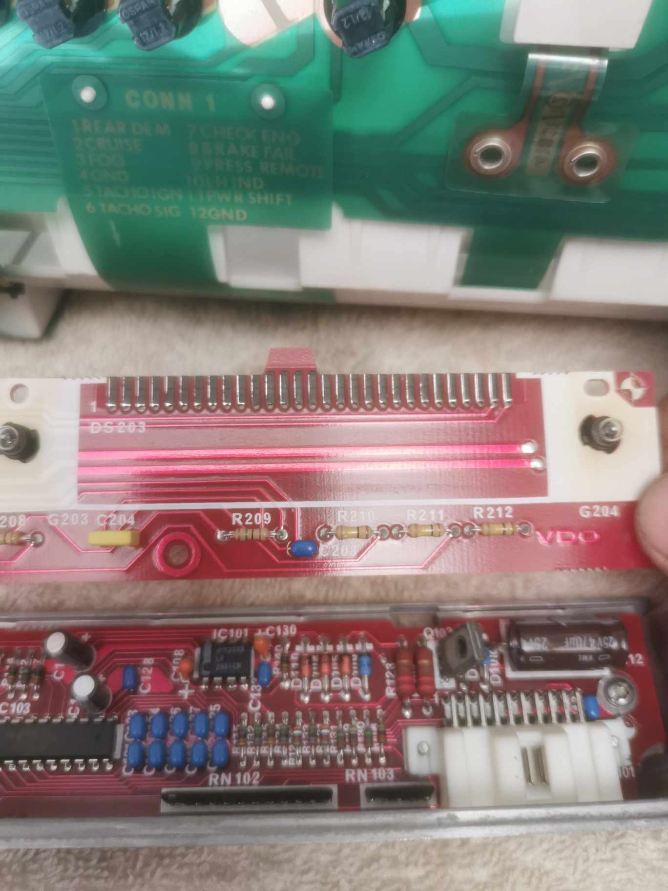

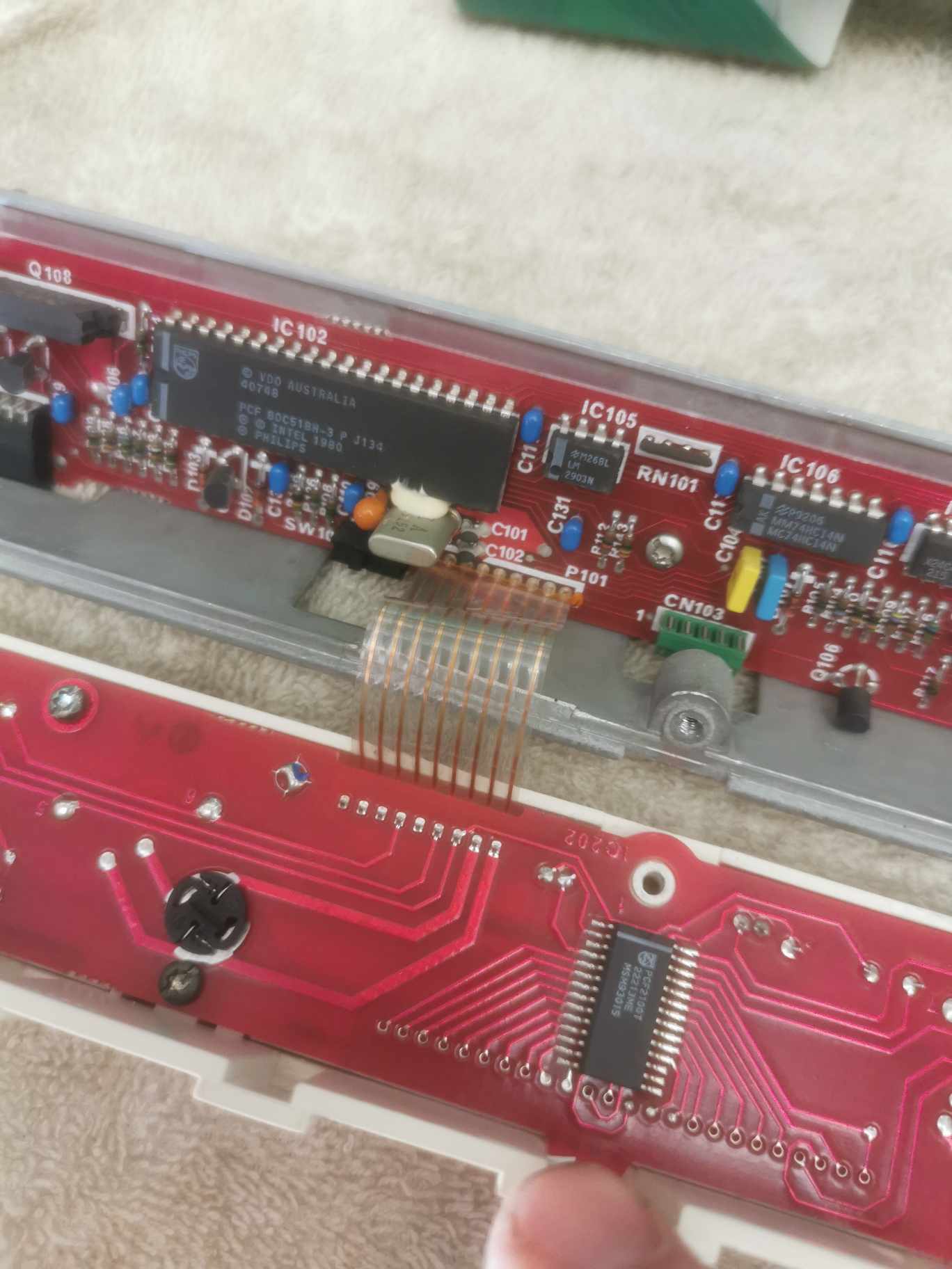

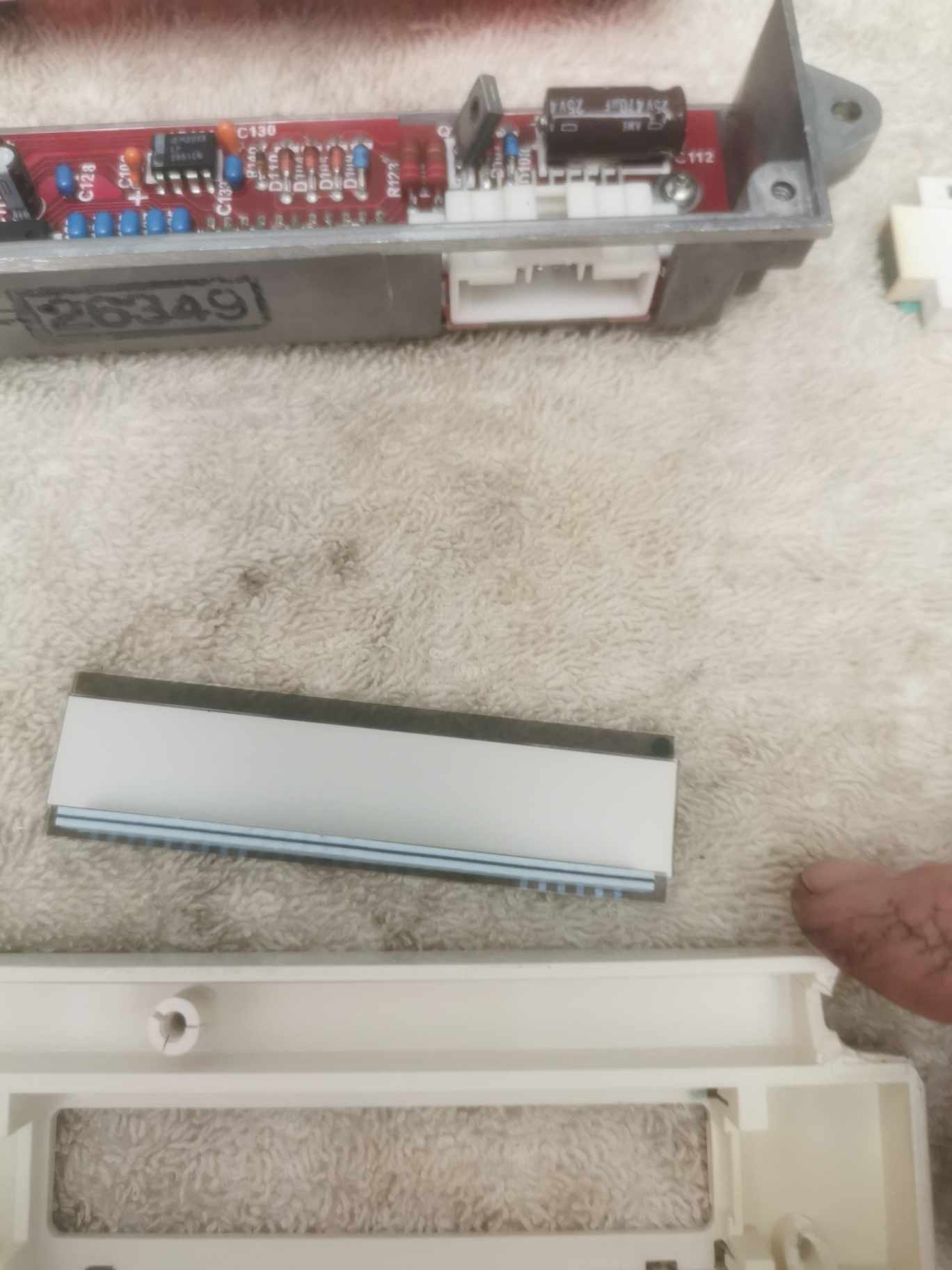

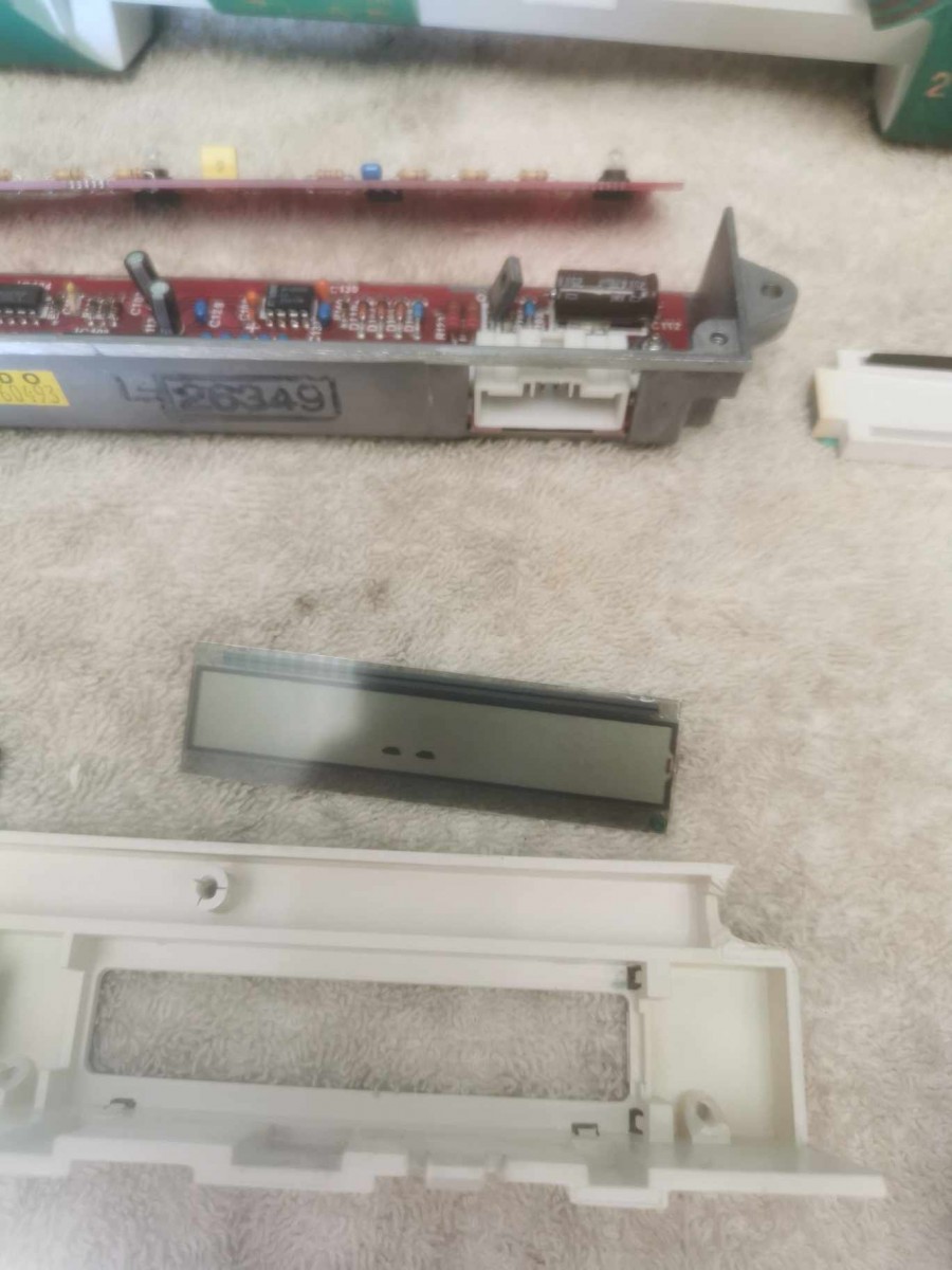

Pulled apart my cluster today to see what there was to it as 2 of my lcd are playing up. I saw is someone on fb or ebay i think was saying they fit new lcd to them so must be new lcd's out there.
Here is some pics of it opened up
