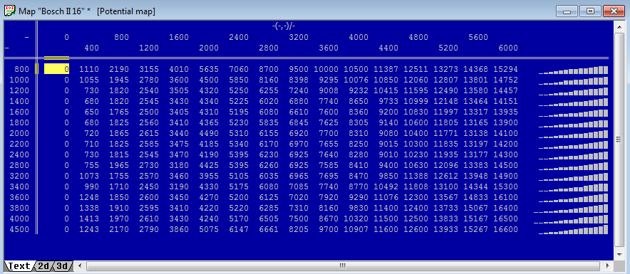

probably should have just posted this to be easier!
- Opel Injection map.png (186.96 KiB) Viewed 42044 times

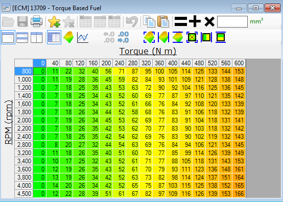

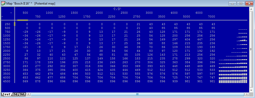

As a bit of a comparison I opened the 2.8L Colorado with HPtuners & had a binary file for the same model & was able to identify how they have the map setup for same ecu, but it looks like it's a bit more straight forward with just divide by 10... but I can't see the Opel ever getting close to 700Nm...haha
- Colorado Injection Map HPTuners.png (65.57 KiB) Viewed 42034 times
- Colorado Injection Map winOLS.png (38.4 KiB) Viewed 42034 times
- Opel Astra Injection Map winOLS.png (37.04 KiB) Viewed 42034 times
