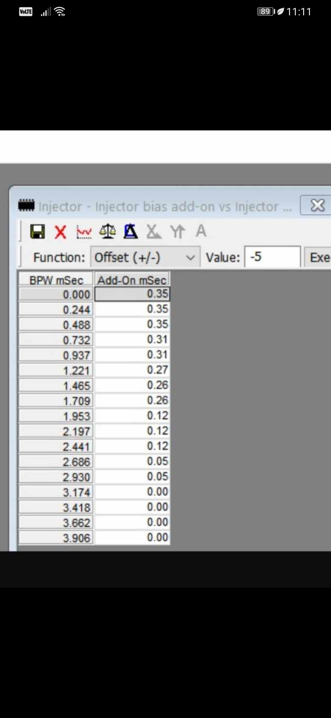

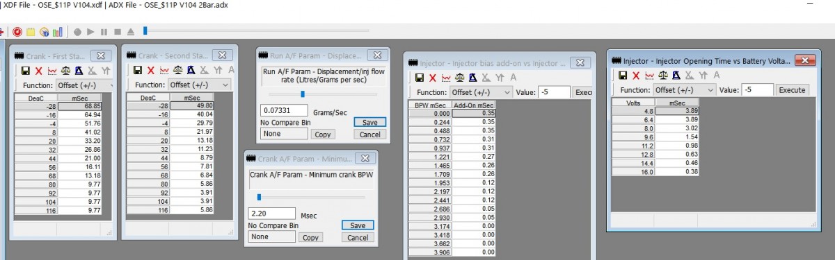

But will i edit these tables below. Also included pic of my current values / tables below
RUN A/F Parameter displacement injector flow grams per sec taking 66% off it so making it to 0.04838
Crank first and 2nd stages tables by 66% also.
Will crank A/F parameter min crank BPW need to be changed at all?

Injector Bias add on vs injector pulse width for non linear
and
Injector opening time VS battery voltage
Will these need to be altered at all.

They are not quite double the flow of l67 injectors so I think math is off, but for a start halve the injector flow & see what the starts are like from that & go from there… every injector has different characteristics!

Any idea what i should do about the
and the
Injector opening time VS battery voltage ?
and the

siemens deka 60lb? viewtopic.php?f=28&t=5548

Antus yeah siemens deka 60 but the shorty version. I checked the short and full length data online and is pretty much identical. So data from the deka 60 long should work with my deka 60 shortys

Yeah its just a different package, same specs. There are clones out there that have their issues, keep that in mind if these are unknown origin and you get unexpected results.

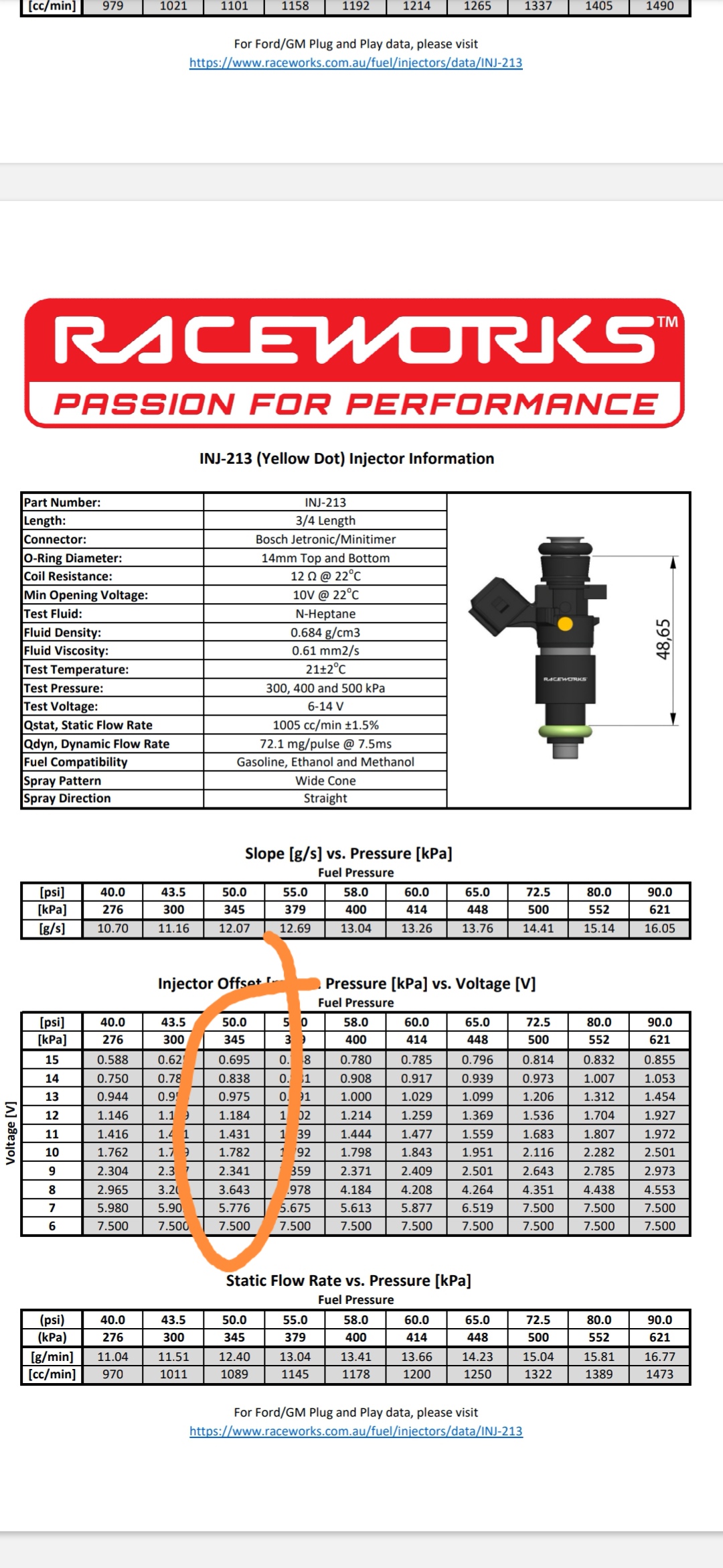

So ran the deka 60s on my friends injector machine and their were 2 lazy ones so i scrapped them and bought some brand new bosch 1000s.
The data sheet for my new injectors is below.
What data for the new injectors should i be putting in the
injector bias add on vs injector pulse width table?
Injector dead time data goes into the injector opening time vs battery voltage table yeah?

I cant answer your question directly, but there are some agreed values for deka 60 on the forums. I know there is some additional delay in the ecm on top of actual times on the injectors. So I'd get the Deka 60 factory data, and agreed working well data, and apply the same difference (not as a percentage, as its an offset) to the data you have above, and start there. If anyone has a better idea, use theirs

Fired up car today on 98 fuel with the bosch 1000s ran pretty good so drained tank and switched to e85 altered required tables fired up and ran not bad.
