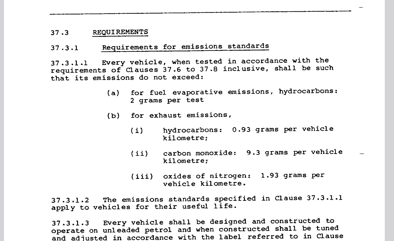

I found these.
The frame work for ADR37, not so much the specs but I eventually found them.
https://www.infrastructure.gov.au/sites ... les/37.pdf
I found these.

I have the ADR's on CD up till abt 10 years ago and the testing is very difficult for anyone without a big investment in the equipment. I'm surprised to read in that doc they mention emission testing (Lambda testing) vaguely for cars from 1972. That was ADR26 and there were no dyno testing done then. They only had a PCV system and a CO of no more than 4.5% @ idle. In that doc they mention closed loop testing. Cars didn't have that here till 1986 so theres a big gap in the doc relating to older cars.

Yeah, all that in the doc looks like the framework used in California from what I can tell. Aus never had anything close to be able to test like this for the public. Also, the ADR is meant for manufactures so this would have been used for vehicle development by the manufactures.
