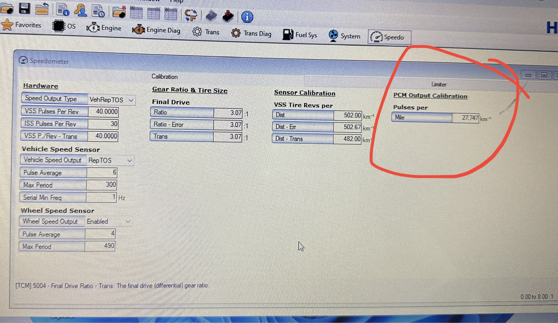

This may be a silly question, however I was wondering if it's possible to modify the no of pulses that the E38 sends out on X1-57?
I have fitted a VF ECU to a VZ the ECU details are

Now that I have set the diff and tyre ratio correctly in the ECU, the readout from the ECU seems spot on when measuring to a GPS device or driving along side another car comparing speeds but the cluster is saying 50km when doing 60km.
I have set the PPK in the cluster as low as it allows which is 3000, I did it with the Tech II and also tried out of curiosity to force a lower number into the eeprom directly but it doesn't seem to make a difference.
One thing I've noticed in HP Tuners is that on the VZ OS, there is an extra variable on the speedometer page that is not there on the VF OS called 'PCM Output Calibration' (photo attached).
I was trying to avoid introducing a pulse adjuster between the ECU and dash, but looks like it may be my only option.

your using a 6l80 too yeah?
if you read the trans/ecu out togethor it might not be showing u all the options for just the ecu.

yeah i meant seperate read from the controllers. hpt does some wierd shit were options disappear/get added when they are a combined read.
tends to happen in the speedo area since both the trans & ecu have similar table settings.
My experience with auto combo's is get the speedo working correctly/accurate in the auto, then you should be free to play/fudge the output pulse from the ecu. in efilive for instance i always log the vss pids for ecu/tcm. u can tweak the internal pcm calculations by adjusting tire size or ecm pulses per km.
basically 6l80 uses the diff ratio/tyre size-revs per km to work out the speed. ecu then picks this info up, then can manipulate it for internal calculations & or the output pulse.

so did some quick testing on the vz 6 speed conversion car. i keep both engine & trans to 478 pulses per km. in efilive thats H0105 (this is basically worked out diff gear/tyre size)
In scanner both ecu/tcm show same KPH. but dash needed adjusting, which is also done in the ecu, because it's putting out the pulses to the dash.
Again efilive it's H0101 - Vehicle Speed Sensor Pulses Per Km. set to 23152 & it matches close enough to the ecu/trans in scanner.
I'll have a quick look in the code, but i suspect that maybe GM removed the output pulse variable because everything was canbus by then. no real need to have a pulsed output.
