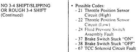

This is from the service manual as to what may be the causes of no 4th gear.

Thanks for that Chuff. Luckily in a way , most of the hydraulic items are much less likely now due to the currently not active fault ! Electrically much more so likely .
I looked over the log data again last night and I have a pretty strong feeling that there is a wiring/connection issue possibly at the trans connector or the ecu at this stage. Mostly due to the erroneous data from the engine tps data vs the trans tps data.
This would also fit in perhaps with a heavy foot throttle moment possibly influencing a wire/connection issue.
Anyway I'm going to look at that stuff next , I have a new tps sitting here to throw on at some stage, for 35 bucks why not , I also have a few items ordered for the internal of the trans including a manifold switch plate and the pair of shift solenoids and a boost valve repair kit in the .500 size which can only help a tired trans giving a slight line pressure increase over all.
But first thing I will look at is wiring and go from there . I'd love to find a repeatable fault item, repair that to be sure I have fixed something at least .
