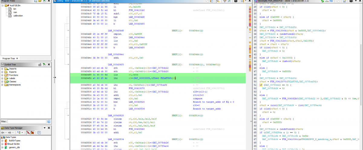

i have the following:
and FKLAFUGD is a label for the following address:
whats the point in calling lis r3,0x5d before calling a lhz command? i mean, wont the lhz just overwrite what the lis did?
from what ive learned:
lis r3,0x5d // this makes r3 = 0x5d0000
lhz r3, offset FKLAFUGD(r3) // this loads whatever is in FKLAFUGD's address (005d25dc), which is 38 f6 into a lhz r3 (which is 000038f6)

First line loads a pointer to r3
Second line adds offset to pinter to r3, and than data from that offset is stored to r3.
PPc code can use only 16 bit addressing and makes full address out of 2 commands

hey, thanks for the tip. i managed to read what is actually in the code by doing ctrl+shift+g. second line is r3,0x25dc(r3), which is r3=(r3+0x25dc). since r3 is previously defined as 0x5d, this now makes sense to me!kur4o wrote: Tue Apr 30, 2024 9:51 pm First line loads a pointer to r3
