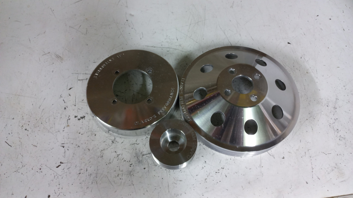

I have a full set of non ecotec 20% OD pulleys from Clarko's I no longer need if you are interested.

They should be fine.
I'll dig them out in the next few days and check em and take a pic for you.

There not too bad after sitting in a box for almost a decade. They would look really good with a buff on a wheel but this is with just a rag and polish.
The alternator pulley is brand new, never fitted.
On the VN I had charging issues as I never ran it long enough and it would sit unused between shifts at work so it needed a battery charger constantly.
