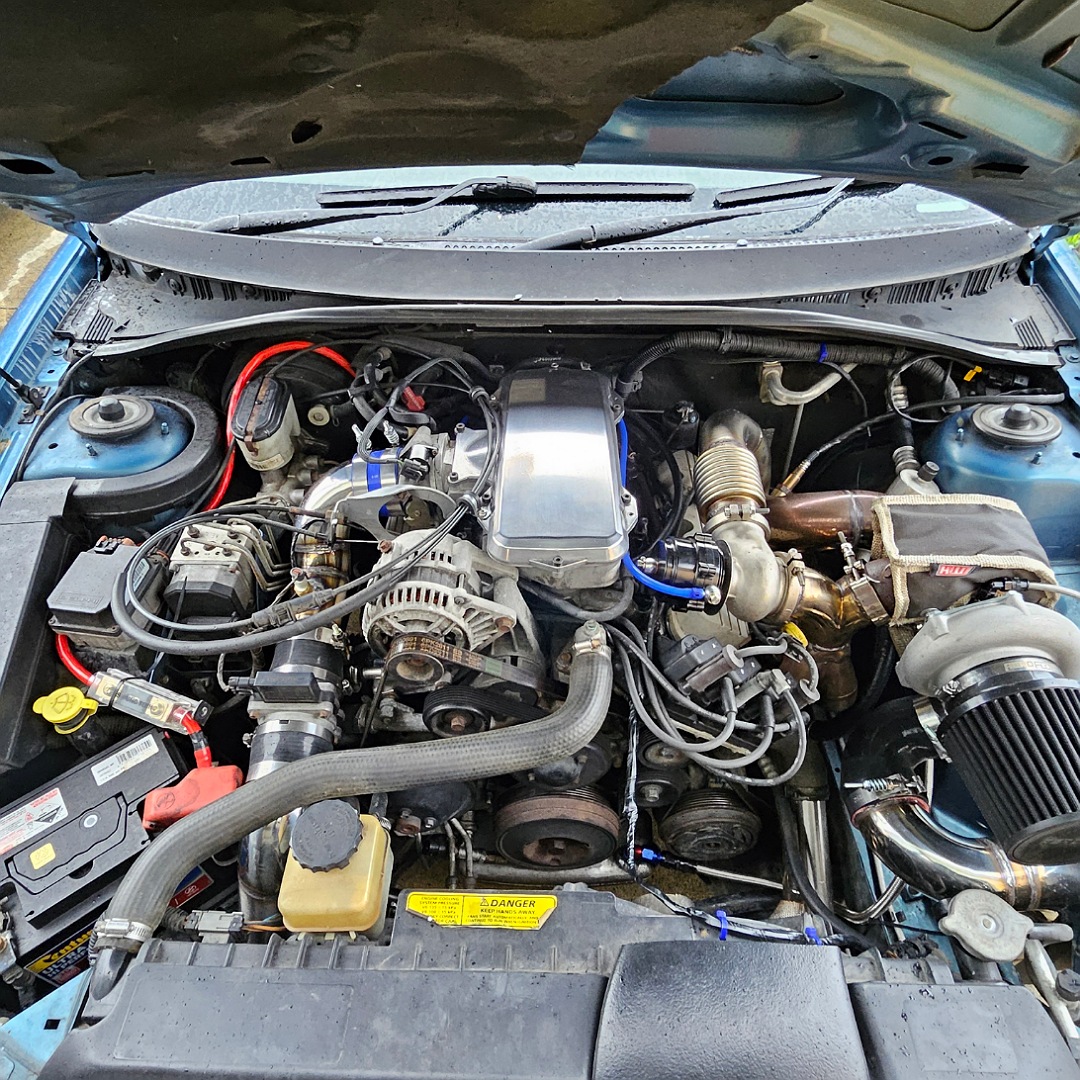

This thing has been my project for about 2 years daily driver and family cruiser for about 5 years.
Current setup is a Pulsar GTX3584RS Pulsar 60mm gate on my own manifolds with a low mount crossover pipe to try keep engine bay temps under control, 3.5" exhaust whole way to back. Currently running on the1's enhanced tweaked for 850cc injectors it runs great and seems happy on boost im fairly nice to it at moment.
It's still the original 450,000ks engine it breathes a little but not terribly so has a catch can to deal with that. I have a l67 long block to go in once this expires im learning at moment no one else has put there hands on it. Be cool if I can keep it that way, have done several Hpacadamy courses and have a line on a dyno I can hire time on.

So you're running the flash style pcm, I'm assuming so.. it can be time consuming flashing changes testing & flashing etc... nice work!

I've just picked up a VT PCM to fit an NVRAM to which I'll swap in once the l67 engine goes in. It's taken some tweaks and patience but I'm really happy with how it is now. Yes flash ecu life for now.VX L67 Getrag wrote: Wed Jun 19, 2024 11:11 am So you're running the flash style pcm, I'm assuming so.. it can be time consuming flashing changes testing & flashing etc... nice work!
