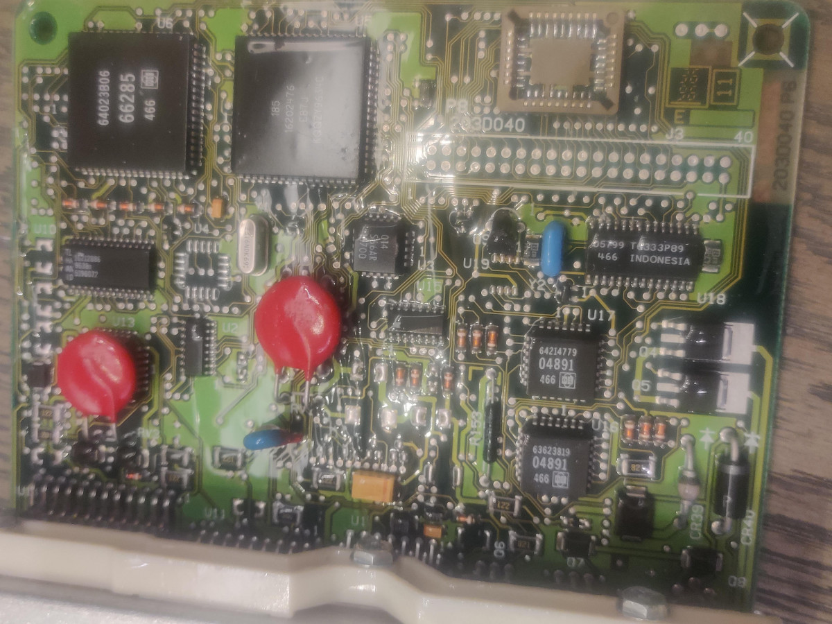

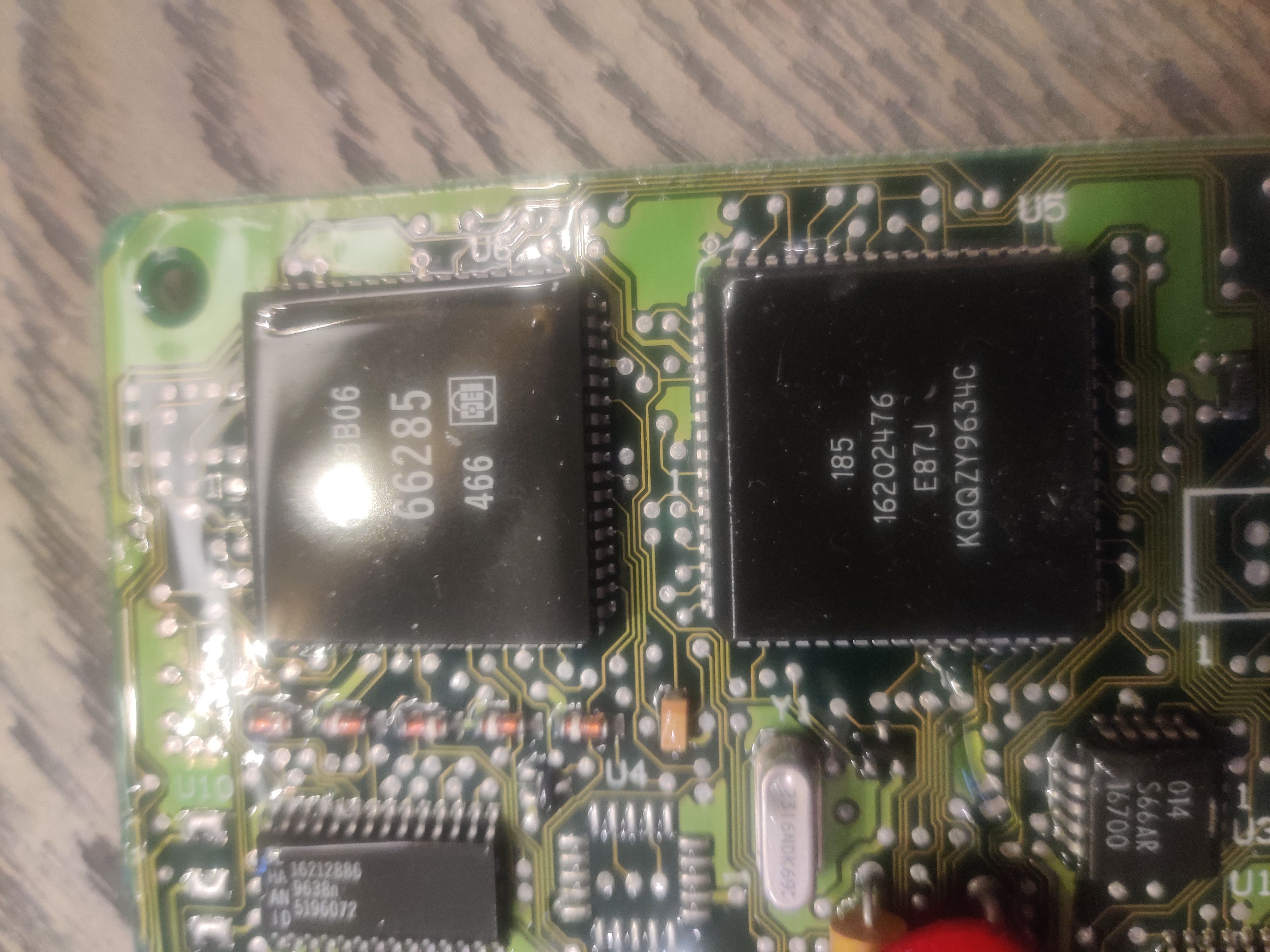

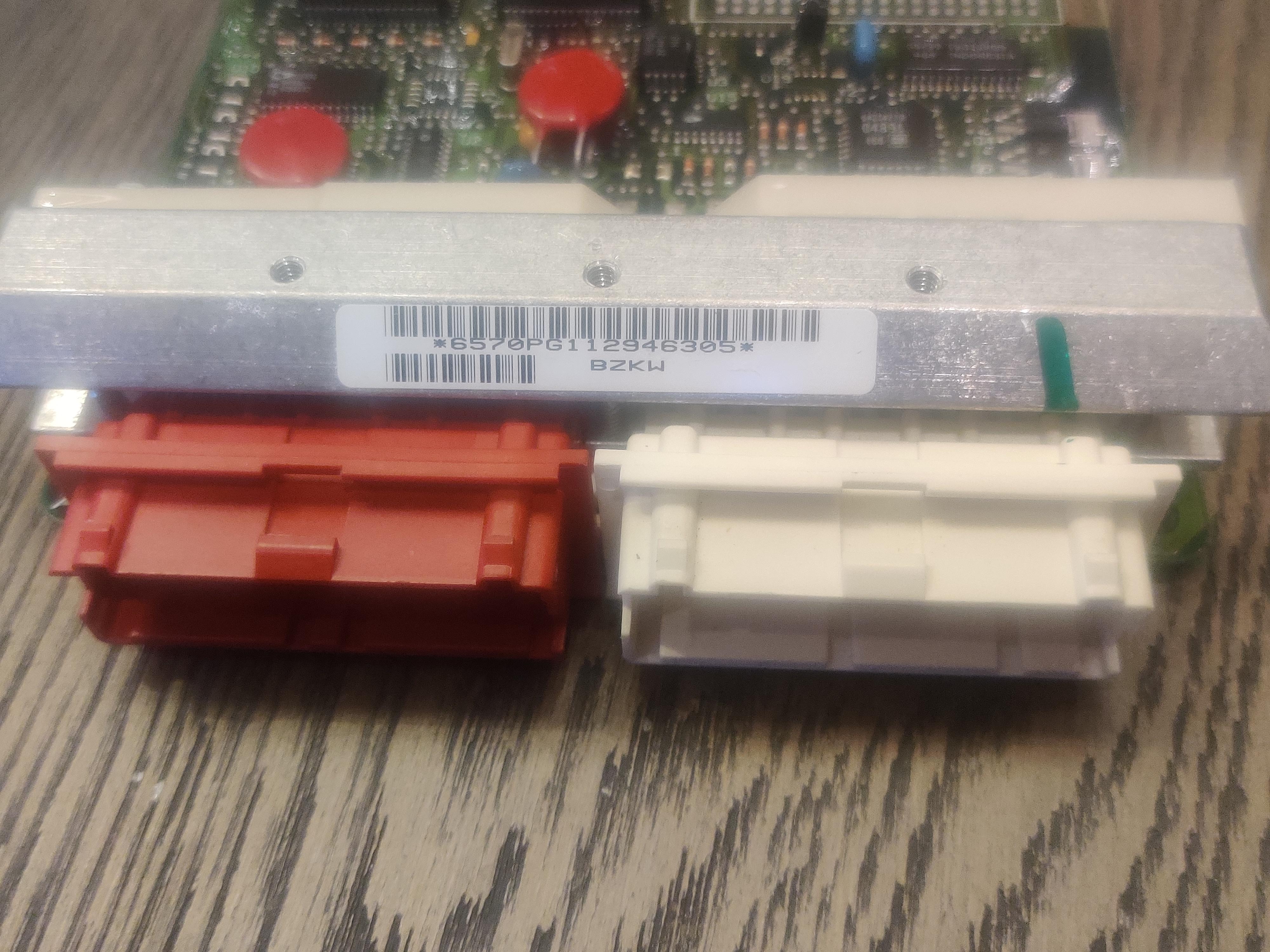

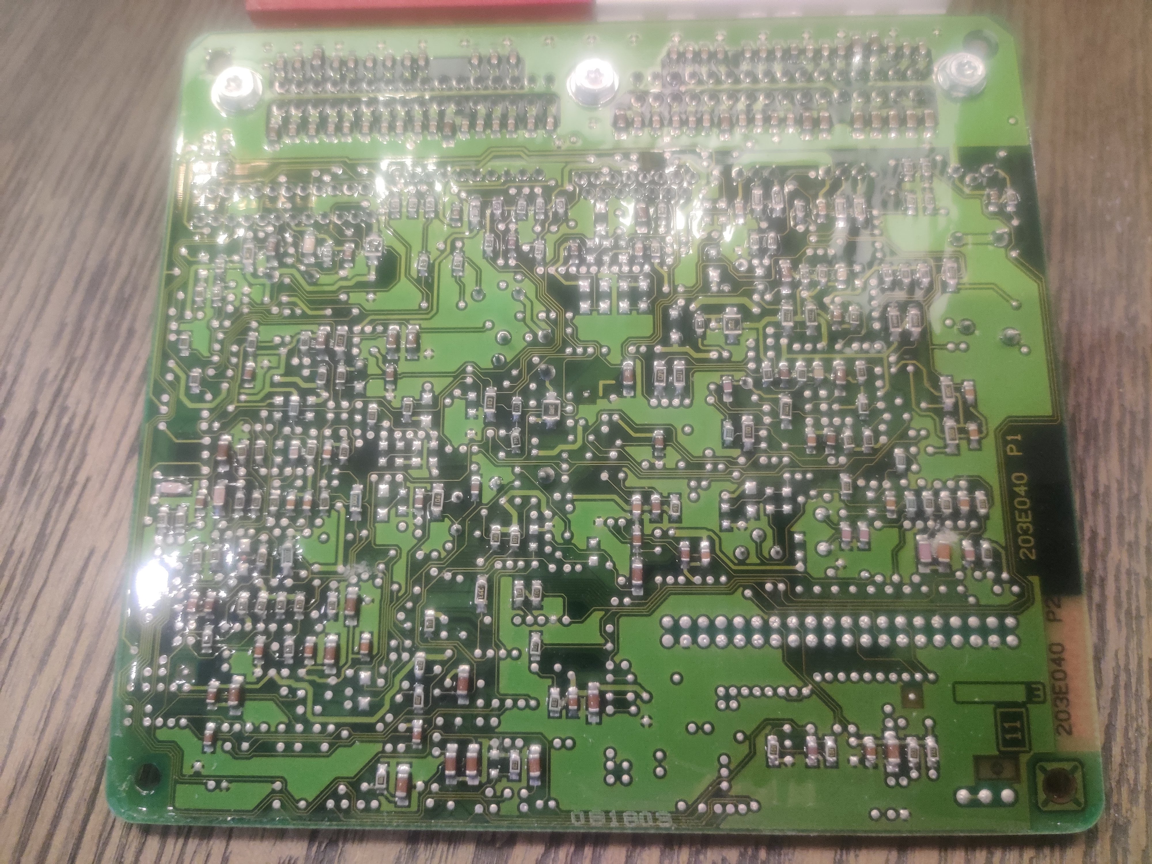

Regarding ignition, it is distributorless, wasted spark coils.
I post here some pictures.
As can be seen PLCC32 socket are fitted.
Regarding schematics I only have in paper format, but I will scan and post a copy.
I intend to try som emalator operations with Ostrich and try to figure out at least ignition, fueling and load map.
